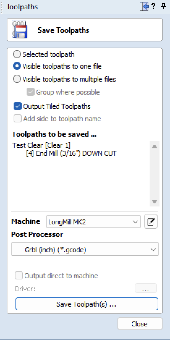

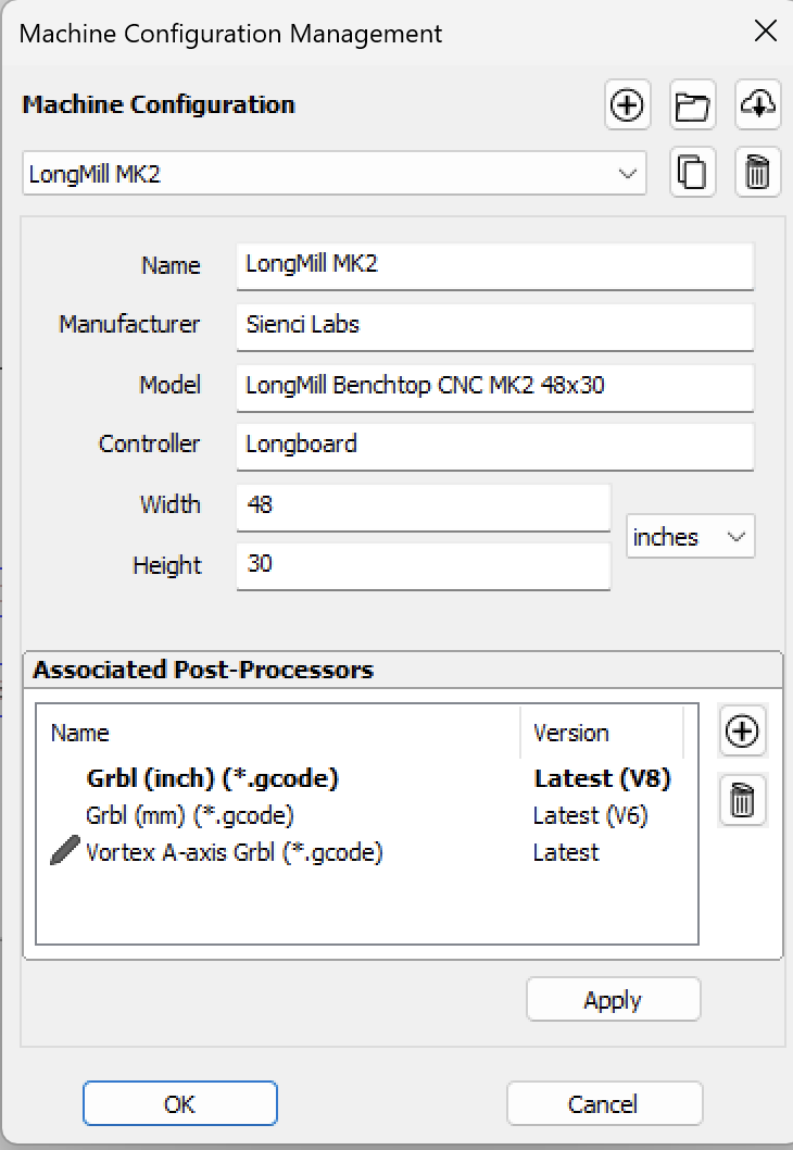

@JdotPo What post processor are you using in VCarve?
**Author:** ![JdotPo](https://forum.sienci.com/letter_avatar_proxy/v4/letter/j/5f8ce5/32.png) [@JdotPo](https://forum.sienci.com/u/JdotPo)\
**Post date:** [January 16, 2024, 8:37pm UTC](https://forum.sienci.com/t/invalid-g-code-id-33-in-gsender/10904/3 "2024-01-16T20:37:56Z")
Grbl (inch):

**Post date:** [January 17, 2024, 2:50am UTC](https://forum.sienci.com/t/invalid-g-code-id-33-in-gsender/10904/4 "2024-01-17T02:50:34Z")
This topic is a little out of my wheelhouse but I did do a little research to see what the error is. ‘The motion command has an invalid target.’ is the error. Searching that phrase led me to some articles that say that error can be caused by G2/G3 arc moves that have a rounding error due to the numerical precision used etc.
So knowing that a distance measured in mm will take less decimal places than the same distance measured in inches, I would try using the grbl mm post processor. I’m fairly certain that you can still design in inches with Vectric and save using the mm post processor. It’s easy to try anyway and maybe it will work.
The other thing I ran across that could cause this would be EMI causing problems with the USB connection. But if you test the code in gSender and the error/s are always there on the same line/s then it’s not EMI.
**Author:** ![NeilFerreri](https://forum.sienci.com/user_avatar/forum.sienci.com/neilferreri/32/1959_2.png) [@NeilFerreri](https://forum.sienci.com/u/NeilFerreri)\
**Post date:** [January 17, 2024, 5:31pm UTC](https://forum.sienci.com/t/invalid-g-code-id-33-in-gsender/10904/5 "2024-01-17T17:31:10Z")
Yup…use metric.
This is an arc calculation issue due, most likely, to rounding errors.
Basically, for that error to occur, the radius of the arc at the start and the radius of the arc at the end would have to differ by .005mm (AND be greater than 1% of the radius).
Here’s a [nerdy spreadsheet](https://docs.google.com/spreadsheets/d/1eGYLN24lHbjvskiT4WbuU8tfml_CwcPkEeAzGi2rjfw/edit?usp=sharing) I made a while ago when these errors were popping up for many on other forums. I just input your data, and looks like it’s just off.
If you post process in mm, this won’t happen.
If you REALLY want inches, try my post processor [here](https://github.com/neilferreri/V-Carve-PPs/tree/master/GRBL%20Toolchange).
