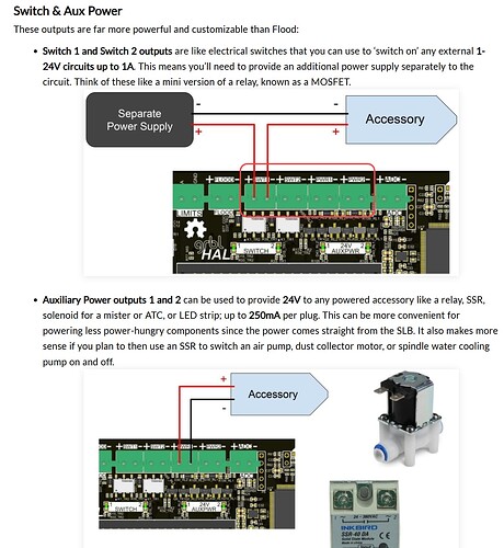

Chris T. @ Sienci reached out to me via e-mail and suggested I try using the SLB’s ‘Aux PWD 2’ to trigger the relay as a test. It’s 24v but the iOT supports that. That resolved my problem so that’s where I left it.
The following is from the SLB’s technical manual and it explains how to use those ports. By default they are configured to turn on and off with M8 & M9 but you can change that if you want.
During my troubleshooting I discovered that the issue didn’t happen initially, but then did happen sooner in my carves once the SLB and vacume had been running for a while. I also found that if I didn’t have the iOT trigger cable connected to the FLOOD port, the port and it’s corresponding light never turned off. It kind of looks like that there might be some overcurrent/ overheating issue.
I also found an older Sienci forum post that reported the same sort of thing. My SLB is one of the original ones.
