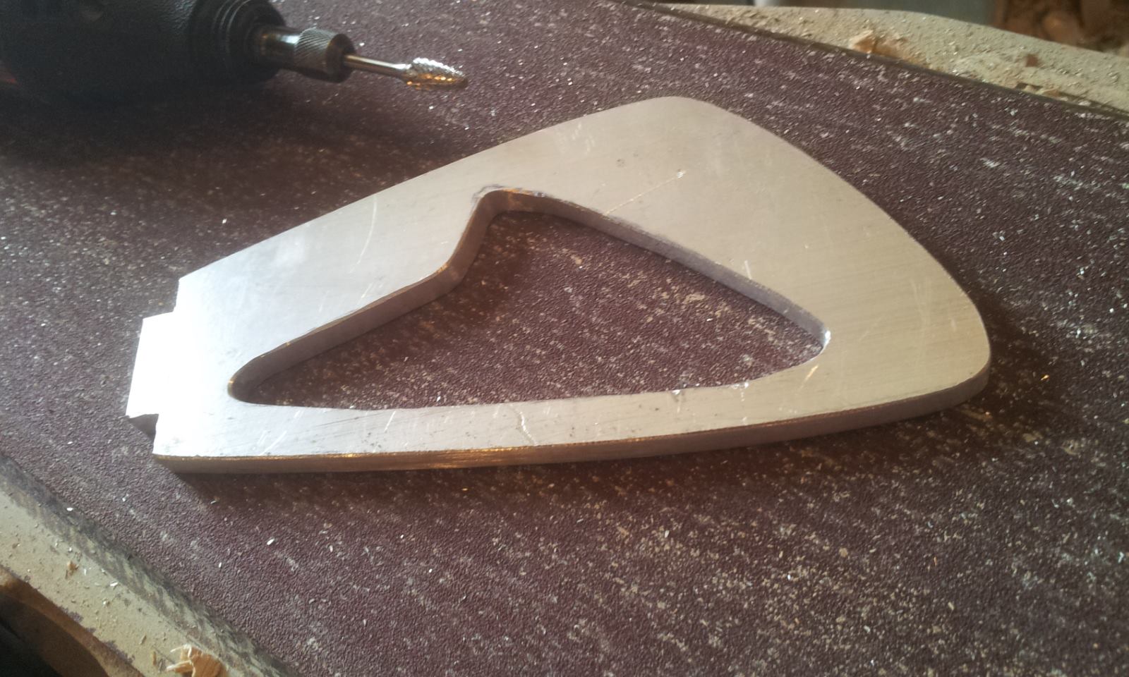

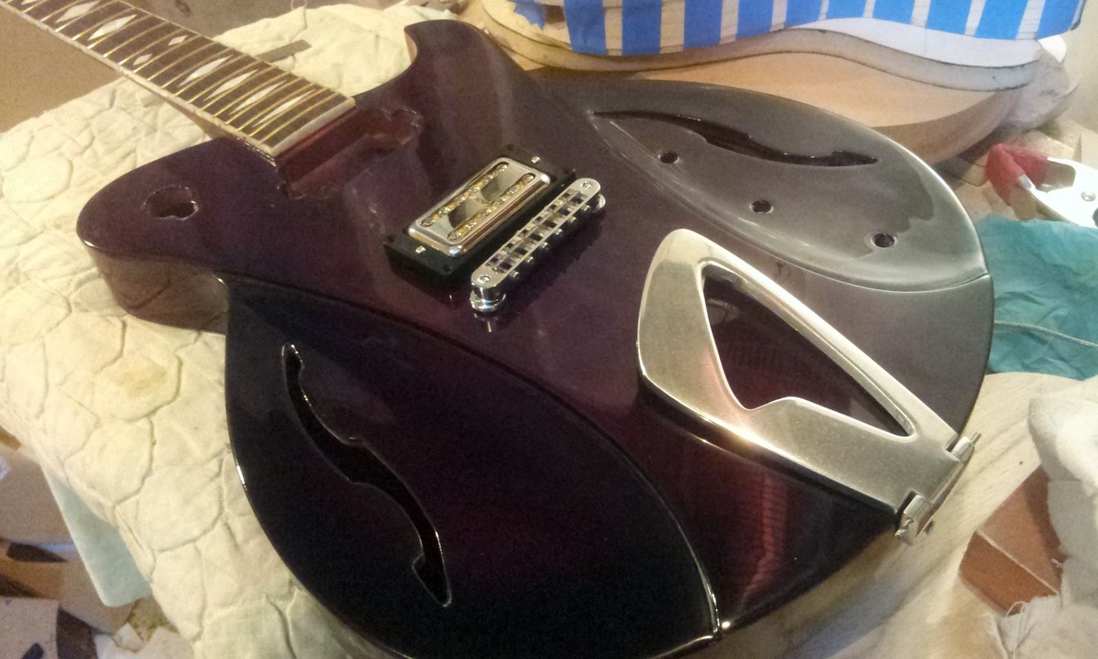

I did this tailpiece by hand. I have the Mark 1. It’s 1/4" alum. can the cnc handle it. What sort of bits and speeds should I expect?
I did 1/4" aluminum on my Altmill with a Makita router this morning without any big problems. 1/8" single flute flat end mill. Not sure about the feed rate. I just used what vCarve provided when I selected aluminum in the tool selection. For the router speed, I believe it was setting #3 on the dial (16000 rpm if I remember correctly) as per the feed and speed chart on the Sienci web site.
I had a higher speed initially and got some galling. I then used a cutting oil until I realised it was dissolving the adhesive on the double sided tape used to hold down the aluminum. I then reduced the speed and had no more problems.

Thank you for sharing your experience. Sounds like speed can be lower.
Thanks Michael,
Sounds like Im good to go with my next tailpiece.
