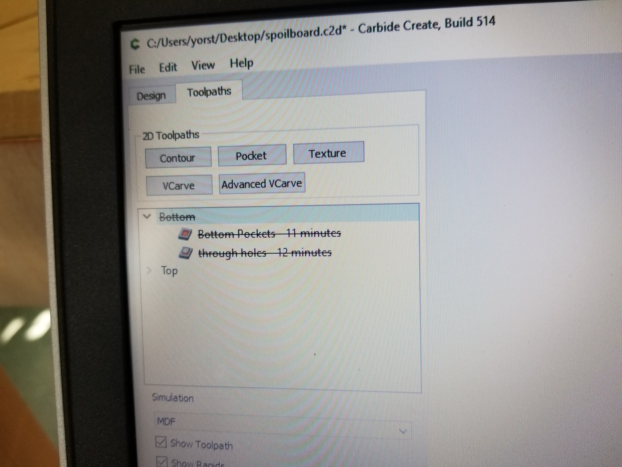

From carbide create I generate the g code, first bad sign is toolpath in Carbide have a strike through each task, Why or should I do something, missed some thing, will the g code not work.

So my guess is this. The HOLD is normal. Carbide create generates tool change commands in the exported gcode. You can configure UGS to ignore, or just do what I do, and hit run a second time.
As far as the zero, in the file you created you will see the origin point. If using carbide create, you can click the settings gear and tell it where the origin is.
I believe UGS will show the origin when you load the file as well. I think it displays the machine at the origin. You will need to know where the origin is and set the machine to that prior to running the gcode. I generally pick top of material lower left of the project, which is the left of the machine closest to you.
The origin is relative to the project.
Hope that helps a bit!

Here is what happened when pressed play twice: first is screenshot of what I mentioned about strike through, second so thankful the machine did something.
 ![20201228_141540](https://forum.sienci.com/uploads/default/original/2X/4/4125e5a26afd9173241290300104c9e2b4383096.jpeg)
 ![20201228_141557](https://forum.sienci.com/uploads/default/original/2X/1/1c7df871c378852c82c70fca0a99041ed0e9617b.jpeg)
Not exactly what I was hoping for but progress
**Author:** ![Bill](https://forum.sienci.com/user_avatar/forum.sienci.com/bill/32/6026_2.png) [@Bill](https://forum.sienci.com/u/Bill)\
**Post date:** [December 28, 2020, 10:50pm UTC](https://forum.sienci.com/t/issues-with-workflow/2143/4 "2020-12-28T22:50:43Z")
Finished first job, didn’t know about
 ![20201228_154554](https://forum.sienci.com/uploads/default/original/2X/2/27e1218de589b1134a076f6e02c9ed5e94846056.jpeg) right click enable
