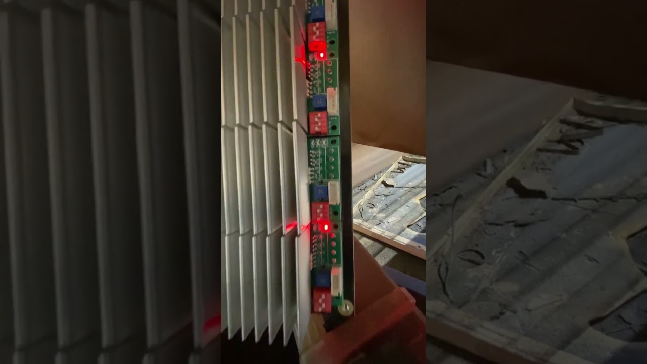

As you can see in the video, I have a plasma cutter on the Longmill. I have been using it for a while. I ran 1 - 17X26 in steel plate last night. Ran fine. I went in the house to grab a bite, came back out to run another. The right servo would not turn.
The only thing I did different on the last 17X26 plate was. I had the positive work clamp around the back of the Longmill. It was close the control cable for the right servo.
It might have pick up some inductive voltage and killed that port on the arduino. I wounder If I change pins on the Arduino if that would work. The I would have to change pins in the Arduino sketch.

@jmaree Have you tried swapping the Y1 & Y2 cables at the controller? I would give that a try and see if the problem switches to the other motor. And like @Fancu12 said the motor drivers are soldered in. I was have X Axis issues and replaced the controller and all is well, Make sure to power down the controller, I disconnect the power cable when ever messing with the cables. Doubt it would have anything to do with your warranty, to really double check the Dip Switches it is easier to get the cover off the controller, while there I would reset and cycle the Dip for the Y Axis motors.

Yea that was the first thing I did. Sent in a ticket. They want me to go ahead and open the controller to look for a blown cap. And bump up the amps to the one driver I have them piggy backed on to stop the hum. I guess I can run both steppers on the one driver for now. I think I will build my own controller so I can add a Torch Height Controller to measure the voltage from the tip of the torch so the plasma torch will follow the metal as it bends due to the heat based on the voltage read out.

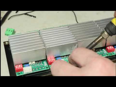

After opening the Longboard, I see that this is just a big breakout board for the Arduino to connect to the very cheap TB6600 drivers. It will be easy enough to remove and replace the drivers. I just hope if the problem is a bad trace on the board, I can find it and jump the bad section. Then I would not have to replace a driver.

I reached out to Sienci Labs and they confirmed that the driver is dead. So I removed the bad stepper and ordered a new TB6600 stepper driver from Amazon. I will install the new driver in the next video and test in on the Longmill.
Update #3 - Fixed the controller

If I had the time, and the headers, I would loved to have the drivers plug in with headers pins. I ordered another control board, but it will not be here till Monday. Got to get this thing working again. Got stuff to make. LOL
So now that I have fixed this one for under $14.00, I still have a new one coming. Maybe I will try to put one on my MPCNC. I don’t like running Marlin on a CNC. Marlin is fine for my 3D printers. But I want GRBL on my CNCs
