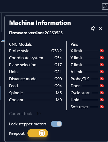

trying to set up Laser offset for my OPT Laser. When i visit config Spindle/Laser I do not find the offset selection. Has it been moved or deleted? I updated to 1.62 and still do not find. Need guidance

What board/firmware are you using?
For grbl/grblHAL devices running sienciHAL, it should be appearing in the laser subsection of the Spindle section when connected.
 ![image](https://forum.sienci.com/uploads/default/original/2X/a/a711a7e4aa7e03da3bec1f4193b09334d1af92cb.png)
For grblHAL and specifically SLB-EXT devices running **20260318** , it was not compiled in. This should be fixed in a an upcoming firmware release, where it’s again available as $770/$771 in the same section/subsection
 ![image](https://forum.sienci.com/uploads/default/original/2X/2/23ad8495298cad059347827d32eb2ccbc2e5d51e.png)
You can can check what firmware version you’re on using the machine information flyout in the top bar:
 ![image](https://forum.sienci.com/uploads/default/original/2X/4/4be3c8abd44aaf0741e906800bb47c71b69386ee.png)

Yes, my firmware is 20260318. I will await the new firmware to set up laser offset.

It should be available now on the Firmware and Flashing resources page - version 20260525 has offsets compiled back in as $770/$771
