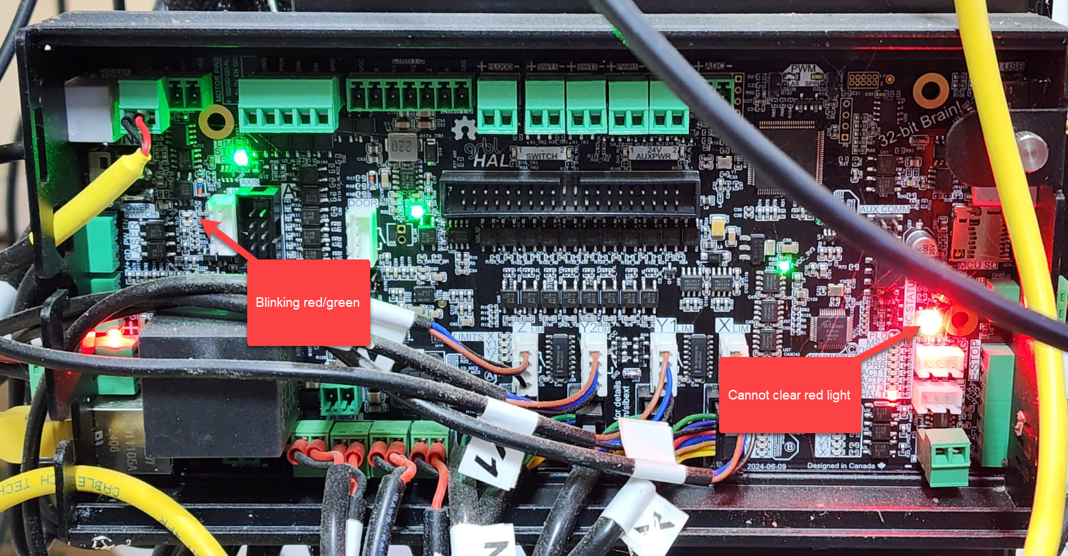

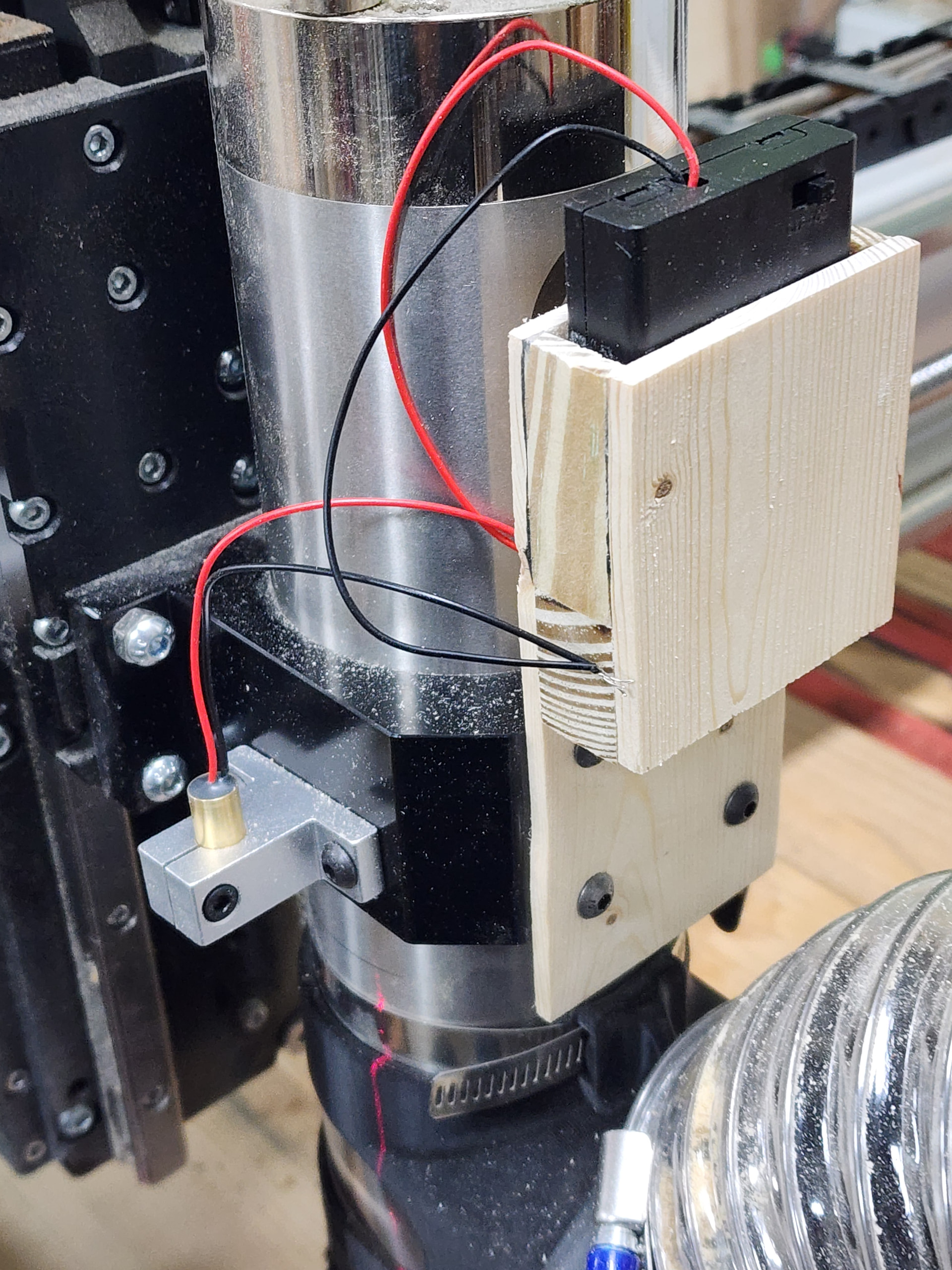

**Author:** ![Jgt1942](https://forum.sienci.com/letter_avatar_proxy/v4/letter/j/f19dbf/32.png) [@Jgt1942](https://forum.sienci.com/u/Jgt1942)\
**Post date:** [February 7, 2026, 8:50pm UTC](https://forum.sienci.com/t/laser-pointer-with-cross-hairs-for-setting-xy-zero/6722/18 "2026-02-07T20:50:28Z")
@gwilki Sorry to be soooo slow but I’ve gone down numerous rabbit holes, all of which took a LONG time. I’m in the process of mounting the crosshair light bracket. I noticed that as I adjusted the Z height the X line was moving about 4mm max. I had the bit touching the wood and then raised it to the max position.
 ![Crosshair Mounted-02 20260206](https://forum.sienci.com/uploads/default/original/2X/4/4057723de457980187a1e241455c8070124c1978.jpeg)
When I rasied to the Z-max, gSender issued a lock, and the SLB had one solid red light (bottom right area) and one light blinking red/green (upper left area).
 ![Lock light ahfter rasing Z to max](https://forum.sienci.com/uploads/default/original/2X/5/5f88e23c64c46f87da72c9dc515ccee9bb91423e.jpeg)
At this time, I cannot clear the solid red light. Until the light is cleared, I cannot proceed. I’ve tried resetting the Red Emergency button. Normally, this will clear the lock. In gSender I’ve clicked on the red error message numerous times.
I have some other gSender issues and will create a new thread.
**Post date:** [February 7, 2026, 9:45pm UTC](https://forum.sienci.com/t/laser-pointer-with-cross-hairs-for-setting-xy-zero/6722/19 "2026-02-07T21:45:29Z")
@Jgt1942 No need to apologize for the delay, John. Life has a habit of interfering with our fun from time to time.
WRT to the laser moving in X, it can be caused by two things. One is that your gantry is actually not moving perpendicular to the table top. Unlikely, but possible. The other is that you laser pointed is not perfectly perpendicular to the table top. If it is not, as you move up and down, the cross hairs will move in X and/or Y.
As to the controller issues, I have no reply. If I were you, I would power cycle the controller.
