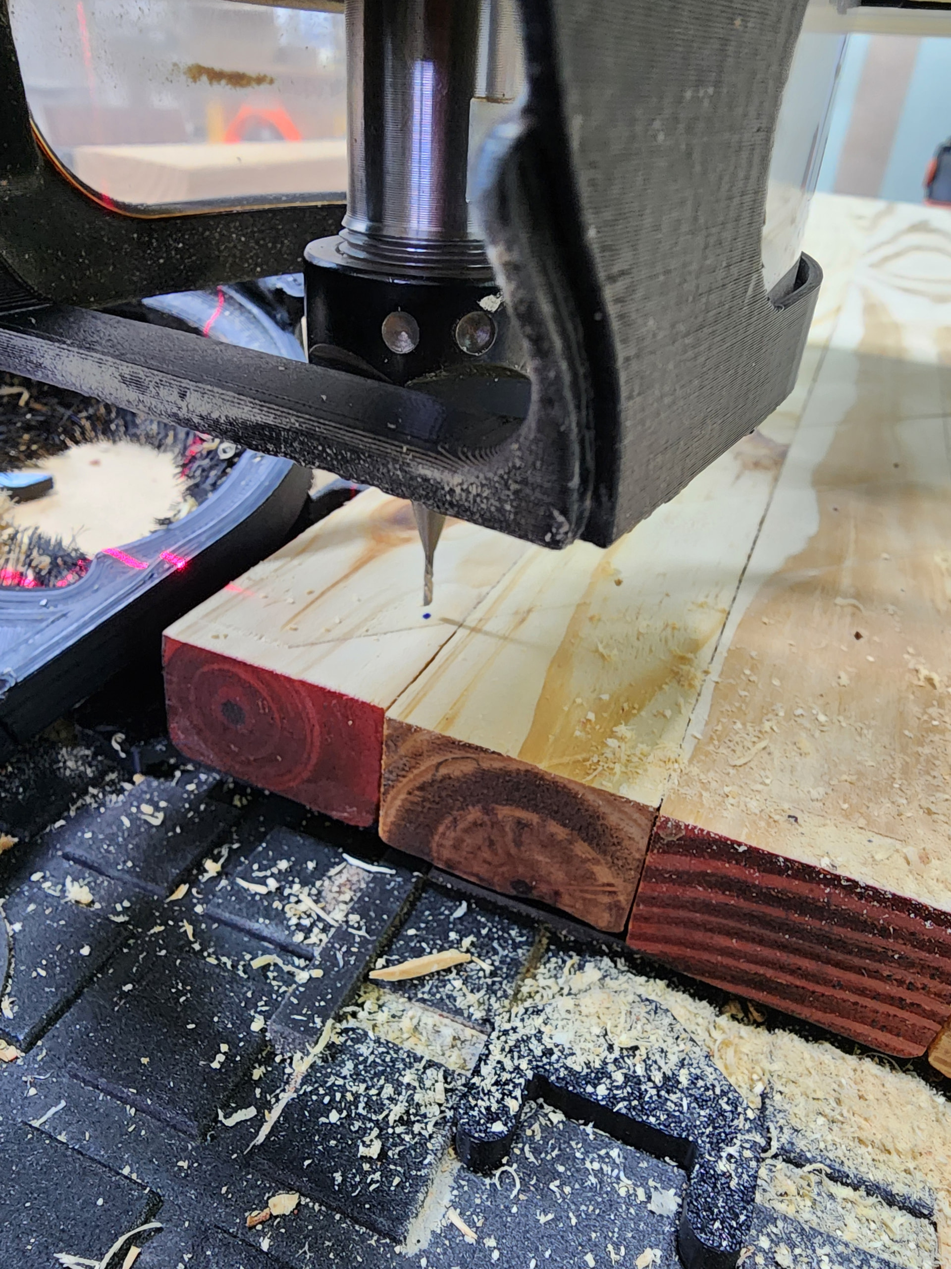

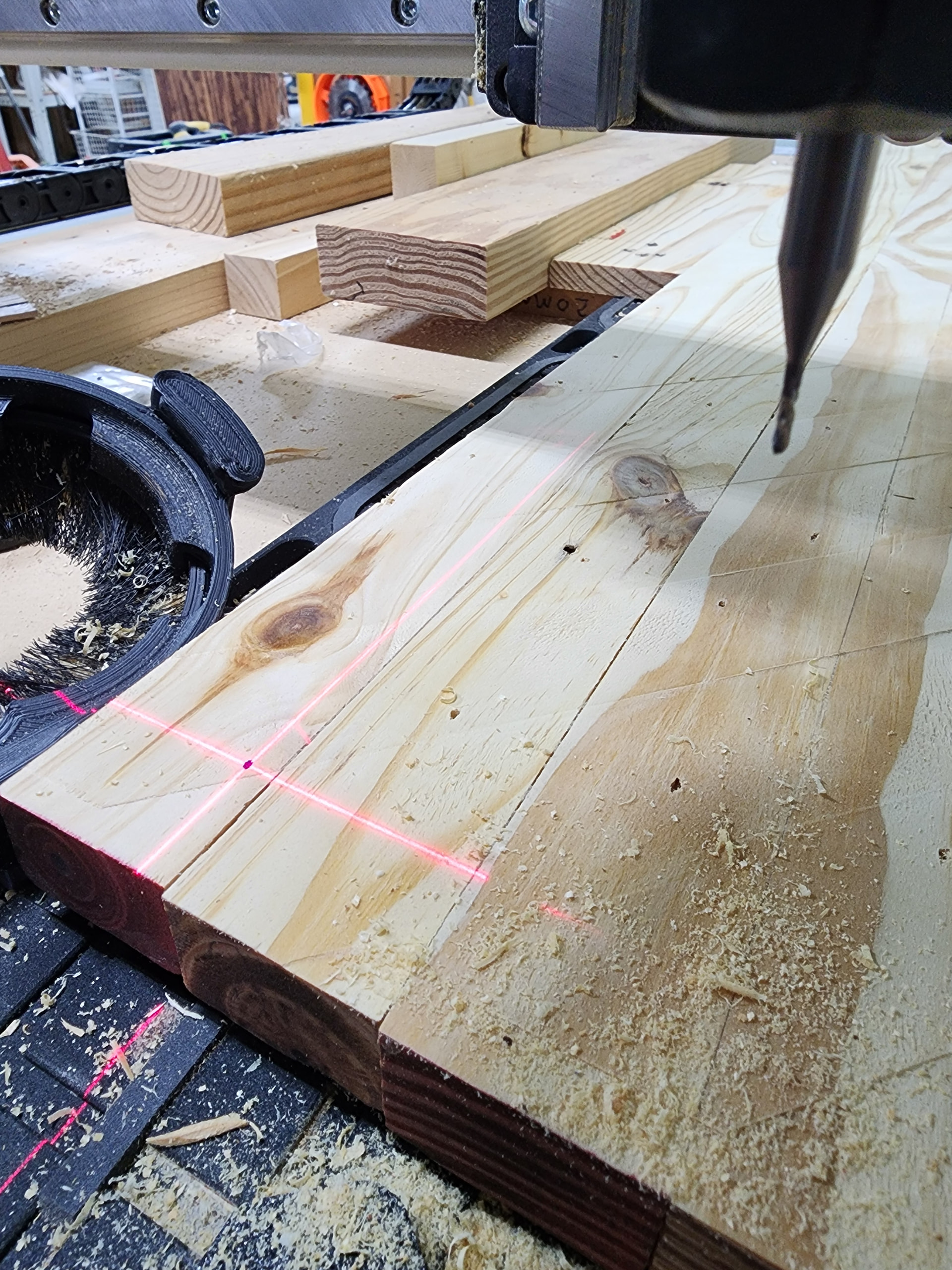

@gwilki @Jens OK I have no idea what I did to unlock in gSender, but it is now unlocked. My son helped me adjust the XY mounting laser bracket. Now, when I raise/lower the spindle for the Z axis the center of the laser cursor stays fixed on the reference dot on the board.
I then set the XY values in gSender to zero and lowered the bit (I used a 0.015 Rad x 10 degree tapered ballnose endmill, but you could use any similar sharp pointed bit) until it made a mark on the board.
I then rasied the bit so it was just a couple of MM above the board and moved the laser crosshair to the mark I created in the previous step. Now the X & Y values are X = 70.73, and Y = 6.97 (both are positive).
@Jens it is critical that you can move the Z +/- and the crosshair remains on the dot, otherwise the bit will not be cutting in the desired locations.
@gwilki After you create the macro(?) with the correct values, I can then implement the macro. I don’t know the how at this time.
I positioned the XY lines of the crosshair line so they were aligned with the XY lines of the spoilboard. This gives me a good reference point to ensure the XY lines of my project are in correct alignment. This is not necessary, but it gives me more comfort.

@Jens Since I centre in the middle of the material most of the time, the cross hair laser makes things much simpler. I mark the centre of the material, jog until the cross hair is precisely on that mark, then run a macro using a keystroke shortcut to move the machine in X and Y the offset amount. For me, with old eyes, it is much simpler and more accurate than trying to eyeball the centre of a 1/4" endmill for example to be precisely centered on the mark. Each to his own.

Yes, old eyes make things difficult. I would never try to set zero with a 1/4" endmill - I seem to be incapable of getting an accurate result. I use something small and pointed.

We have SUCCESS! As you stated, it was very easy. It took me more time to determine what I wanted to do than actually do it. For now, I just created a macro.
In the following image, I turned the laser crosshair on and positioned it on a random spot on the project board. I then marked the board, the dot on the crosshair.

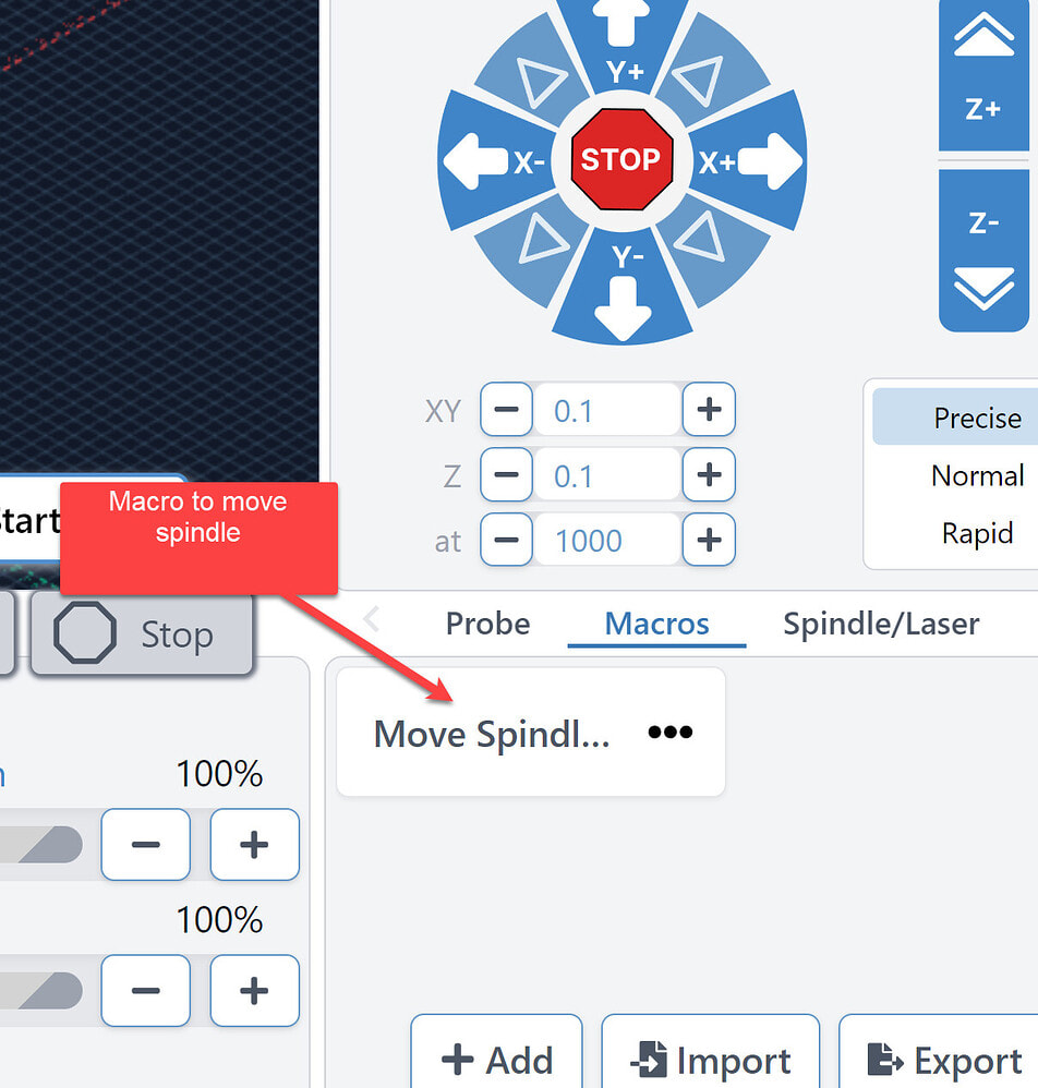

I then ran the macro, and like magic, the bit moved to the dot! YAY!!!

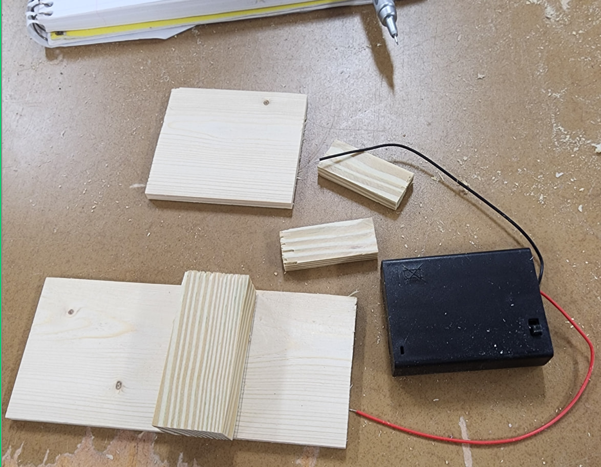

Here’s a bit more on the crosshair laser light. Following is an image of the holder parts. Other than the width of the back I did not pre-measure much.

Here is an image as it is installed.

With the macro it is very easy to use. I do have the AutoZero touch plate but this gives me the option to establish XY zero position with accuracy when the project shape is unusable. Also, I did a big no-no when setting the XYZ zero reference on a project and left the magnet attached to the spindle after setting zero XYZ. Until I get a new cable I cannot use the AutoZero touch plate.
