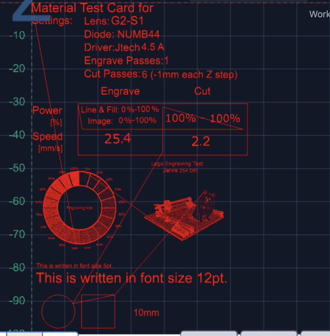

Not sure if I’m missing something - I updated my gSender (had not done it in quite a while) and the visualization when running a laser job seems to be a “blob” again (no indication of laser on/off, so all movements show solid colour).
I know the very old versions of gSender did that, and some time along the way that got fixed. Has it reverted, or is there some setting I’m missing?
UPDATE: Works as expected in 1.5.7, but not in Edge 1.6.0
**Post date:** [February 15, 2026, 5:11pm UTC](https://forum.sienci.com/t/laser-visualization-in-latest-edge/25723/2 "2026-02-15T17:11:36Z")
Thanks, we’re aware and it’s fixed for Edge-4. It’ll also be a bit improved over the 1.5.x implementation with some other visualizer improvements and parsing updates.

Edge-4 is publicly available - let us know if you still see issues after enabling laser mode but a quick sanity check has it working as before (with clearer visualization)
