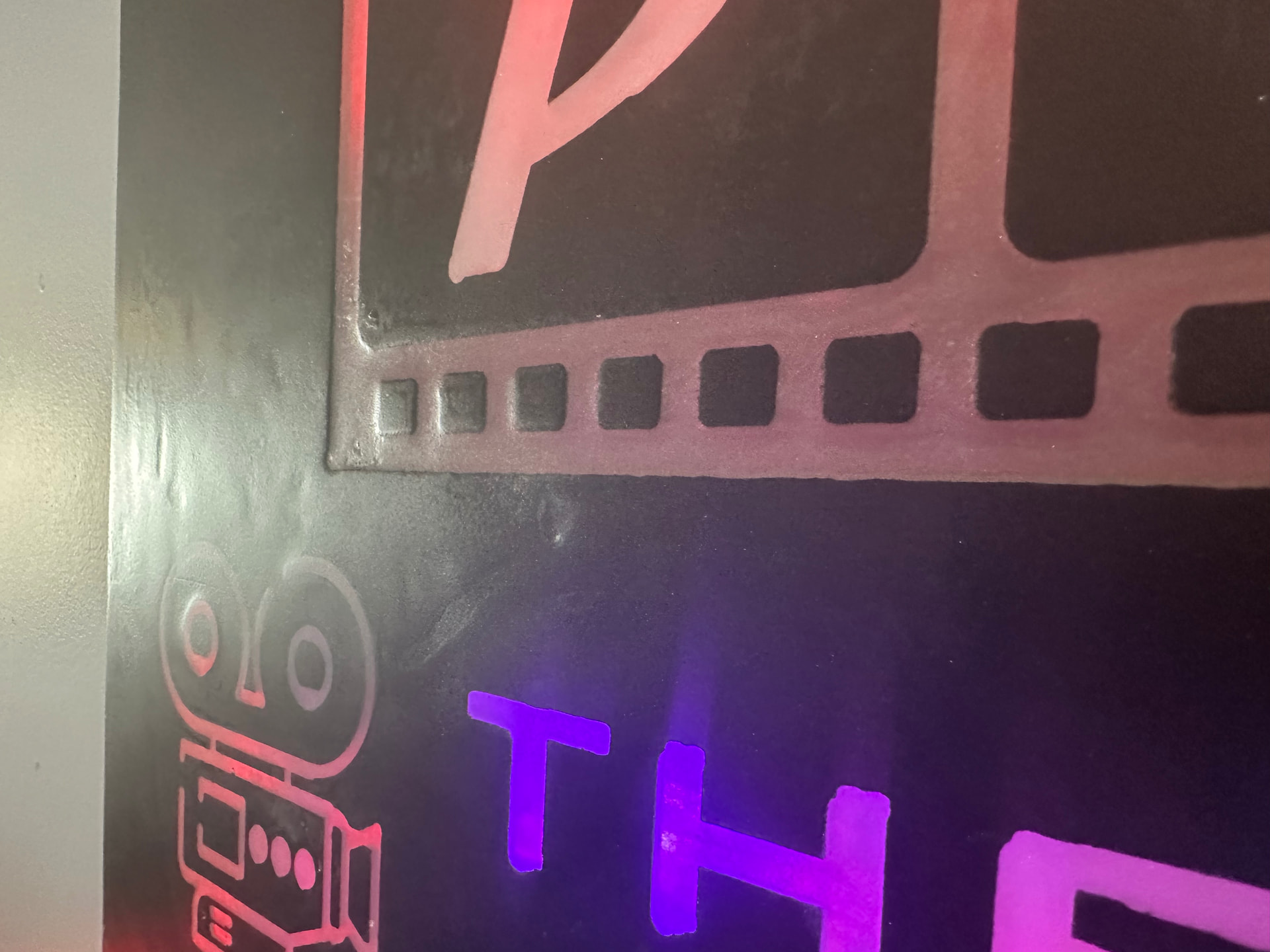

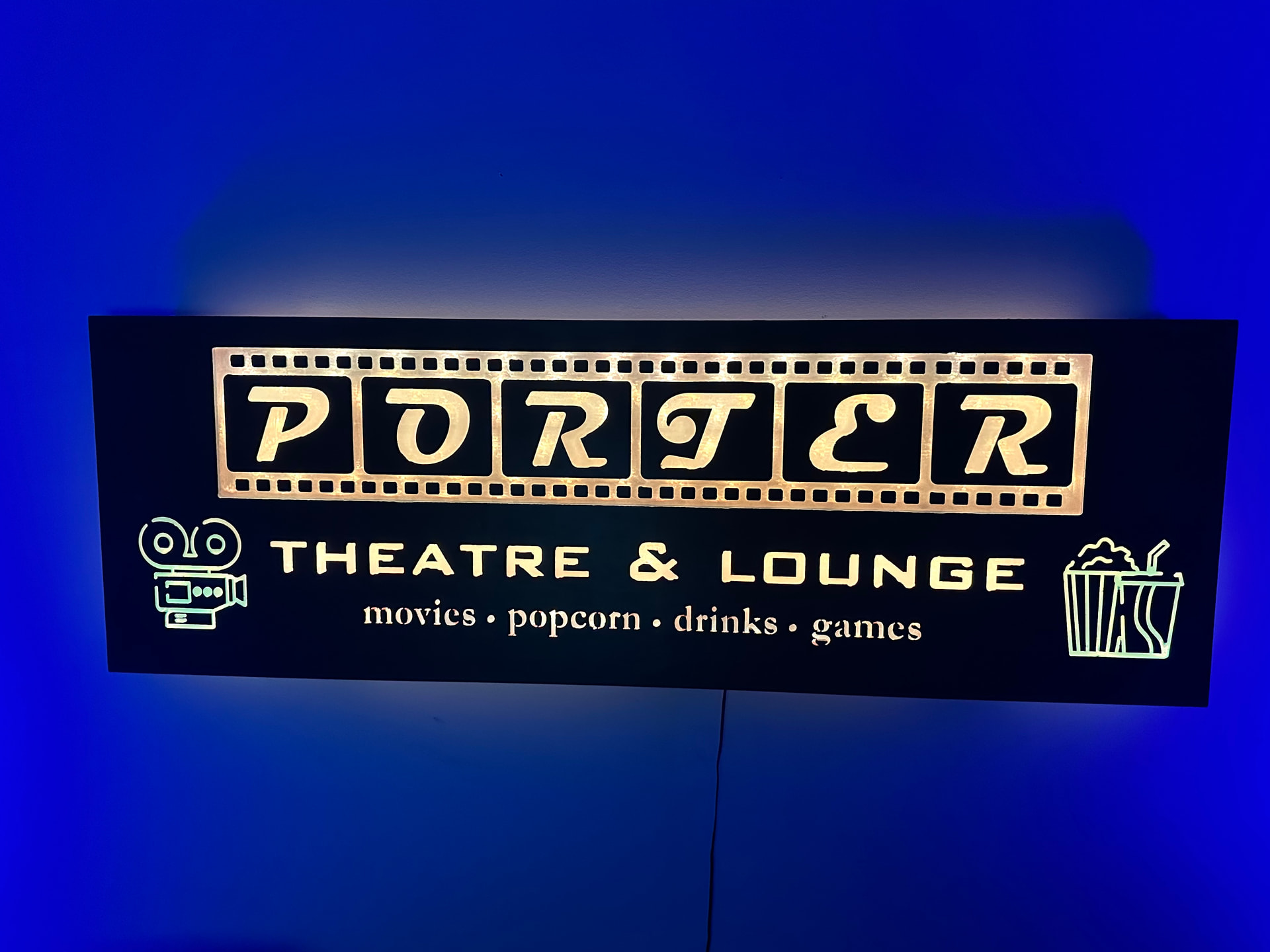

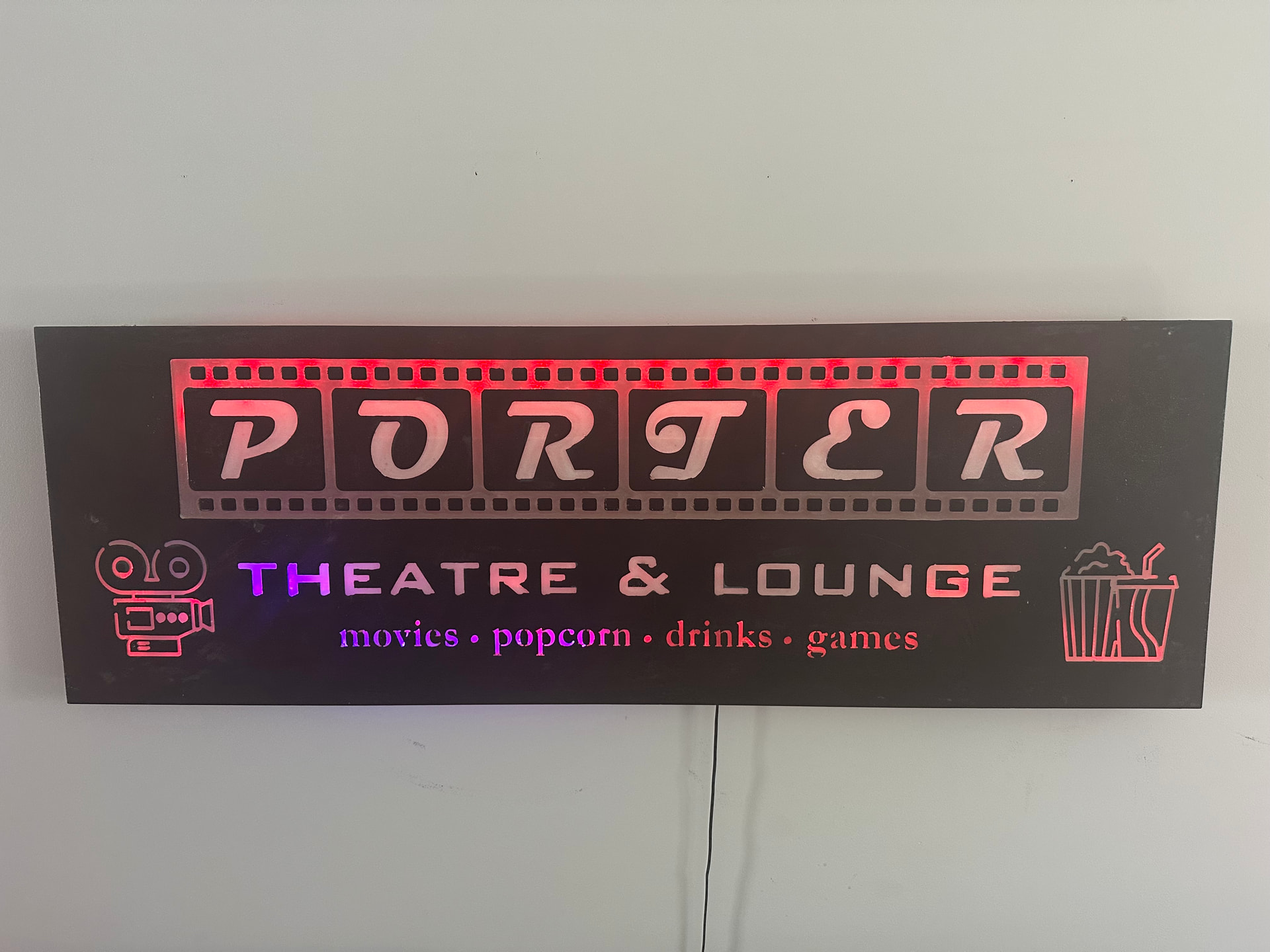

Plenty of mistakes were made. But this is for my son and he still uses the floor for a trash can, so it is acceptable enough.
Originally was planning to do wood stain after epoxy but wife insisted on painted black. That posed some hurdles and ended up doing a clear flood coat to smooth out the epoxy pours and cover some spillage.
Didnt like the glossy finish so sanded with 350 and sprayed with poly satin. Looks like garbage.
Something happened with the zero-ing during carve and didnt notice until it was too late.
And the dang led tap is fragile. Broke two strips and thought I had it on the third. Something tore again. So hard to fold these cheap leds without tearing.
Lessons learned. As always.

Sure. Wood was .75”. I pocketed all the letters and images down .3”, poured the epoxy, next day flipped it over and pocketed .5” to expose the epoxy in a the back.
If I do it again, I would have used .5” mdf to reduce the pocketing depths. And would be more careful with the cheap LED tape that breaks easy!
