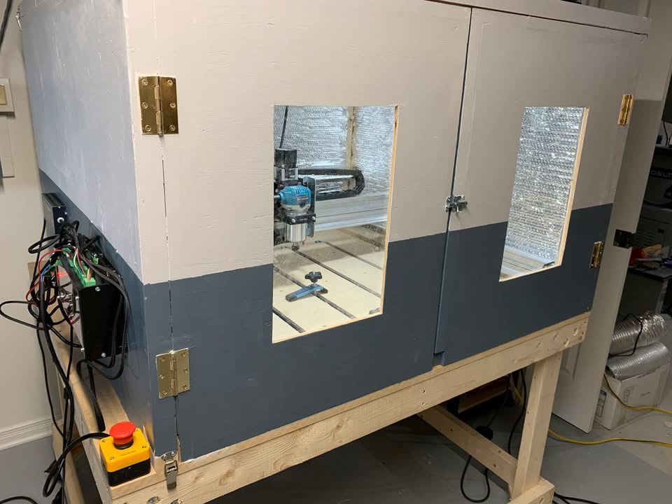

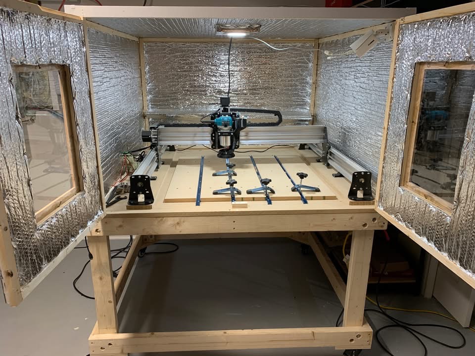

### Author: ![mbelleri](https://forum.sienci.com/letter_avatar_proxy/v4/letter/m/9fc29f/32.png) [@mbelleri](https://forum.sienci.com/u/mbelleri)
#### Post date: [June 30, 2026, 10:08pm UTC](https://forum.sienci.com/t/longmill-mk3-30x30-enclosure/26642/7 "2026-06-30T22:08:47Z")
Table is 55” wide by 49” depth, enclosure is 52” wide x 49” depth. This leaves a small 3” shelf on the side to mount equipment like the power supply, longboard and others like power bar, etc. Enclosure height is about 32”. Details of the materials used is in the Facebook link. Noise reduction is quite modest, the main benefit is cutting down on dust, even though I have a decent dust collection setup.
#### Post date: [July 10, 2026, 12:45pm UTC](https://forum.sienci.com/t/longmill-mk3-30x30-enclosure/26642/11 "2026-07-10T12:45:52Z")
Photo of my enclosure. I agree with you that if you can make it taller, it’s a good way to avoid bumping your head (ask me how I know 😉).
