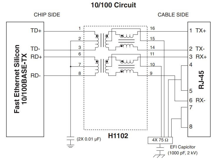

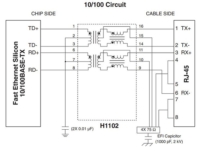

The whole idea with Ethernet is it has differential pairs which are transformer coupled at both ends of the cable.
When EMI noise hits the cable each wire of the twisted pair gets (nearly) the same noise. Since it is differential, the noise is cancelled out when it reaches the transformer.
Secondly, there is no direct (electrical) connection from cable to the Chip side. Electrical potential differences between the object (SLB in this case) and computer are isolated by the transformers at each end of the cable.

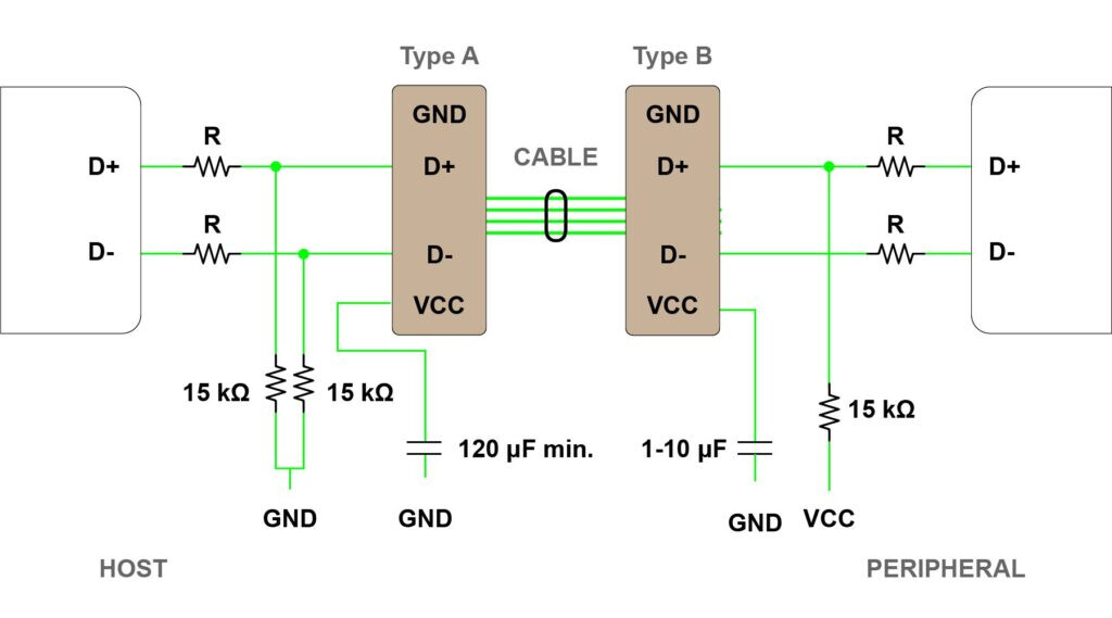

USB, on the other hand, has no isolation. The differential pair D-, D+ is directly (electrically) connected to the chips at each end and a ground wire provides the reference. EMI noise on a USB cable is coupled directly into the chips at each end. The USB data pair has some differential immunity, but still the noise on each wire of the pair is directly connected to the Chip.
Furthermore, if a potential exists between the computer and the object, you are likely to create a ground loop where current is going across the ground reference wire (data wires, VCC power too). This can lead to component damage at each end and smoke/ melting of the wire/cable. [Trust me… I have encountered this. This is the reason I don’t use USB between a computer and another device which has its own power supply.]
USB Circuit:
 ![image](https://forum.sienci.com/uploads/default/original/2X/d/df691dea1e68acf281b042aab059244d24f0c37f.jpeg)
 ![image](https://forum.sienci.com/uploads/default/original/2X/7/76c49485c11c233660bc287b3c4cc727748e0deb.jpeg)
