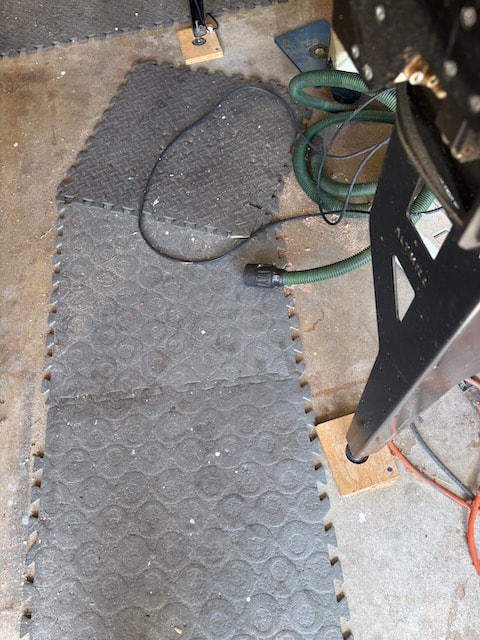

### Author: ![Scottp](https://forum.sienci.com/letter_avatar_proxy/v4/letter/s/8dc957/32.png) [@Scottp](https://forum.sienci.com/u/Scottp)
#### Post date: [September 6, 2026, 5:57pm UTC](https://forum.sienci.com/t/looking-for-inputs-stabilizing-altmill-for-rapid-movements/27006/7 "2026-09-06T17:57:50Z")
Hey Matte.
Here’s my simple solution that has worked for three years and also allows me to use the height adjustable feet included with the altmill. Scrap plywood tap con to the floor on all four legs. Just pick up and move if necessary.
 ![image](https://forum.sienci.com/uploads/default/original/2X/4/4118915e09a4b985b78c4fc4d6a4c4c05f36aeb8.jpeg)
### Author: ![Matte](https://forum.sienci.com/letter_avatar_proxy/v4/letter/m/7cd45c/32.png) [@Matte](https://forum.sienci.com/u/Matte)
#### Post date: [September 7, 2026, 2:22pm UTC](https://forum.sienci.com/t/looking-for-inputs-stabilizing-altmill-for-rapid-movements/27006/8 "2026-09-07T14:22:01Z")
@_Michael Thanks for calling this out. Makes sense but I didn’t think of it before. If I go this path, definitely will need to put sound deadener pads between connections to help.
@Scottp I did something similar → made some 6x5" feet to put under my table, covered the bottom with non-slip. Table feet are cut into the plates. Planning to install in a few days to see how it goes.
