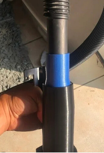

I found this adaptor on thingiverse to adapt my shpvac to the magnetic dust shoe. I needed to reduce the OD (by 0.9mm) of the half that fits into the longmill shoe (the plastic I used to print didn’t shrink after cooling). The CAD files are with this.
[shoe adaptor](https://www.thingiverse.com/thing:4574643)
 ![Screenshot_2020-12-28 Shopvac adapter for Sienci Labs' CNC dust boot by jdaveiga](https://forum.sienci.com/uploads/default/original/2X/6/6969da10a604b27c7c30307548c34e260aed67ef.jpeg)
Hope this helps someone.
