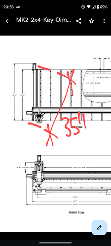

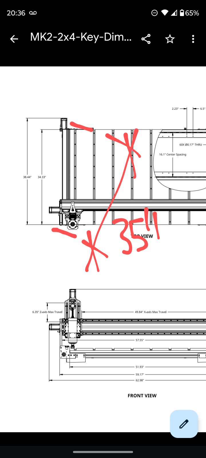

Hi all,
Still waiting on my Onefinity G2, and having a few second thoughts. Not sure anyone here can help, but the man door i would have to move the CNC through on a semi regular basis is 35” wide. Specs say the Altmill 2x4 has a 38” wide foot print. I am wondering if that includes the steppers. If it does I am wondering how deep just the frame is without steppers? It might be possible to angle the machine to get the steppers around the door frame, then get the machine through and then angle the machine around again to get the other stepper out the door. Hopefully that makes sense. Does anyone think this might be possible? If so I may cancel the 1F and order the 2x4 Altmill?
@JimmyBuckets Did you see this? https://resources.sienci.com/wp-content/uploads/2024/09/MK2-2x4-Key-Dimensions.pdf
38.44" including the stepper
34.33" without.
Probably a bit more if you included the thickness of the legs and bolt heads.
@JimmyBuckets I’m assuming you’d have the table on casters? They would likely extend past the 34.33" of you mount them to the legs. You might need to have them inset a bit.
@JimmyBuckets I don’t think it would work with a 35" opening that is likely at least 5" deep.
At some point, you’ll need to swing out the Altmill to get it through the door frame and the diagonal distance will surely be more than 35"
Thank you. Yes I think you are right. I could probably get the first half out, but the second swing would not have enough room. So close but it seems just not really workable no matter how I try.
