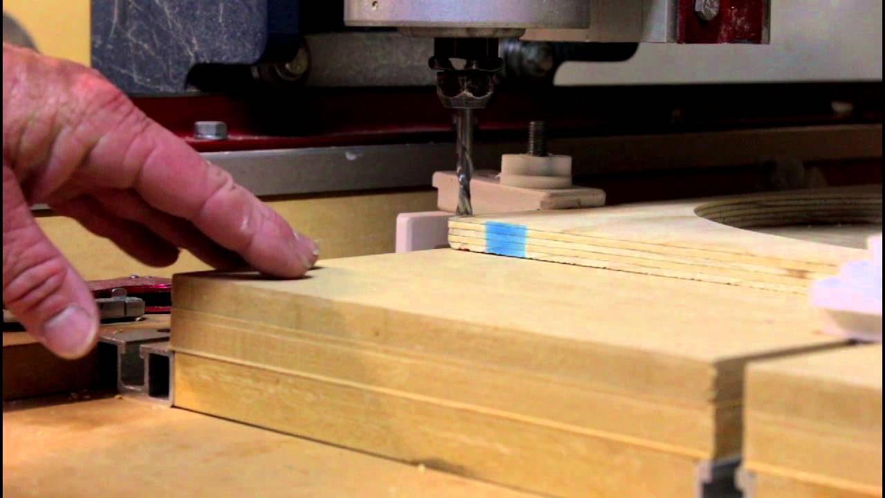

EDIT: I forgot it would display the image, the just right click and “Save Image As” to get the SVG file.
EDIT2: Now that you have made a pretty spoil board, watch the following to learn how to not ruin it.
[![](https://img.youtube.com/vi/Q-Q1o16Ux-I/maxresdefault.jpg "Don't spoil your Spoilboard - CNCnutz Episode 51") ](https://www.youtube.com/watch?v=Q-Q1o16Ux-I)
