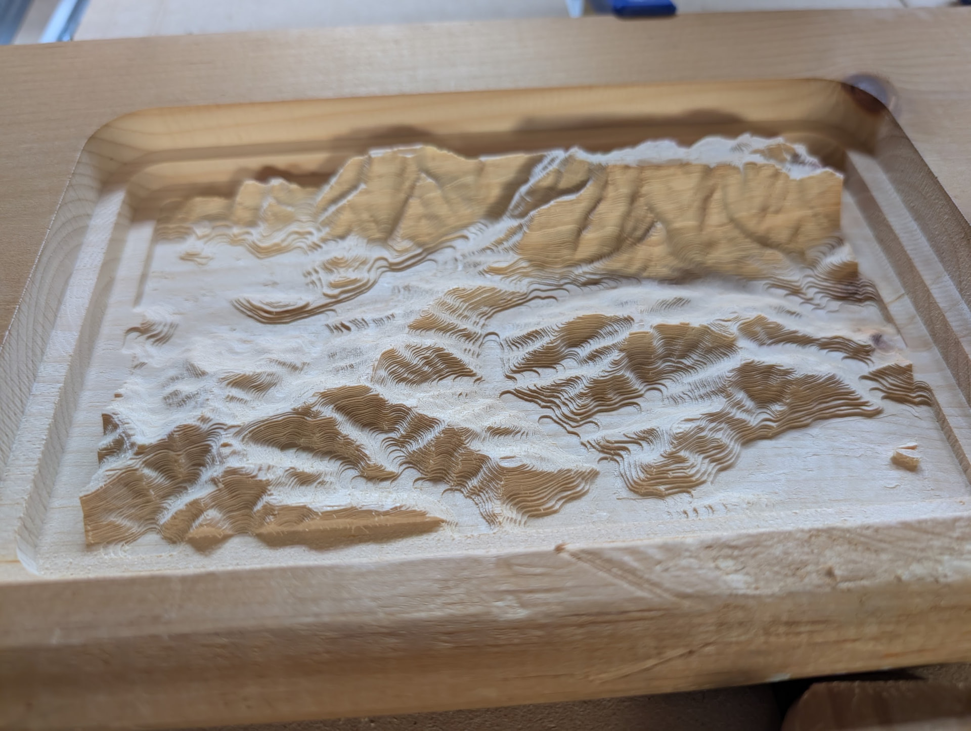

I knew my LongMill needed some maintenance, so I replaced all the v-wheels, upgraded to the new zero maintenance anti-backlash nuts, cleaned everything up and installed the closed-loop stepper motor kit. Upgraded my shop vac as well for better dust control.
I’m liking the results a lot - turns out I did have some backlash in X, and also turns out the closed loop steppers are really quite nice.
I have been experimenting with carving terrain to make souvenirs of ski trips - I’m planning to laser-etch my recorded tracks onto the carved reliefs. Still working out the workflow to do that (just discovered [https://touchterrain.geol.iastate.edu](https://touchterrain.geol.iastate.edu) which makes the first step really a lot easier than what I was doing) and I’m still experimenting with Fusion 360 adaptive clearing to give a bit of a stepped texture to the reliefs to highlight the contours.
All that said, here are the results:
 ![image](https://forum.sienci.com/uploads/default/original/2X/6/6a42d5b2433a6100f9434c0573a53b93508936ad.jpeg)
The above is the result of two runs of adaptive clearing - the first with a wider outline than the second, to avoid tool collisions (this is being done with a 1/8 inch flat endmill).

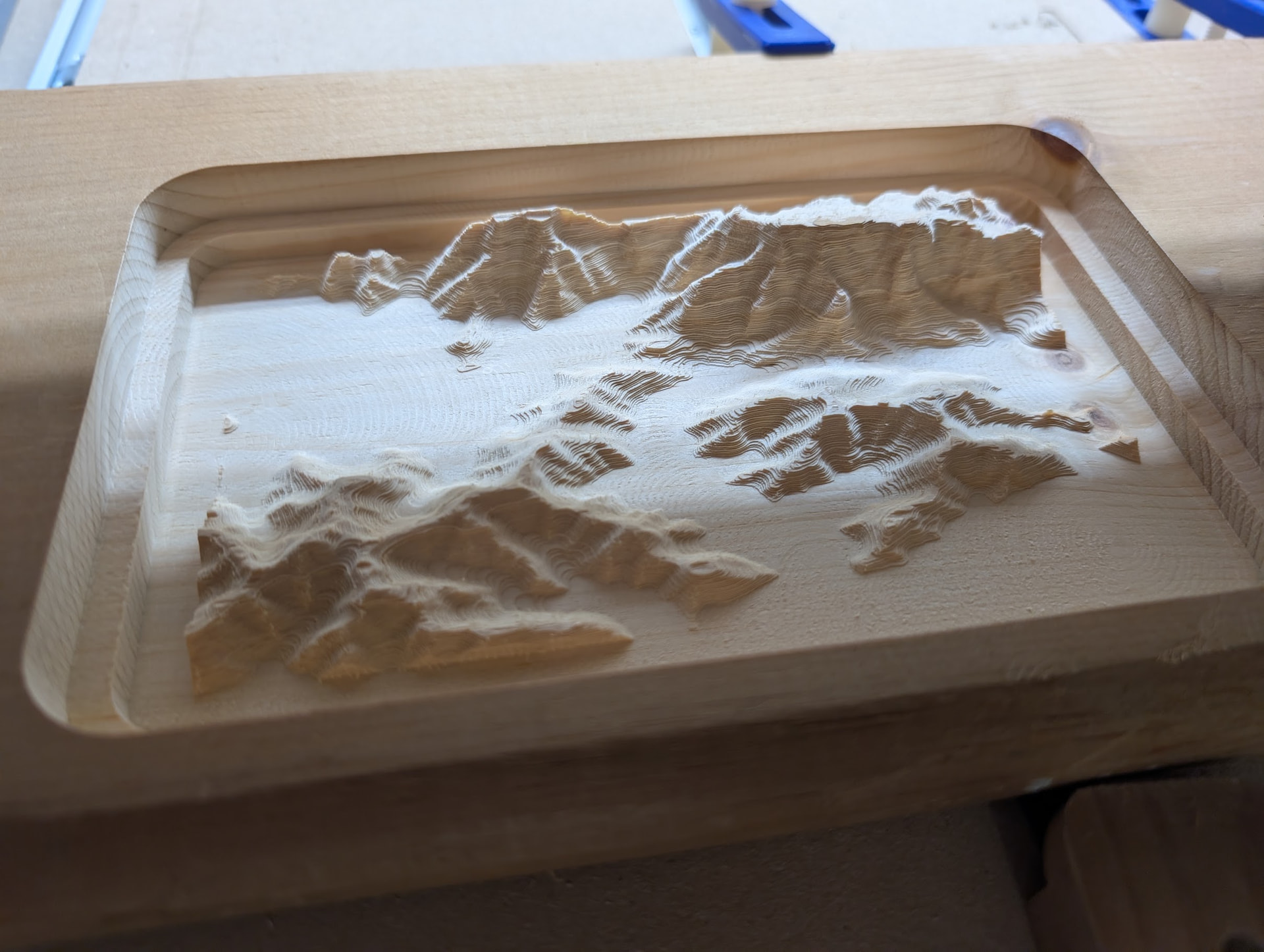

 ![image](https://forum.sienci.com/uploads/default/original/2X/4/410757ee26e8919b433b0eac5e9858f08a62b034.jpeg)
The second is the current “final” state after an additional pass - but I’m still looking at further refinement possibly using a ball-nosed endmill to get into the narrower features in the valleys.
Overall, I am liking how the terrain ends up looking - and really liking how smooth and tight the mill is behaving now that it has been tuned up and the closed loop steppers added.
I still need to decide on what wood to actually use - the pine I’m using is just a reclaimed futon frame, and small features sometimes tend to chip away (not that I need that kind of precision). Really looking forward to seeing how tracks lasered onto the terrain looks, too.
