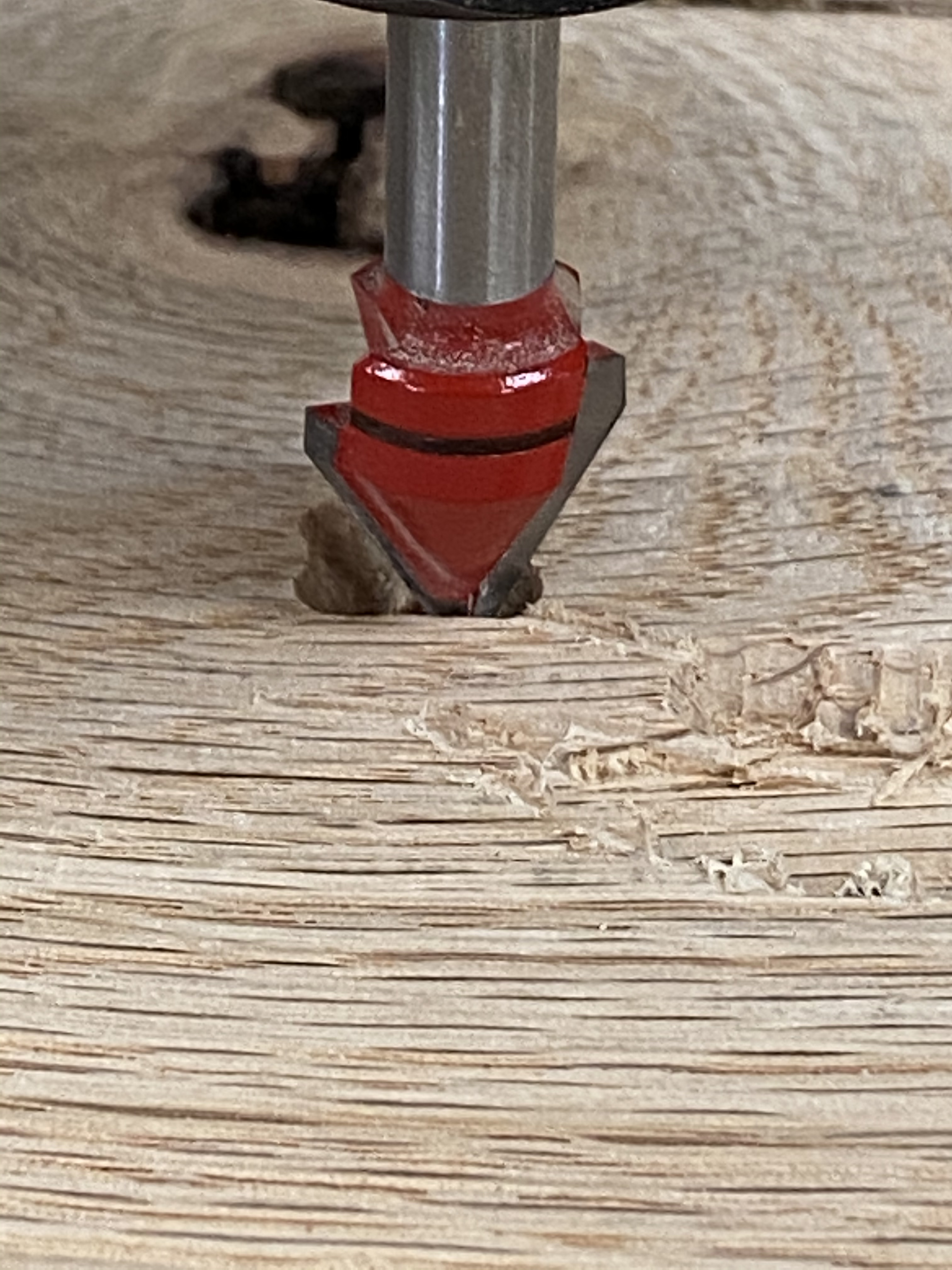

Today I try to make some job and I don’t know what’s happened but my cnc didn’t do what it supposed to be.
I try to make some simple jig.
 ![drill jig](https://forum.sienci.com/uploads/default/original/2X/4/417bd81247a82735315ecde66385dd21ed00c02c.jpeg)

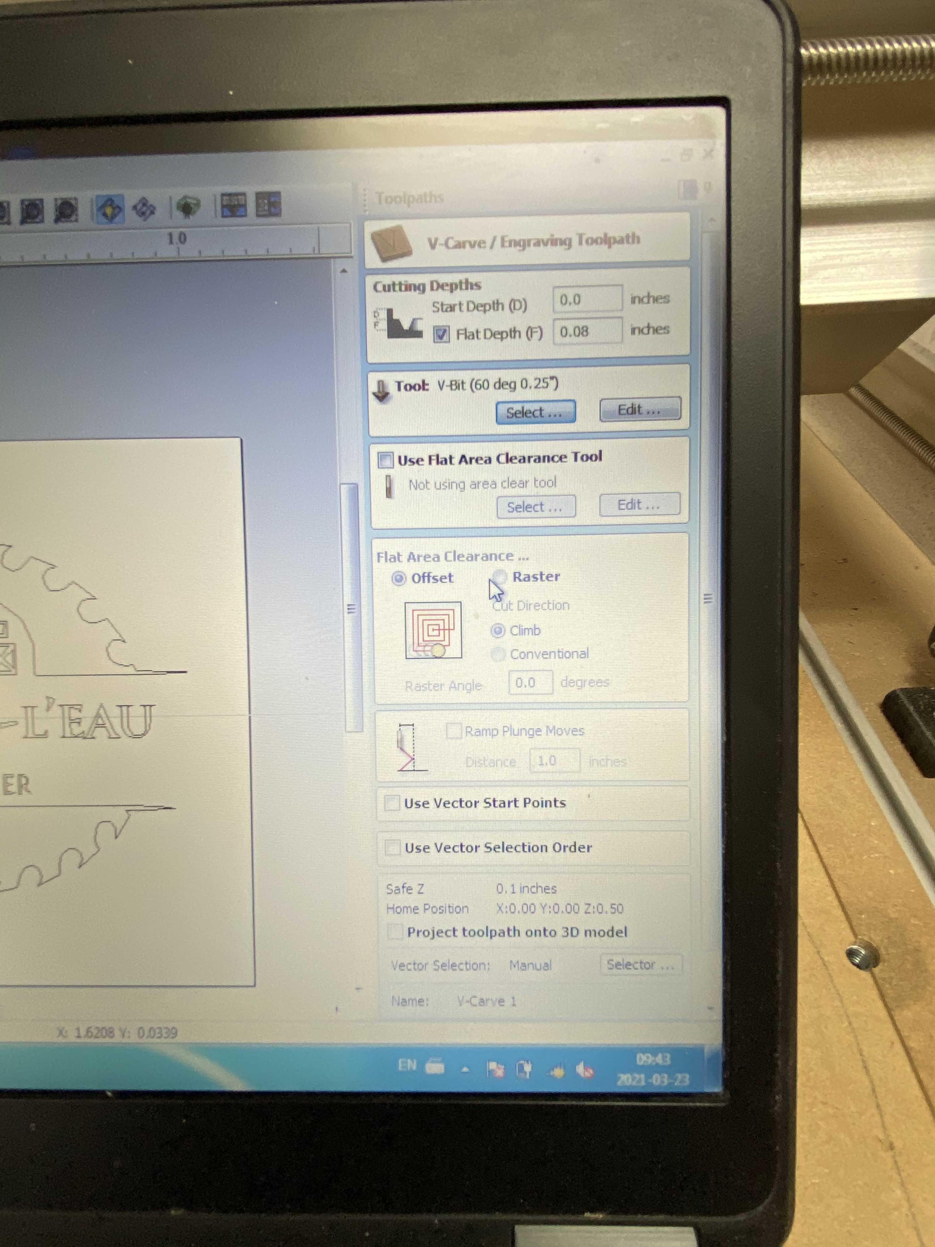

This is an old file that I already use without any issue, now I just change some holes size, recalculate toolpath and make new gcode.
Try with gSender. It drilled first hole bottom left, the Z didn’t retract and Y go all the way up ( like 0.70’’ depth cut…
I stop it. recheck my spec in vectric aspire. Everything looks good.
Take two, now with UGS. no issue until the last pocket pass. Z axis go down and cut like 1/4’’ over (cut my wastetable).
Last one, I try a 60 degree V-Carve signature, I use a gcode file who I already use many many times perfectly. 0.05’’ depth. with gSender = It start good for 3-4 seconds and after it start to go down randomly like 0.50’’ depth and burn my V-Bits…
The simulation in my laptop supposed to be ok. the CNC didn’t move like what I see in my laptop
Try with UGS = same issue. I didn’t modify this gcode file it’s the same file that I make some signature.
Seriously I need help before firing it…
**Post date:** [March 23, 2021, 12:04am UTC](https://forum.sienci.com/t/my-cnc-is-possessed/2719/2 "2021-03-23T00:04:26Z")
@GuillC What version of Aspire are you using?

**Post date:** [March 23, 2021, 1:35am UTC](https://forum.sienci.com/t/my-cnc-is-possessed/2719/3 "2021-03-23T01:35:05Z")
9.5
But one of the gcode file I tried was 6-7month old. Never having issue with this (logo signature) since today

So I work on it now and I see something wrong.
Always at the same time on UGS and gSender. I lost my Z or my cnc didn’t retract. I double check all connectors. Everyone is tight
**Author:** ![GuillC](https://forum.sienci.com/letter_avatar_proxy/v4/letter/g/9fc29f/32.png) [@GuillC](https://forum.sienci.com/u/GuillC)\
**Post date:** [March 23, 2021, 2:55pm UTC](https://forum.sienci.com/t/my-cnc-is-possessed/2719/8 "2021-03-23T14:55:25Z")
When I pause it it supposed to by Z: -0.275mm but in reality it’s at 3.5mm depth.
