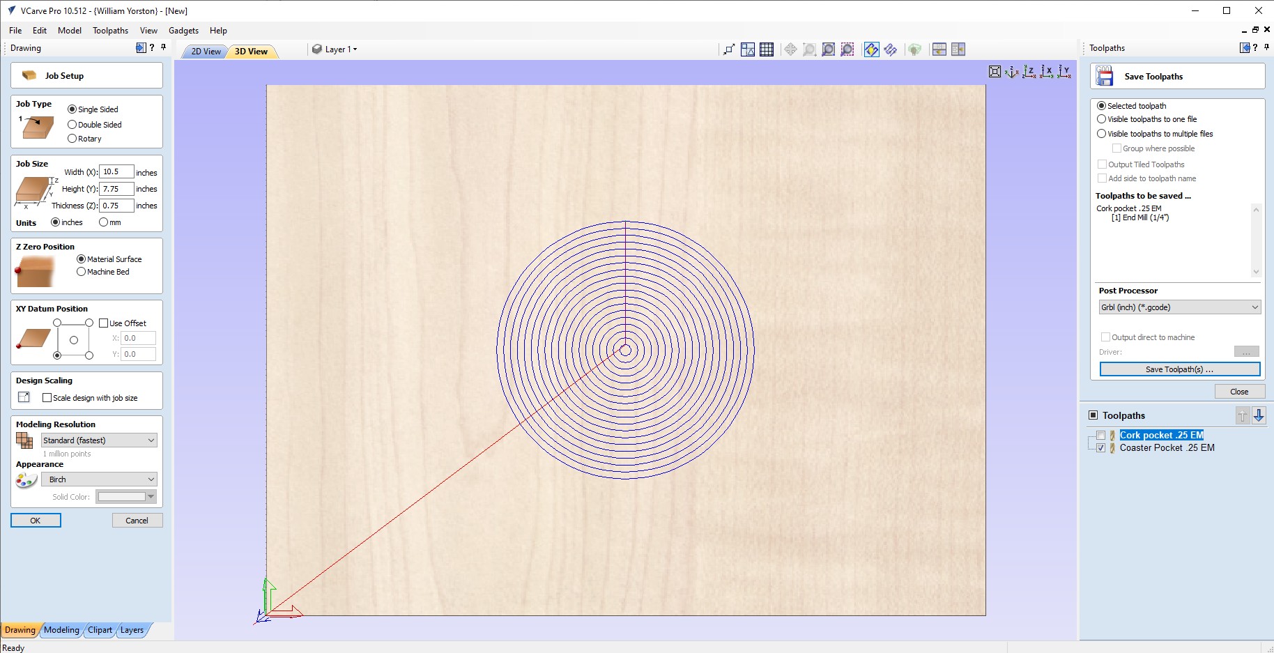

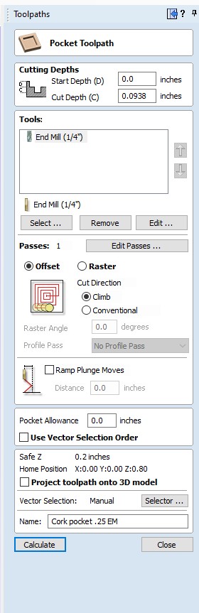

**Post date:** [March 5, 2021, 6:16pm UTC](https://forum.sienci.com/t/my-long-mill-is-acting-up/2590/12 "2021-03-05T18:16:31Z")
@Bill This one really has me puzzled, Bill. Clearly, the controller is sending signals to the X motor, since you can cut a circle. Just as clearly, the gcode shows an initial command to move the X axis 5.25".
When you run the toolpath in VCarve and preview it, what does it show? Is that initial move in X shown?
Can you post a screencap of the material setup screen from Vectric and of the pocket toolpath?

**Post date:** [March 5, 2021, 6:34pm UTC](https://forum.sienci.com/t/my-long-mill-is-acting-up/2590/13 "2021-03-05T18:34:45Z")
@gwilki Tech support told me to call V Carve, not a response I expected or appreciated, my wife and I now have orders coming in and this cnc has stopped working, can’t do a thing with it…
 ![1](https://forum.sienci.com/uploads/default/original/2X/e/ef6bc0fe26b84af3ccc7d699566e471f11253d11.jpeg) ![2](https://forum.sienci.com/uploads/default/original/2X/0/07cdde86bde29434a162e5aeb25405fb31941ce2.jpeg) ![3](https://forum.sienci.com/uploads/default/original/2X/f/f9f815e07a5c37f0530c80923ac75e47c737ff91.jpeg) ![4](https://forum.sienci.com/uploads/default/original/2X/e/e2a7eb2363f61f1e10090c2fc74b02f178ba16e1.jpeg) ![5](https://forum.sienci.com/uploads/default/original/2X/1/11286d5e0e40594385af3a8f618fd4ae33d30071.jpeg) ![6](https://forum.sienci.com/uploads/default/original/2X/8/81988527ffdbc89e70b883e43f32e3fe6267fc67.jpeg)
