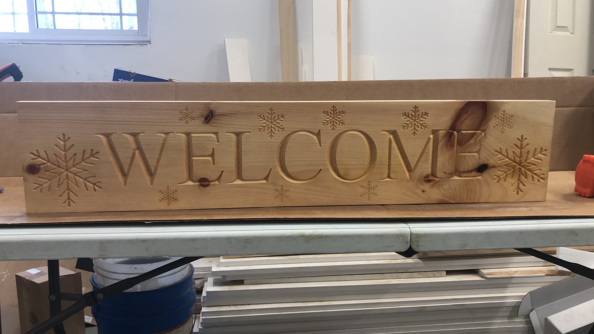

Just got my Longmill 48x30 recently and here are a few of my projects
