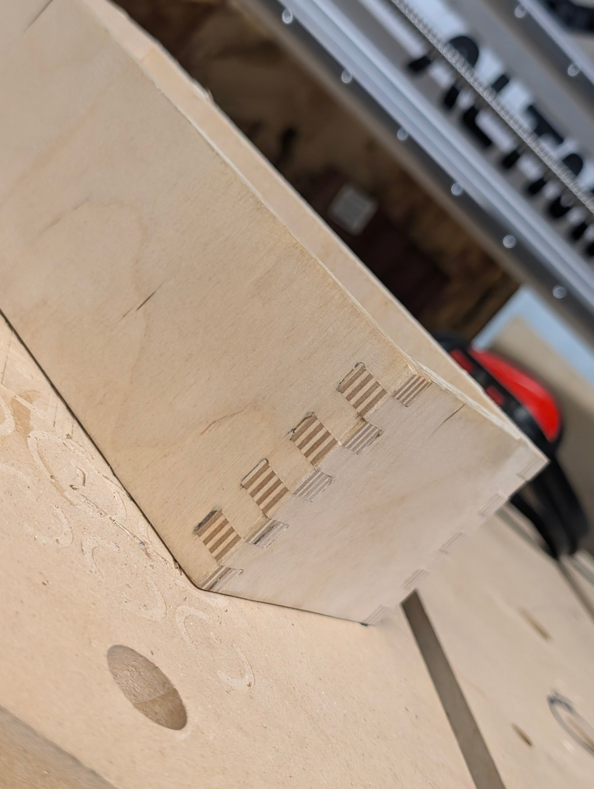

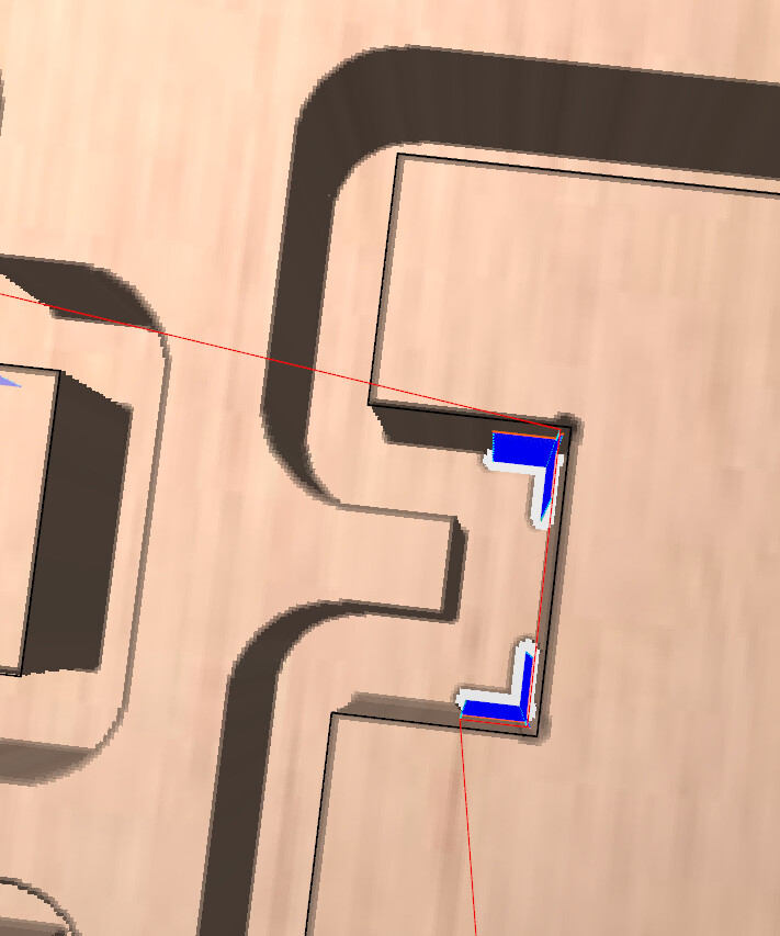

I’m making some box joints but want to use a smaller bit for the dogbones to make them less obvious on the finished project.
This gadget allows you to use a large bit (example: 1/4") for the main profile then come back with a smaller bit (1/16") for the dogbones ONLY.
As of now the gadget identifies the inside corners, creates new vectors, and adds them to their own layer. It does not create toolpaths. For me this is a huge timesaver
I’m testing now and would love some feedback!
PS- I’m not sure how to upload the gadget? Message me if interested and I can send it to you.

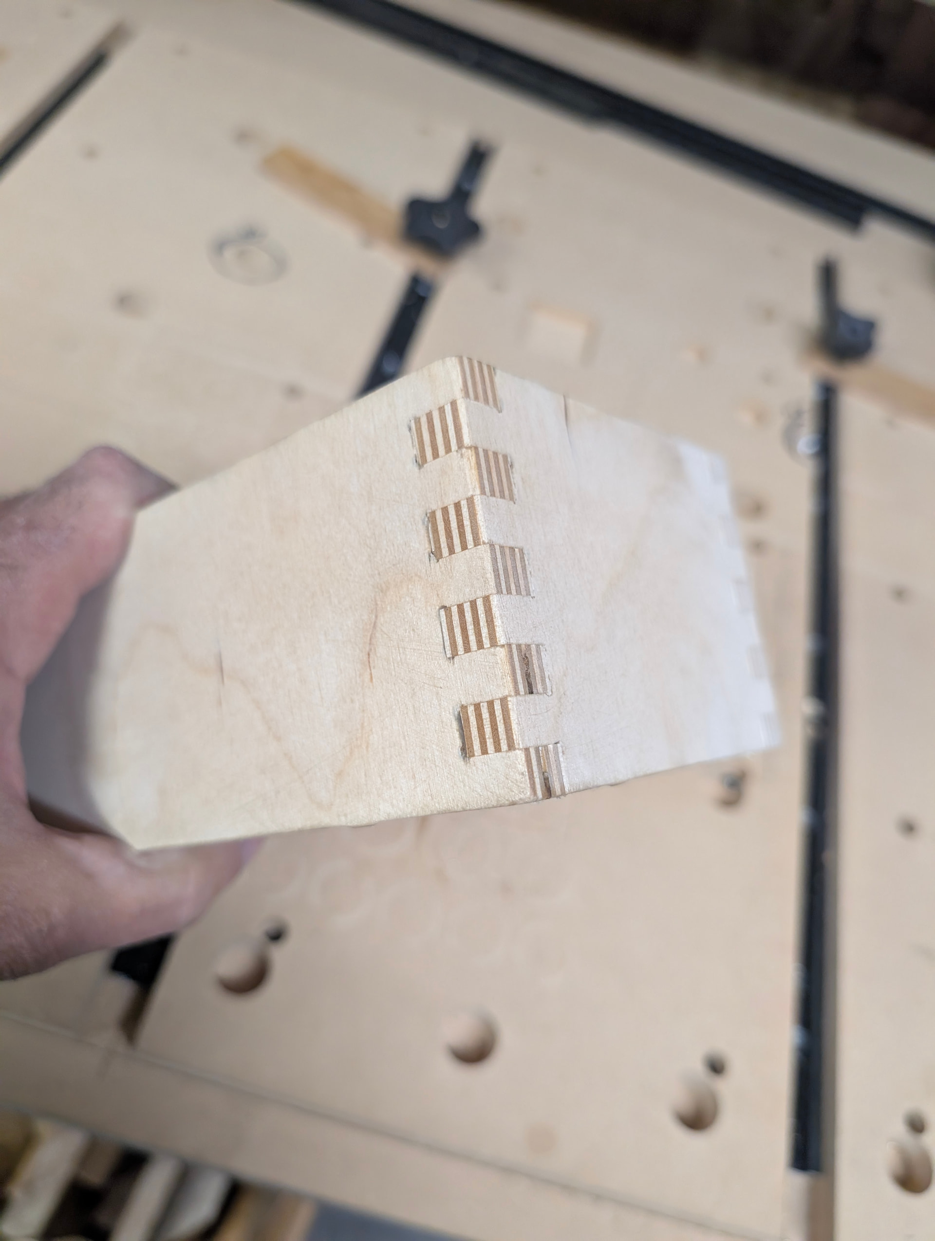

I’m super happy with the results. No big ugly dog bones. Just little ugly dogbones. I did the main cutout with a 1/4 endmill and added the dog bones using an 1/8" endmill. I’ll try another test with a 1/16 in and I think they’ll pretty much just disappear.
I also made another gadget for doing drawers/boxes that gives you the option for a groove to slide in a bottom.
Here’s a VERY rough test that I just finished. No glue. Just a dry fitup, about 3 minutes of sanding, and a quick coat of wax.

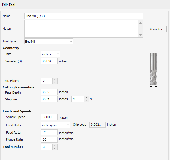

I love the idea of blind joints- I am going to play with that.
I did a quick test of one small drawer with a 1/8 vs 1/4.
 ![image](https://forum.sienci.com/uploads/default/original/2X/b/be40190ed965e325429212372ff9766613a7a4bb.png)
Maybe I’m being too conservative with the 1/8" bit?
I’m cutting 1/2" baltic birch.
1/8" settings:
 ![image](https://forum.sienci.com/uploads/default/original/2X/2/2229ad66a3a7f17d5f5f25754a258320e24f39ca.png)
**Post date:** [April 26, 2026, 4:53pm UTC](https://forum.sienci.com/t/new-mini-dogbone-creator-gadget/26259/7 "2026-04-26T16:53:45Z")
My default maximum depth of cut is the bit diameter (0.125 in) - going with 0.05 in seems way too conservative.
For 1/8" bit I go with 18000 rpm, feed rate of 3000 mm/min (118 in/min), stepover varies based on situation.
75 in/min seems reasonable but you can probably push things a bit more.
I have never sat down and compared machining time but a tool change that brings machining time from 30 minutes to 5 minutes would make sense.
