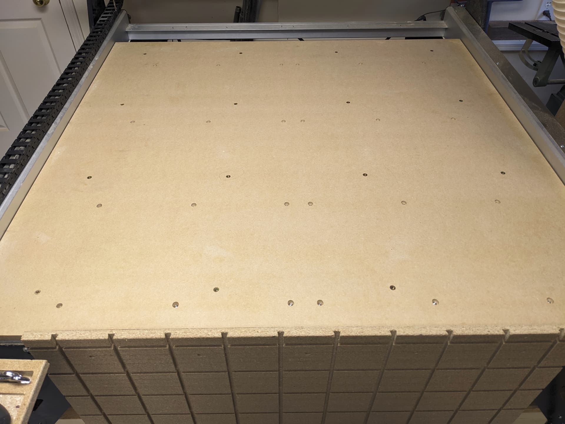

I finally got my new Altmill baseboard and spoilboard done. The Altmill stringers were tapped, the base board was attached to the stringers from the top. The baseboard received inserts to be used to attach the spoil board to the baseboard.
Mill base table with attaching screws not screwed down yet:
 ![mill base table](https://forum.sienci.com/uploads/default/original/2X/d/d2b9600088eacaf914a4cf74bdb8bc12df4c01a5.jpeg)

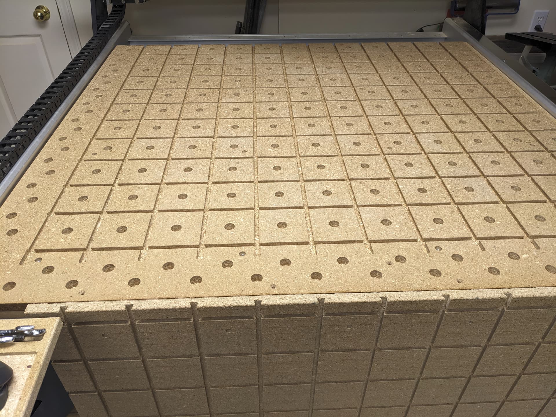

Mill base table attached to the mill and inserts installed:
 ![cnc mill table](https://forum.sienci.com/uploads/default/original/2X/e/efd60729ec15fb24b00bc0f45e9fa38cd51a0da0.jpeg)
There are 4 rows of 4 inserts per row.
Spoilboard installed:
 ![spoilboard](https://forum.sienci.com/uploads/default/original/2X/1/150b582db9bbb0eaae6a1f3593458e740f85accf.jpeg)
The dog holes are on 100 mm centers, they are 20 mm in diameter. The slots are match-fit slots used as an alternative to T Tracks. They are also on 100 mm centers. The front board for upright edge milling shows what the match-fit slots look like. They are basically a dovetail (but somewhat specialized) profile.
Next project will be a trial vacuum table that can be installed on top of the spoilboard when needed.

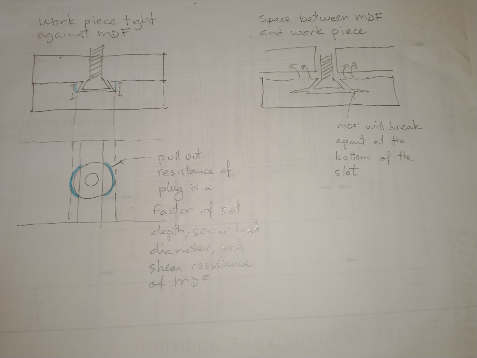

I did some more research on exactly how strong these matchfit slots are and ran into an interesting tidbit. If you clamp a piece of wood onto the slotted table with a matchfit F clamp, you can pretty much reef on the clamp however much you want without breaking out. If however you clamped the wood in such a way that it wasn’t sitting in contact with the table (ie the top of the slot) then breakout was much easier. This makes sense when thinking about this. The moral of the story is to be extra careful when you are trying to clamp down a floating object (for example an edge clamp to hold a flat workpiece down.
I still believe that there is plenty of clamping force available, even with MDF, for what we need.
**Post date:** [August 10, 2025, 1:02pm UTC](https://forum.sienci.com/t/new-spoilboard-done/21432/6 "2025-08-10T13:02:11Z")
@Jens Correct. If the clamped piece is tight against the slot, the MDF won’t break apart at the screw head as the screw tries to pull out. You are essentially squeezing the MDF and your piece together. The mode of failure would be a plug of MDF that pulls out along with the screw. The shear force that holds that plug in place would be a factor of the screw head diameter, the depth of the slot, and the shear strength of MDF.
Conversely, if your piece is not clamped properly, the only thing keeping your MDF together is, well not much.
And sorry for the engineering explanation 😔
