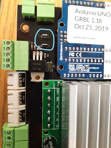

I have no red lights, but to do have a green light on the power brick, and I can also see a tiny green LED flashing close to where the power comes into the controller (maybe the arduino?). Jogging the power switch has no effect.
Machine was bought in April - any suggestions?

Contact Sienci. Sounds like known power switch problem.

Confirmed. Wiggling the power switch causes it to “bounce” the red lights on/off - but will not stay on unfortunately. No CNC playing for me today it seems.
**Post date:** [November 15, 2020, 7:30pm UTC](https://forum.sienci.com/t/no-red-lights-on-controller/1881/4 "2020-11-15T19:30:11Z")
@flxstr Mark: While you are waiting to see about a replacement controller, you can bypass the switch and plug the controller into a power bar to turn it on and off.
I’m attaching a pic of the terminals that you bridge to make this happen. I did this with my original controller. It took all of about 5 minutes
 ![mill-controller](https://forum.sienci.com/uploads/default/original/2X/d/d8da4bf9fd72a1563e43c9519acc61b9654f66ce.jpeg) .

Wouldn’t a power bar be the incorrect voltage there - wouldn’t it be better to use the power output from the brick instead?
**Post date:** [November 15, 2020, 8:23pm UTC](https://forum.sienci.com/t/no-red-lights-on-controller/1881/6 "2020-11-15T20:23:00Z")
@flxstr If you bypass the switch, the controller is always on. I suppose you could cut the cable from the brick and put a switch into that. It’s much simpler to plug the brick into a power bar and simply use the power bar’s switch to turn the Mill off and on. That way, there are no cables to cut. It’s your call, though. I just wanted to keep it simple.

it’s later in the day, and I’ve had more coffee. now I understand what you mean by “bridge”. LOL
That would be easier.
