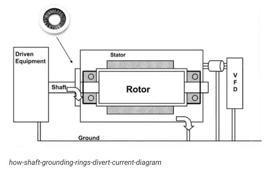

Jens is correct though a new spindle will conduct the probe ground sufficiantly at first. Due to the nature of digital signals, a ground does not need to be a perfect ground to flip a signal. One can flip a digital one into a zero using a ground connection through a resistor up to a few kilo ohms (pull down). The bearings not being a perfect conductor isn’t a problem when a spindle hasn’t been used a lot.
When a bearing is starting to wear down and maybe accumulates dust particles, the ground signal might become a maybe and no longer _always_ trigger the flip to zero.
A spindle with a shaft grounding ring mitigates this problem by diverting the ground signal via a direct route from the shaft to the body instead of using the bearings. But even then it will eventually become a game of chance, because shaft grounding is not imume to wear either,
 ![Screenshot_20260702_172632_Firefox](https://forum.sienci.com/uploads/default/original/2X/0/0a0d144175a3f7a641b4fb08165dc799d489abfa.jpeg)
So yeah, it will work, and if you stay vigilant (keep track of the shaft to body resistance), you can get away with it for quite some time before the inevitable ohnoooo. Me using mostly cheap ass bits, would prolly take the risk, because.. meh.
