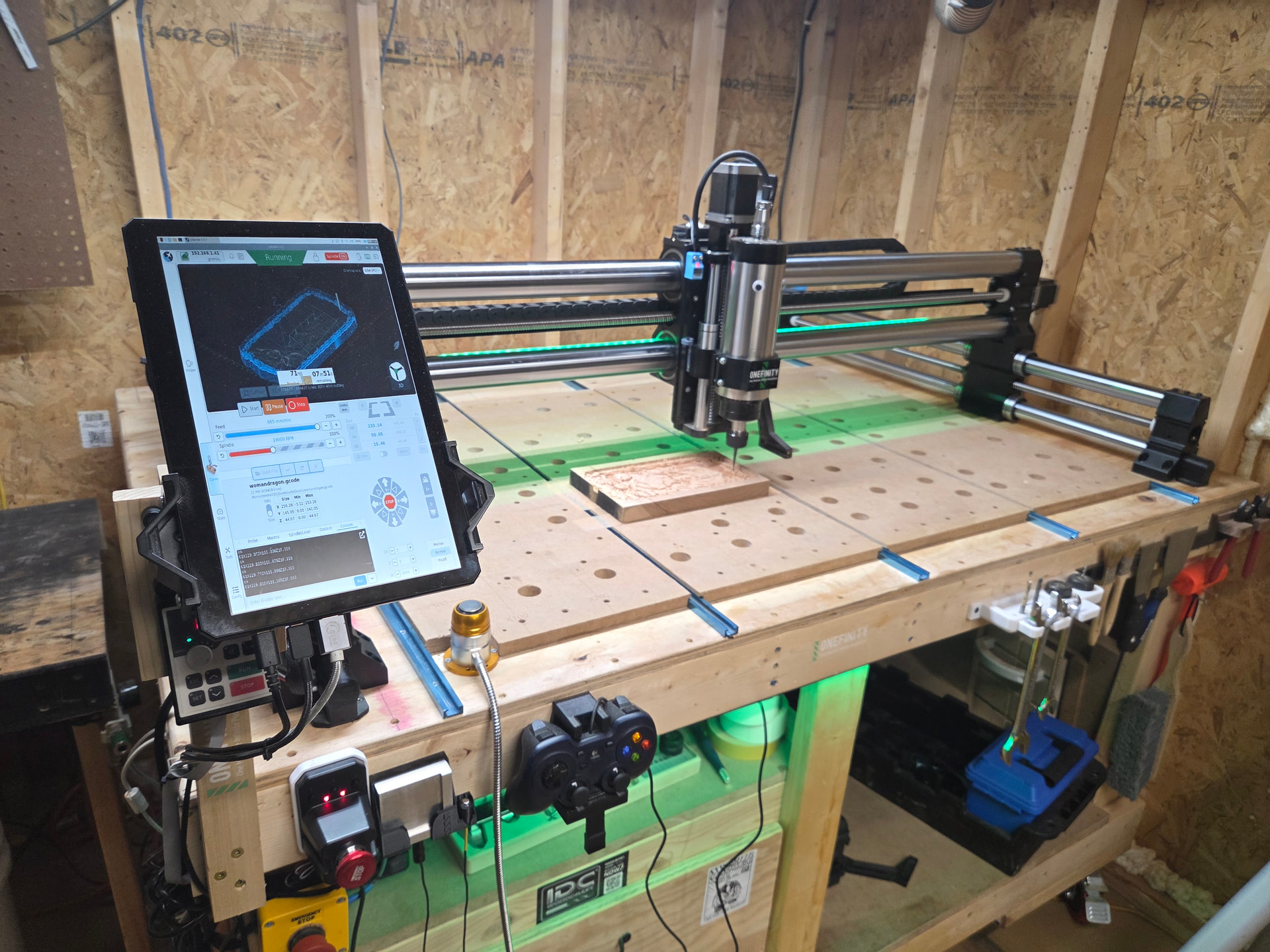

I just finished up with the main steps of converting my Onefinity Journeyman from Buildbotics to a Super Longboard. I started this because the Buildbotics controller just did not meet my needs. The SLB has so many features that the B.B. did not. I tried to use as much of the original parts and wiring as I could (cheap) I used the original steppers (have the z20 z axis), the original motor wires, screen (10”) and touch plate. I have a 2.2 kw er20 spindle and vfd (Zhong Hua Jiang with H100 VFD) as well as a raspberry pi 5. Put a 256gb m.2 nvme SSD hard drive in the pi. I’m running gSender on the pi5 hooked up through ethernet to a 5 port switch, Slb is hooked up through ethernet to the same switch. both have static ip’s. using the 10” touchscreen on the pi is a little rough, my eyes are not what they used to be. I installed sn04-N2 npn nc proximity sensors (front facing, square sensors) on the X, both Y rails, and the z axis. For the switch mounts, I found some on Makerworld and thingiverse but had to modify them to suit my needs. Z axis was the trickiest one to mount. Wiring the motors was pretty straight forward. Onefinity uses a crossover inside the tubes, keeping that in mind the wiring goes black A+, blue A- , red B+, green B-. I set the acceleration to 250 on all axis, travel resolution on x is 399.348, y= 638.95, z=634.92. microsteps at 32. I flashed the firmware with SLB Alpha B5.0.10 AS so that I could utilize the auto square. after the machine was running and calibrated I installed the Onefinity touch probe. had a little bit of issues getting it going at first. I also installed a tool length sensor. Both did not seem to work together at first. no combination of $6 and $668 would let them both function. so I tried wiring the probe to the tls port and the tls to the probe port. with $6=0 and $668=1 they both work perfectly. I also wired up neopixel leds under the x gantry (rail) and 40 leds under the table the machine sits, wired to the ring input. At first the leds on the gantry stayed white all of the time. tried adjusting the settings to no avail. ended up coming across a post on this forum with the solution. the author had used a capacitor across the + and - or the leds and a resistor on the data line. I found that I only needed a resistor (330 Ohm) on the data line for mine to function properly. So far the machine is working great. I am so happy I made the switch to the Super Longboard. Eventually I plan to purchase the SLB-EXT with closed loop stepper motors. I figure when I do I will use the SLB for my laser engraver.

![20260220_180343](https://forum.sienci.com/uploads/default/original/2X/7/73c112f372e95b975c86136d98d68b0f86b82668.jpeg)

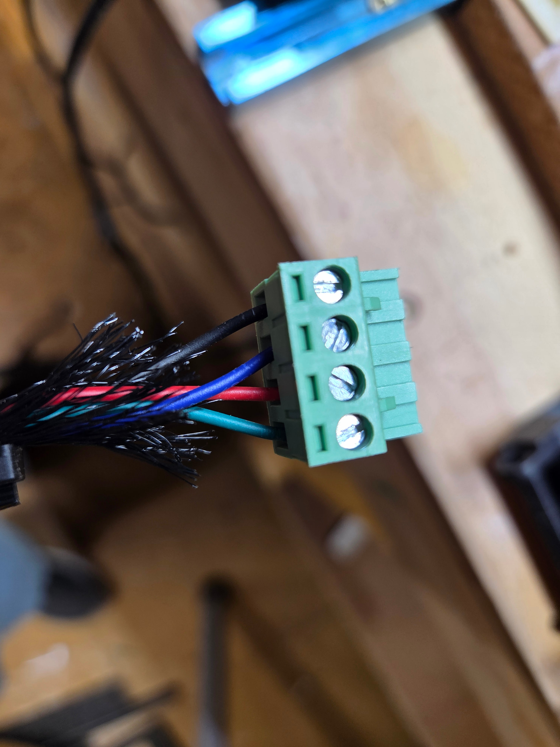

**Author:** ![zerone010](https://forum.sienci.com/user_avatar/forum.sienci.com/zerone010/32/11423_2.png) [@zerone010](https://forum.sienci.com/u/zerone010)\
**Post date:** [February 20, 2026, 11:12pm UTC](https://forum.sienci.com/t/onefinity-conversion-advice/21839/17 "2026-02-20T23:12:39Z")
![20260204_183525](https://forum.sienci.com/uploads/default/original/2X/0/0dca49d2bb41681bb1519e9814fed1ba532fded4.jpeg)
Onefinity motor cable to SLB, with the crossover still intact inside the tubes.
