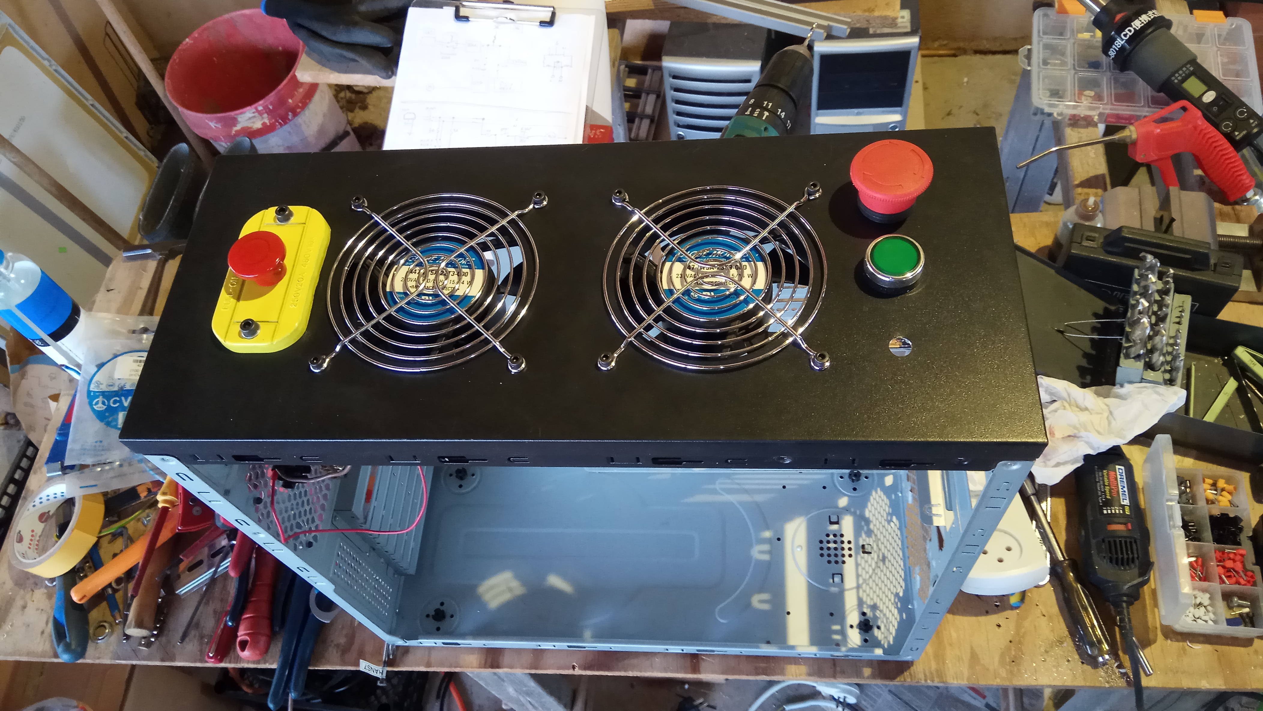

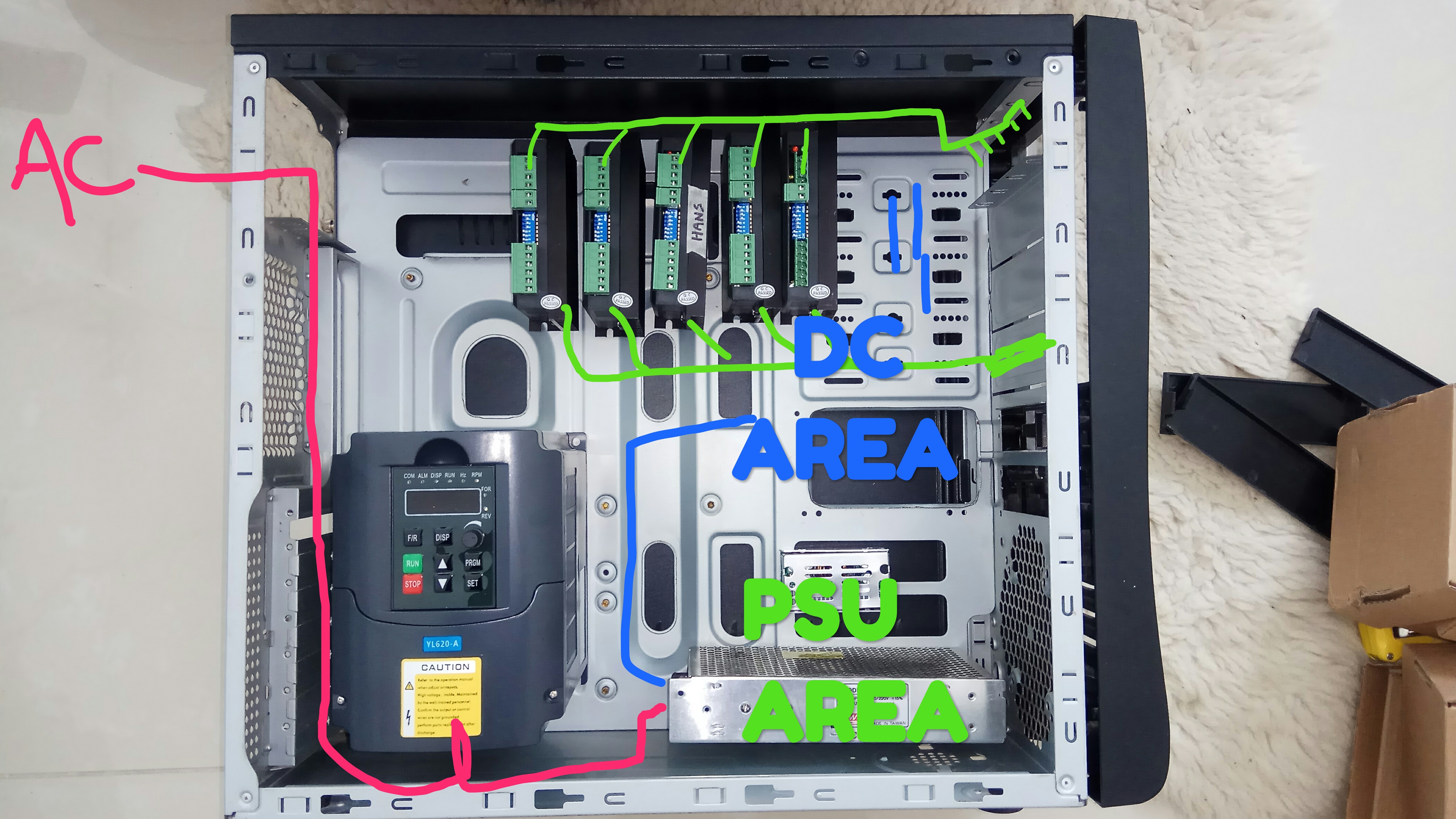

**Author:** ![Hansi](https://forum.sienci.com/user_avatar/forum.sienci.com/hansi/32/216_2.png) [@Hansi](https://forum.sienci.com/u/Hansi)\
**Post date:** [April 29, 2020, 8:21pm UTC](https://forum.sienci.com/t/opensource-longmill-scratch-build/191/71 "2020-04-29T20:21:52Z")
Main control panel layout
 ![IMG_20200408_171831_HDR](https://forum.sienci.com/uploads/default/original/1X/cd5690de6c33fc8c7f251d2ea1fb44fb94f44841.jpeg)
From old PC case
 ![IMG_20200409_135107](https://forum.sienci.com/uploads/default/original/1X/6ea157ce6386808957977b4276f64ffeb2f5668f.jpeg)

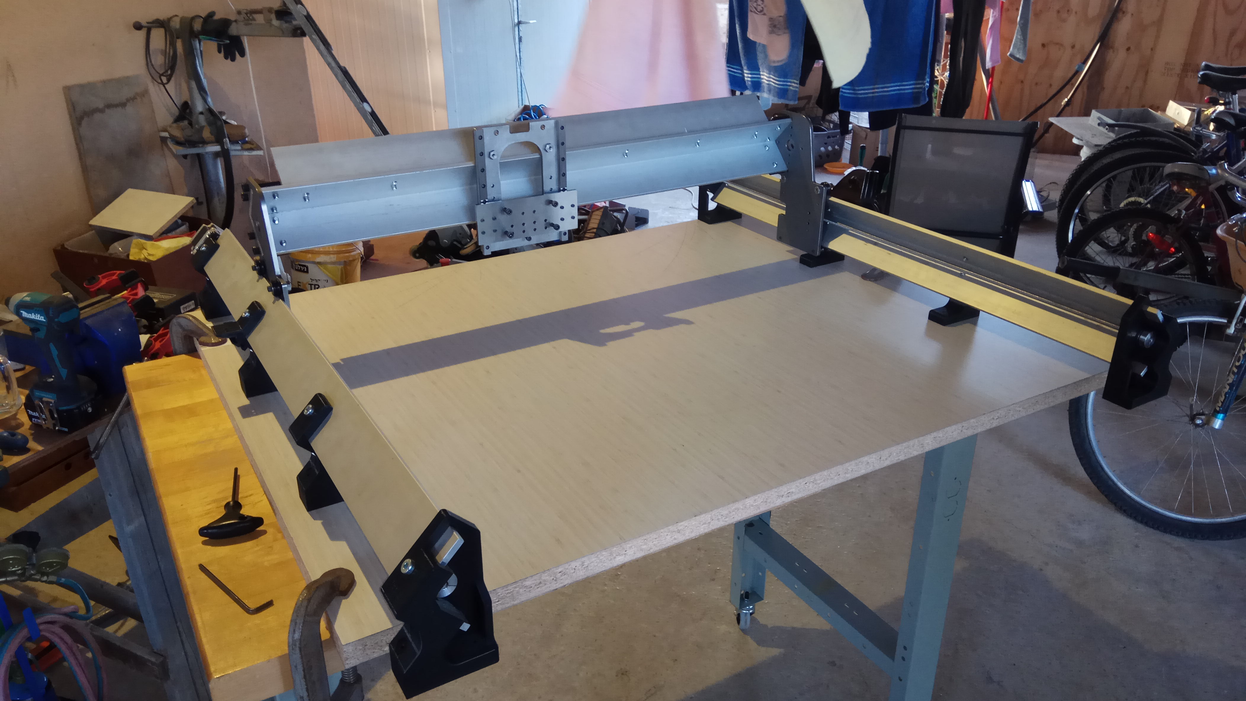

**Post date:** [April 29, 2020, 8:31pm UTC](https://forum.sienci.com/t/opensource-longmill-scratch-build/191/74 "2020-04-29T20:31:49Z")
Finally got it moved outside, after being in the living room.
Much to my wife’s relief:)
 ![IMG-20200428-WA0014](https://forum.sienci.com/uploads/default/original/1X/dd4f5894a8984871e9cd484a2e9ac368a83e4091.jpeg)
**Post date:** [April 29, 2020, 8:33pm UTC](https://forum.sienci.com/t/opensource-longmill-scratch-build/191/75 "2020-04-29T20:33:34Z")
Just a temporary base that you see there.
I still have lots of work… But rewarding to see it this far.
