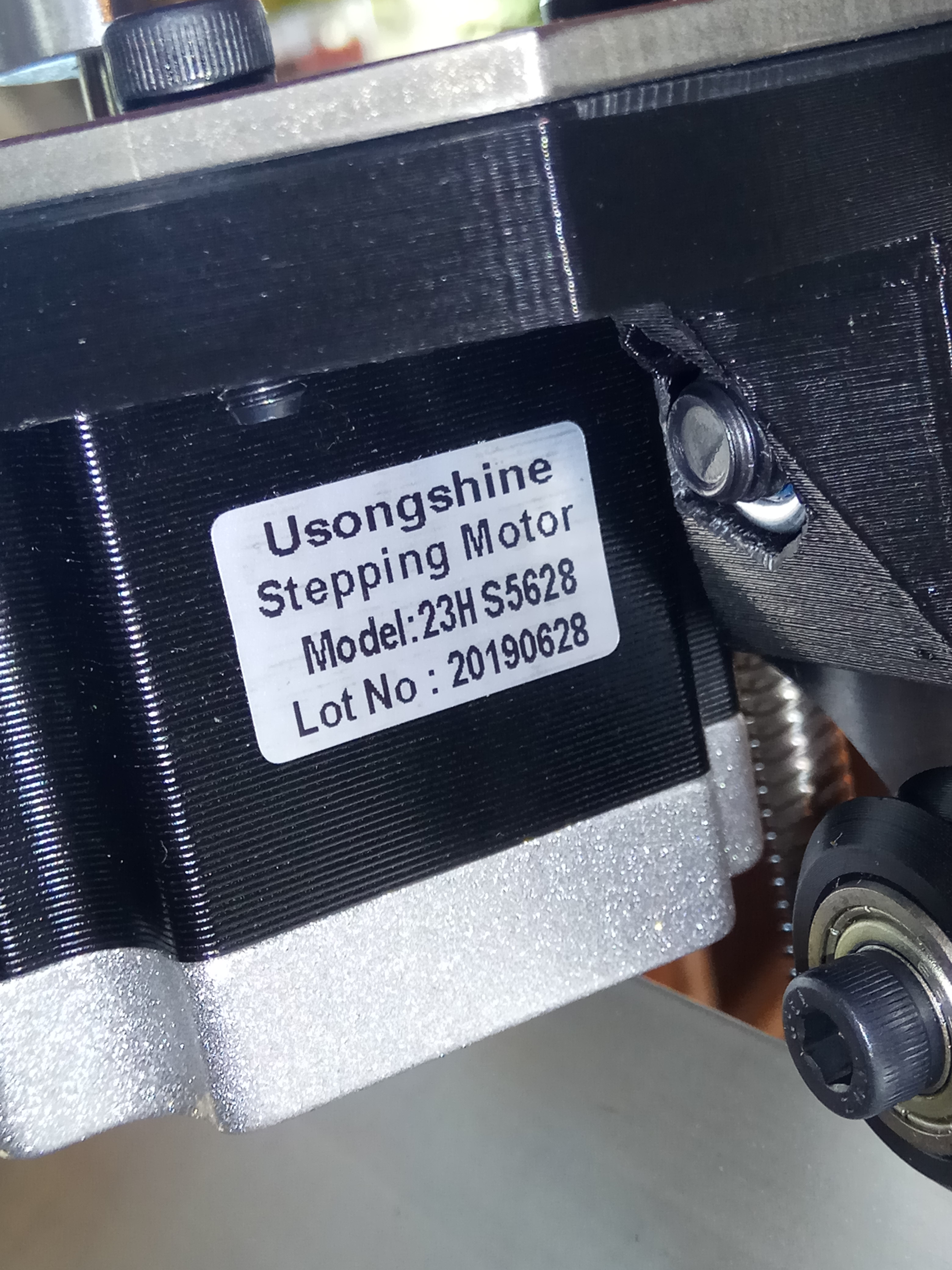

Motors are pretty much the same.
My controller is the DDCSv2.

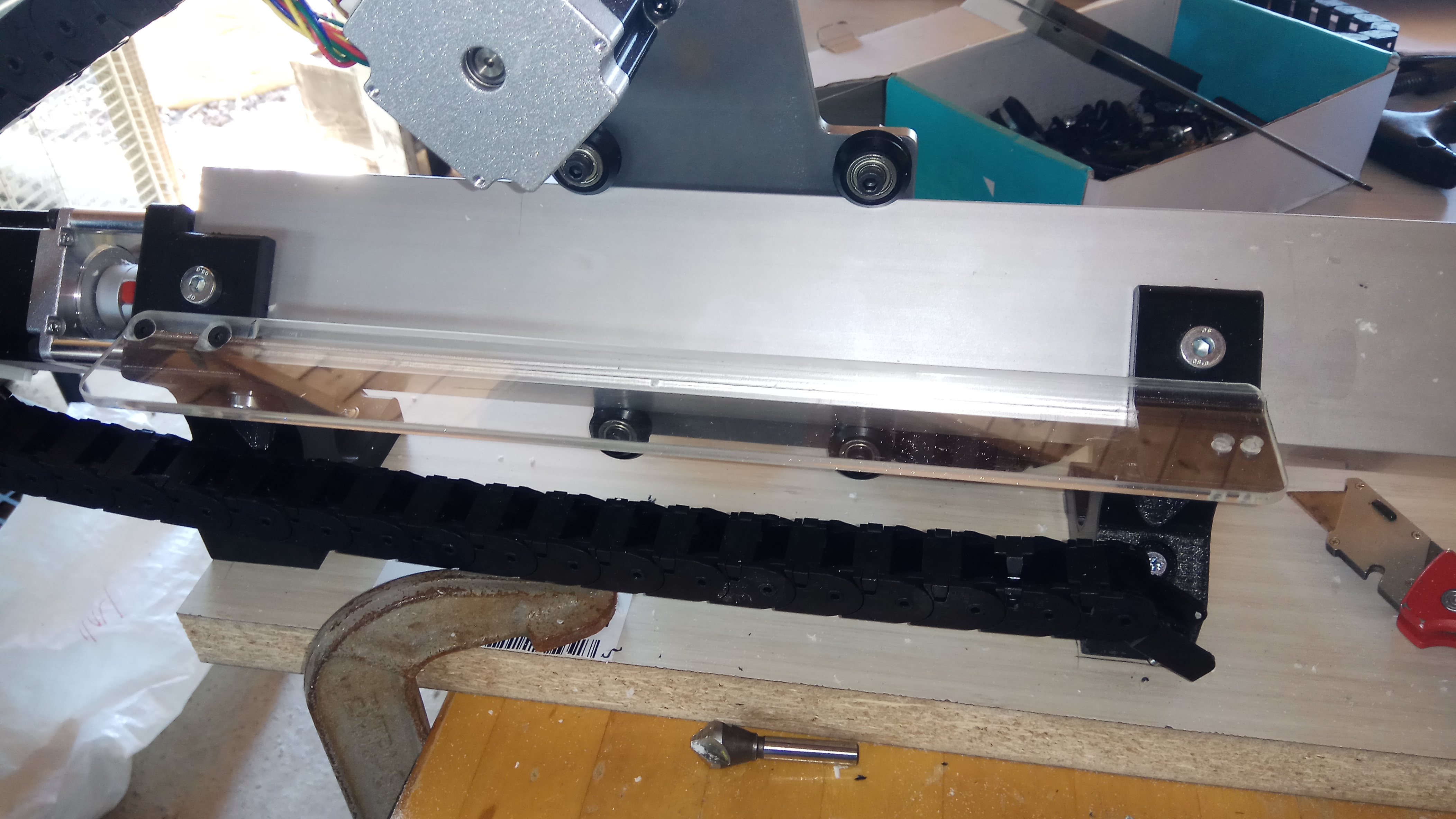

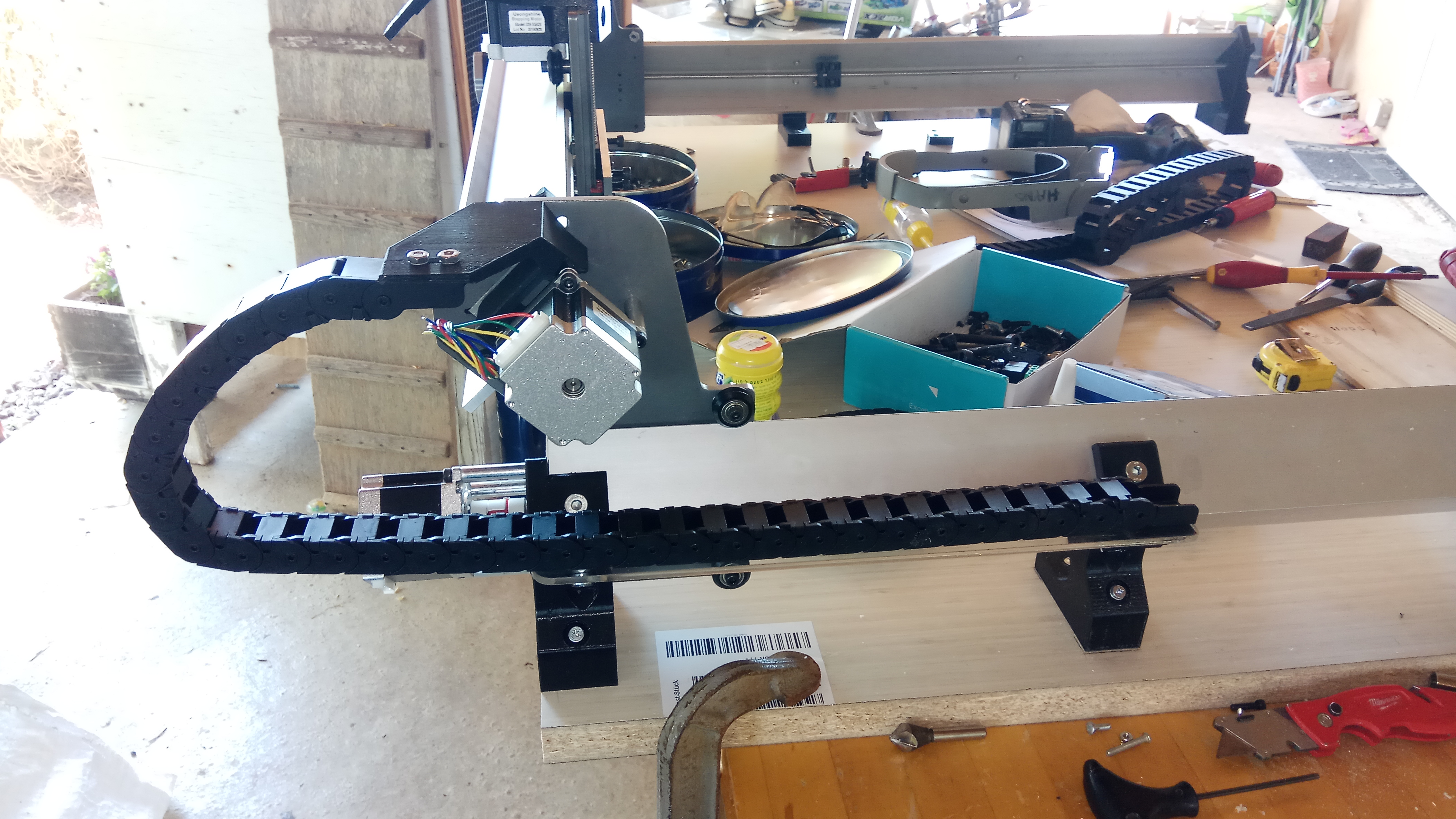

I added a simple Y-axis drag chain support. The drag chain that I ended up getting, has a 180° swivel end link, so the chain would just droop down, behind the support. It’s hard to figure out all those details when you order from AliExpress… But that’s part of scratch building.
 ![IMG_20200501_112612](https://forum.sienci.com/uploads/default/original/1X/946ebf64fc369556a5db8984235b40819ebcf532.jpeg) ![IMG_20200501_122547](https://forum.sienci.com/uploads/default/original/1X/80301e7652e399d458e036487d38ed7f375df308.jpeg) ![IMG_20200501_122627](https://forum.sienci.com/uploads/default/original/1X/81a6f058d71b7062f7df12837d507d30d448cda1.jpeg)
**Author:** ![Hansi](https://forum.sienci.com/user_avatar/forum.sienci.com/hansi/32/216_2.png) [@Hansi](https://forum.sienci.com/u/Hansi)\
**Post date:** [May 1, 2020, 11:48am UTC](https://forum.sienci.com/t/opensource-longmill-scratch-build/191/85 "2020-05-01T11:48:35Z")
I did shorten up this chain by 5 links, after I took the picture

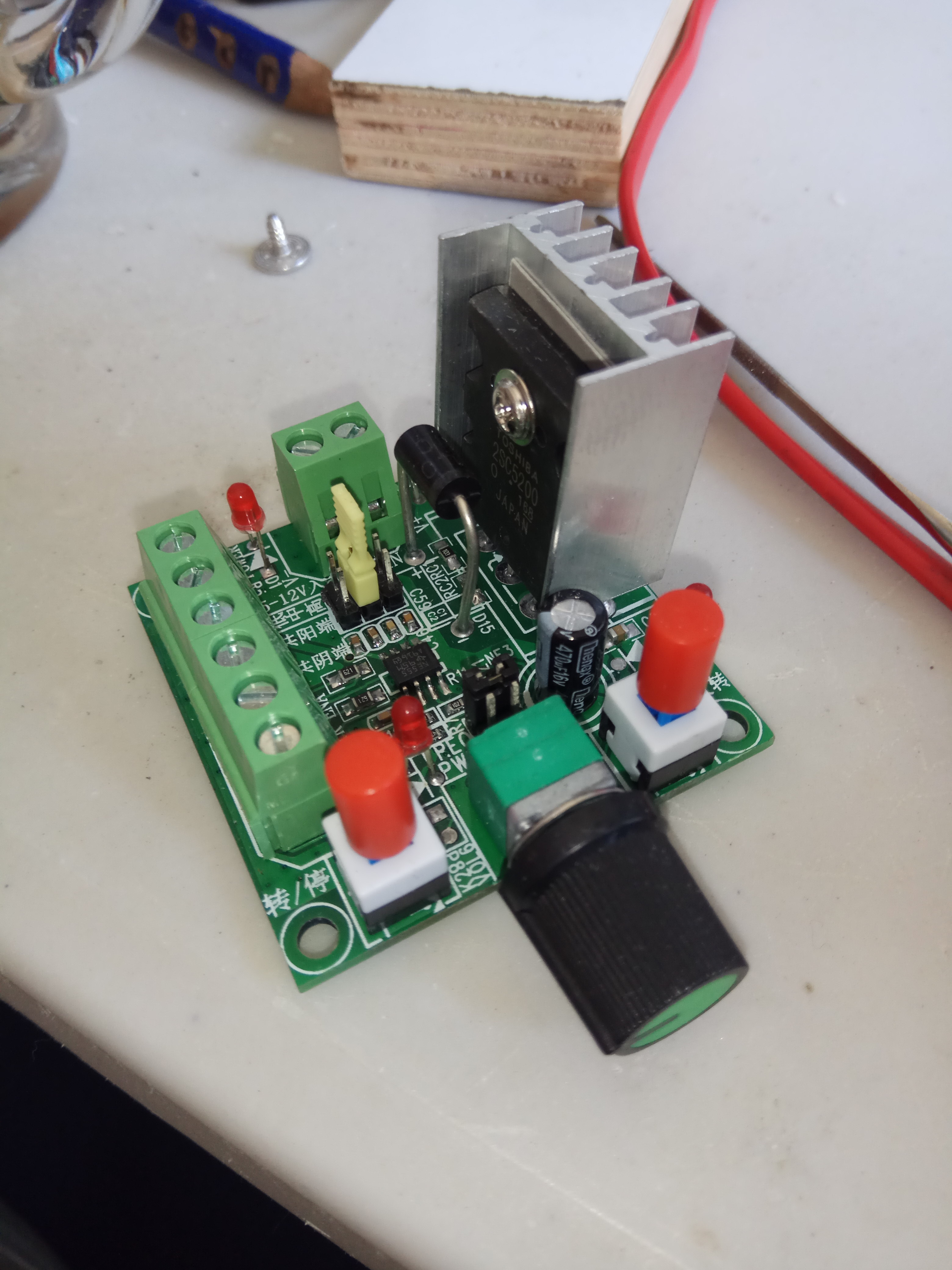

I may just test out my axis’s with this cute PWM signal generator board I got.
Let’s see…

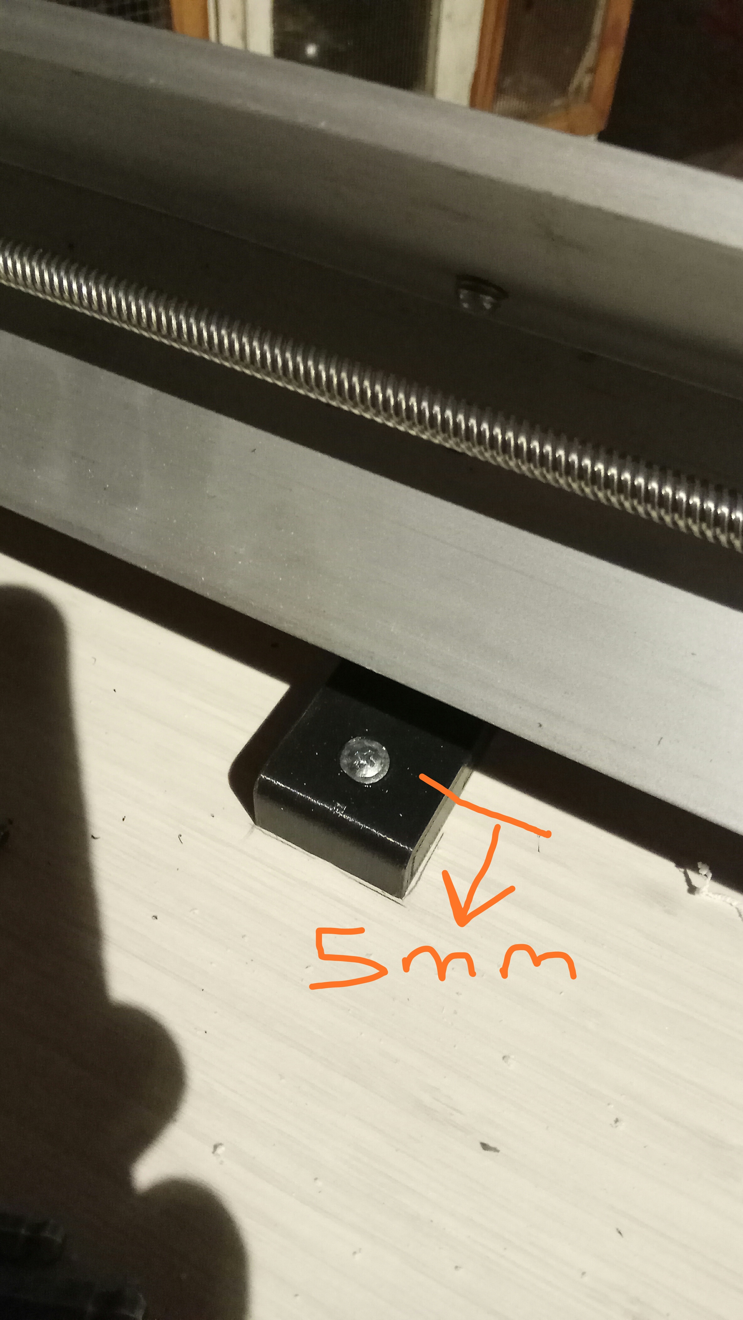

Gert:

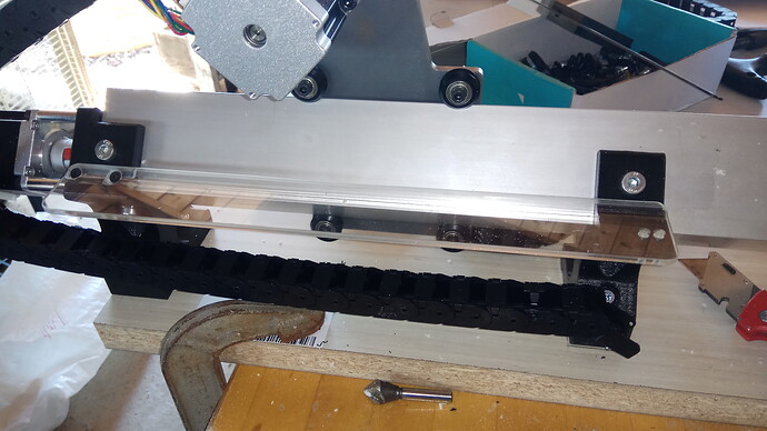

I would change one thing… Move the vertical screw down hole, in the middle leg supports, 5 mm outwards. The angle iron was a little in the way of getting the screw down.
 ![IMG_20200501_194350](https://forum.sienci.com/uploads/default/original/1X/7053732fe7ea4db2edd3566ab241f696ac2a5ff5.jpeg)

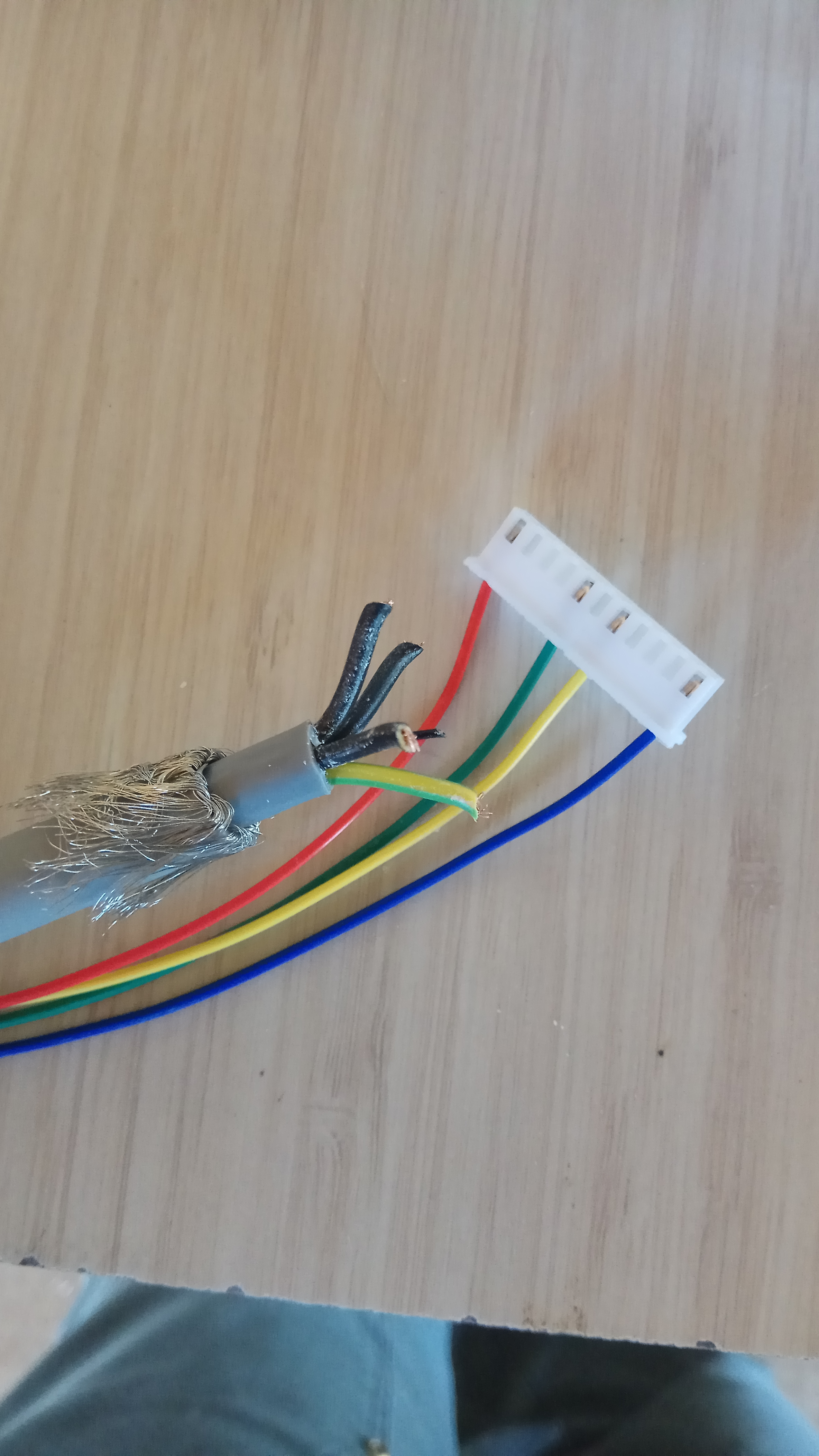

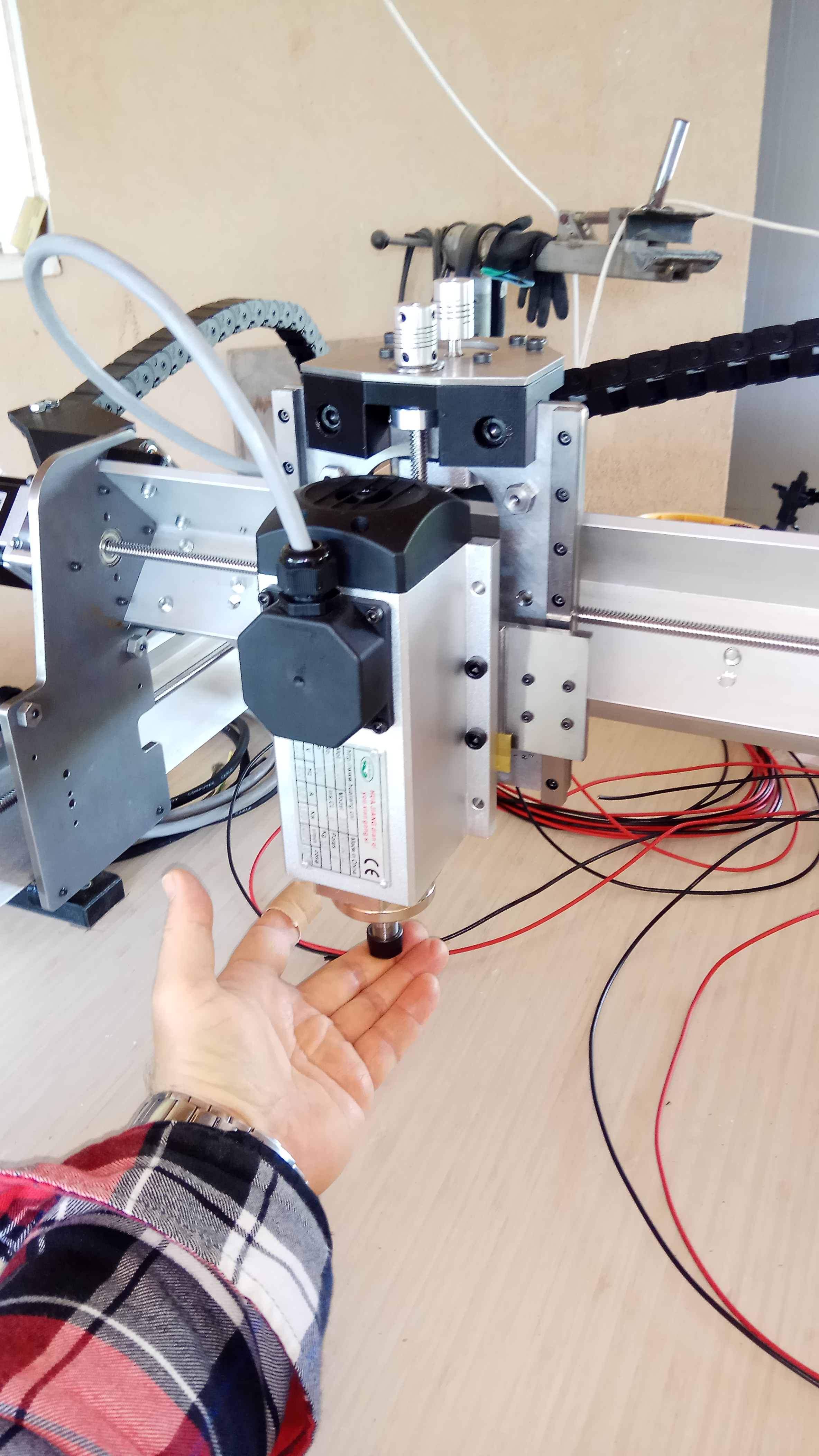

![IMG_20200508_124131](https://forum.sienci.com/uploads/default/original/1X/f6a9315b96b894102d6b5eaf5bac77f522564ba4.jpeg) The wiring harness that these motors come with are pretty fine…like 24-26 AWG compared to my 20 AWG that I’m trying to use.
Other people even use 18AWG

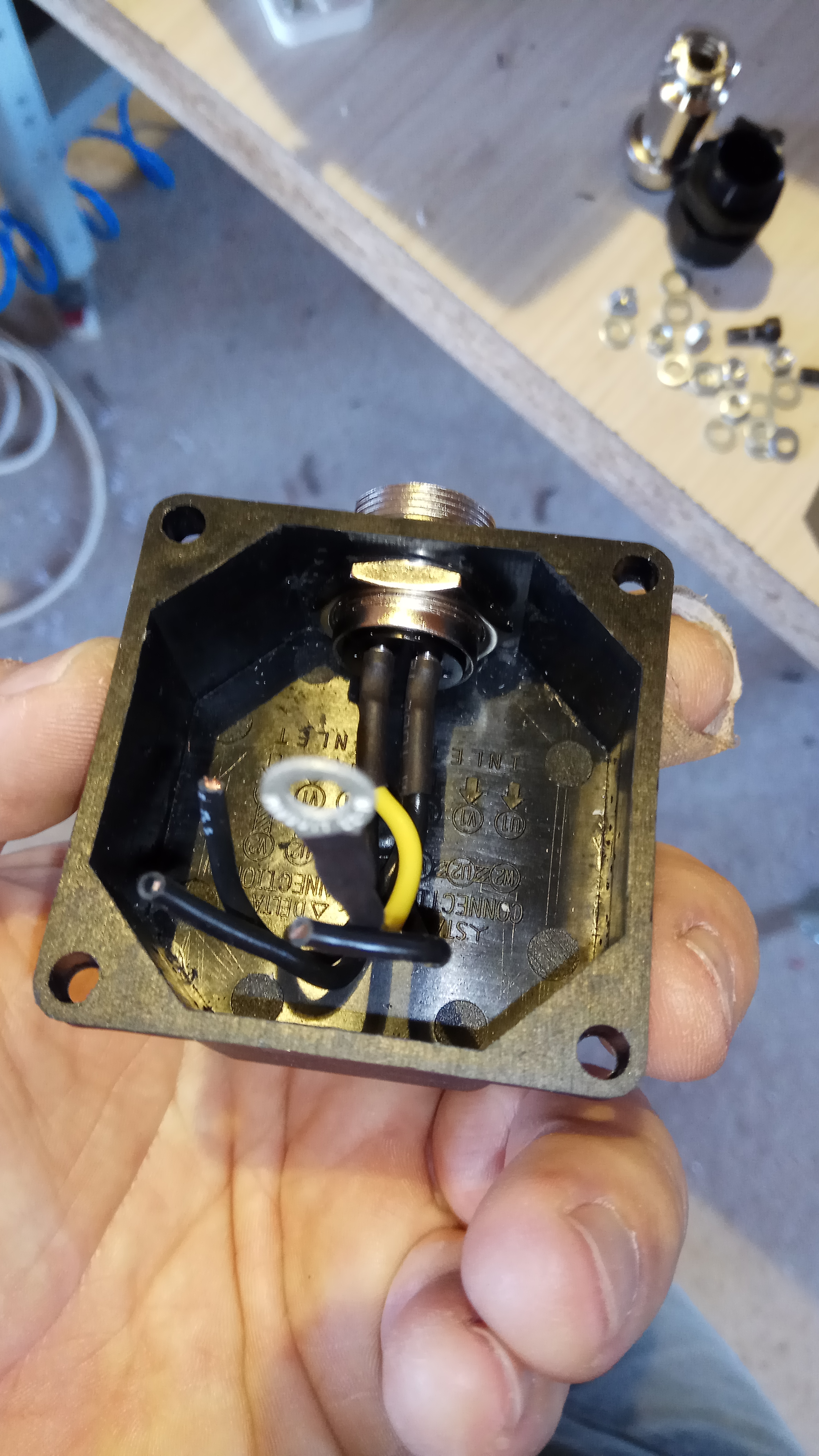

![IMG_20200506_110529](https://forum.sienci.com/uploads/default/original/1X/261e585b45e2ad97b97122406062c3712e3abaa5.jpeg)
Changing out the stock connection to an aviation plug.

![IMG_20200506_160534](https://forum.sienci.com/uploads/default/original/1X/ddae13c9313989203d941c8b587c1d539d60e004.jpeg)
Take out the stock wire mount and use one of its mounting holes to attach a ground wire. Some people trust that the mechanical connection from the motor to the CNC chassis, is good enough, but in our case we have all kinds of plastic parts in between.
