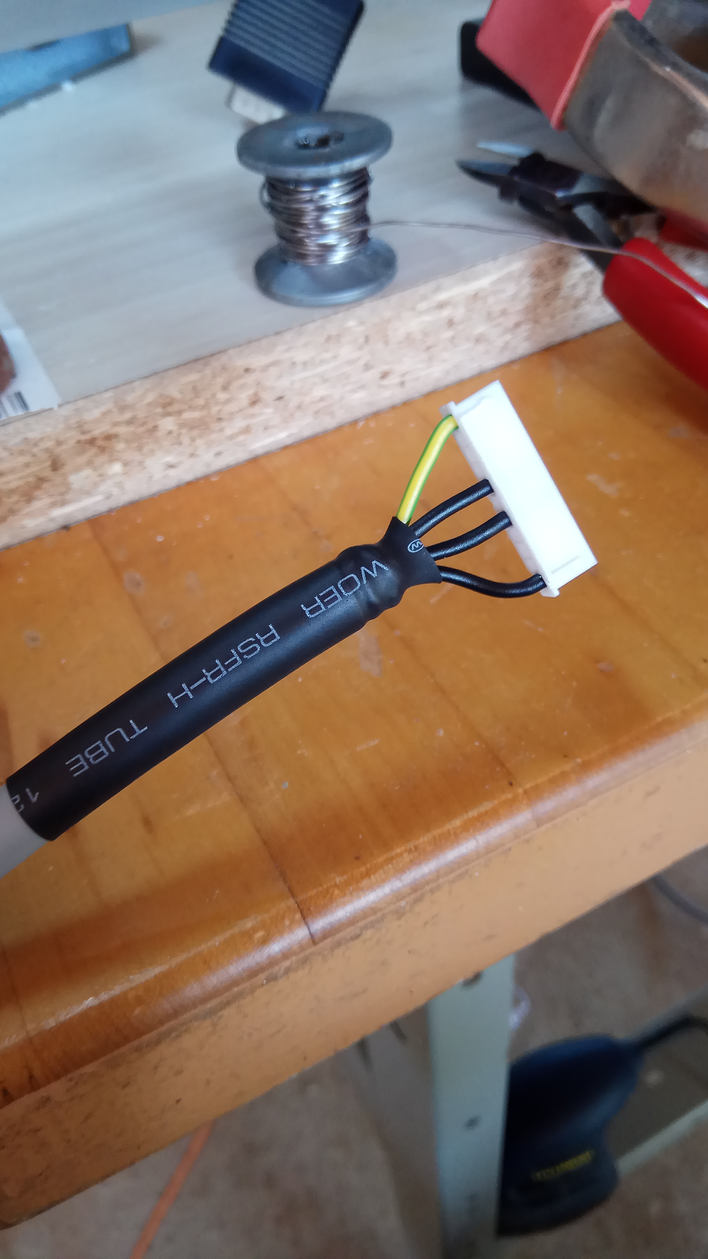

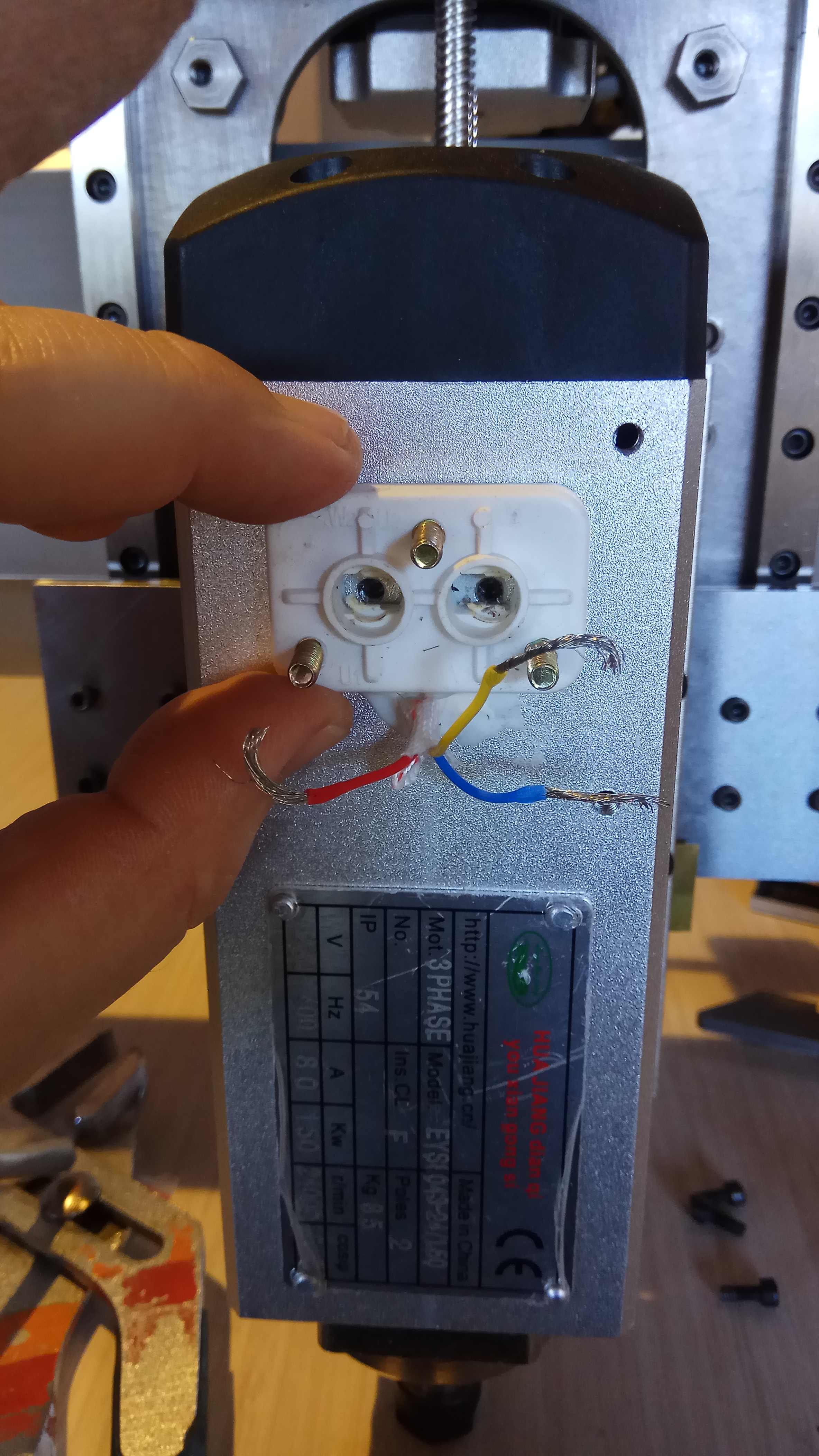

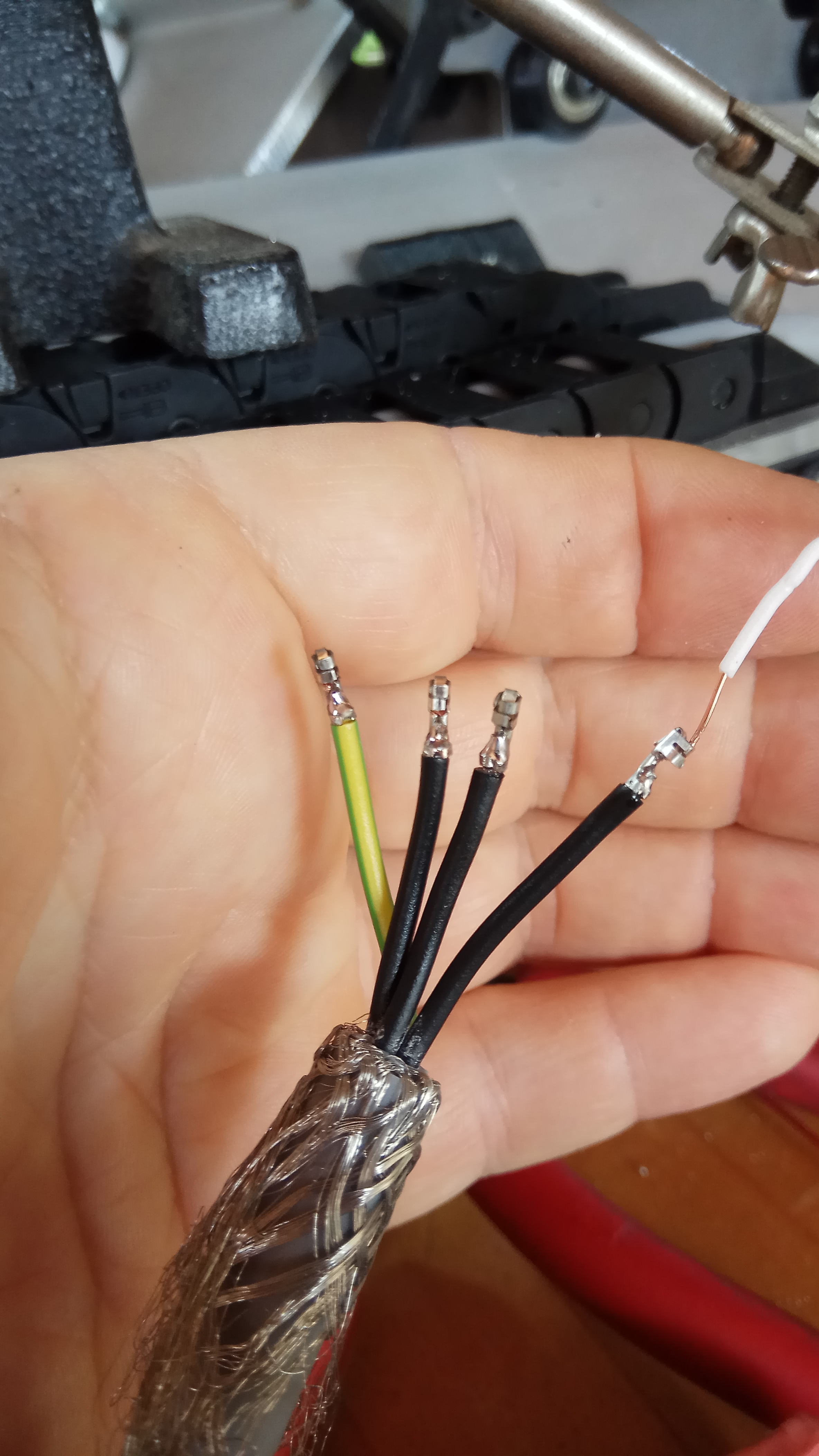

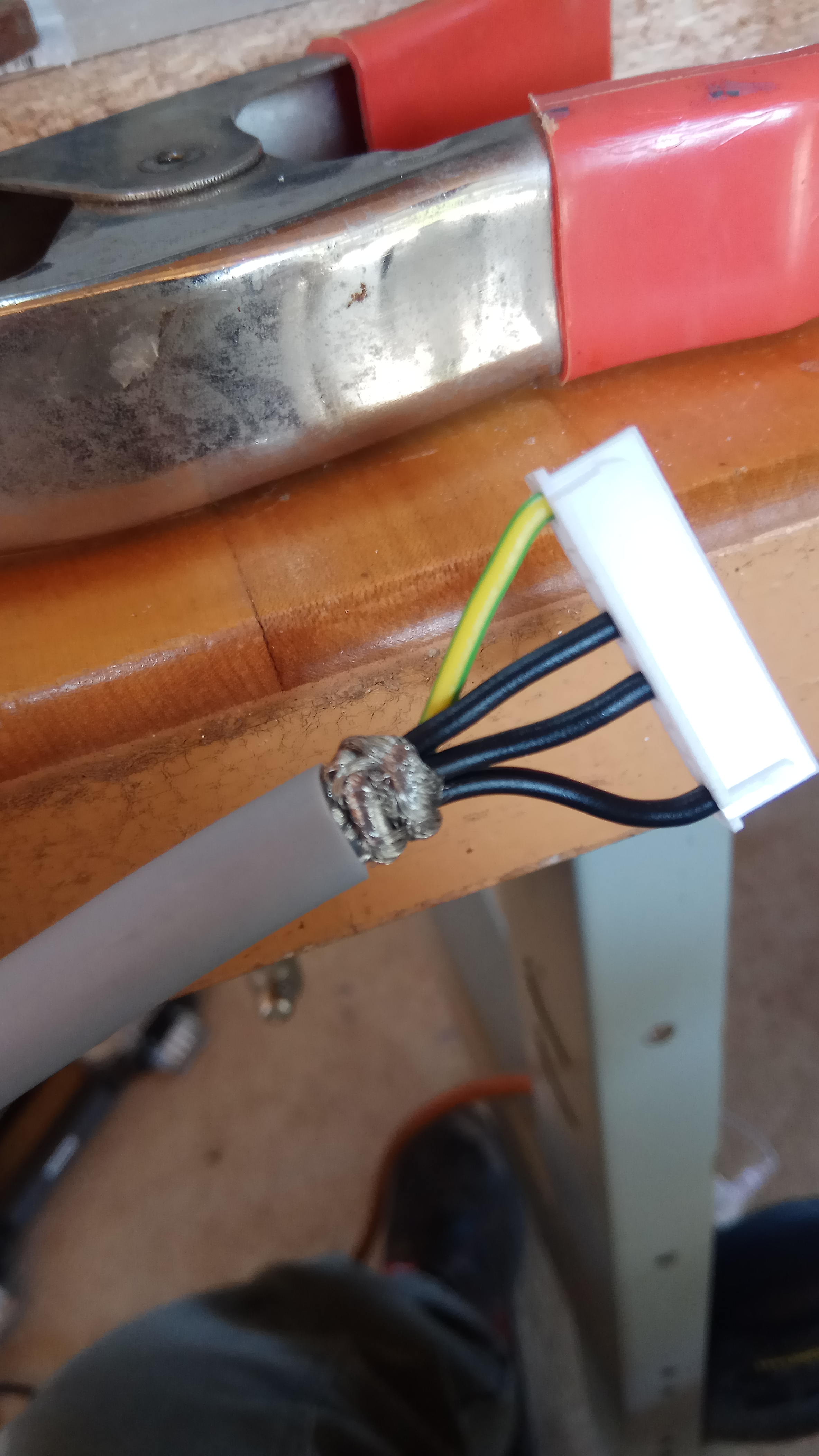

![IMG_20200506_162559](https://forum.sienci.com/uploads/default/original/1X/046c12cd585cdb33705eba1315a0690b0900ed75.jpeg)
**Author:** ![Hansi](https://forum.sienci.com/user_avatar/forum.sienci.com/hansi/32/216_2.png) [@Hansi](https://forum.sienci.com/u/Hansi)\
**Post date:** [May 8, 2020, 4:12pm UTC](https://forum.sienci.com/t/opensource-longmill-scratch-build/191/104 "2020-05-08T16:12:42Z")

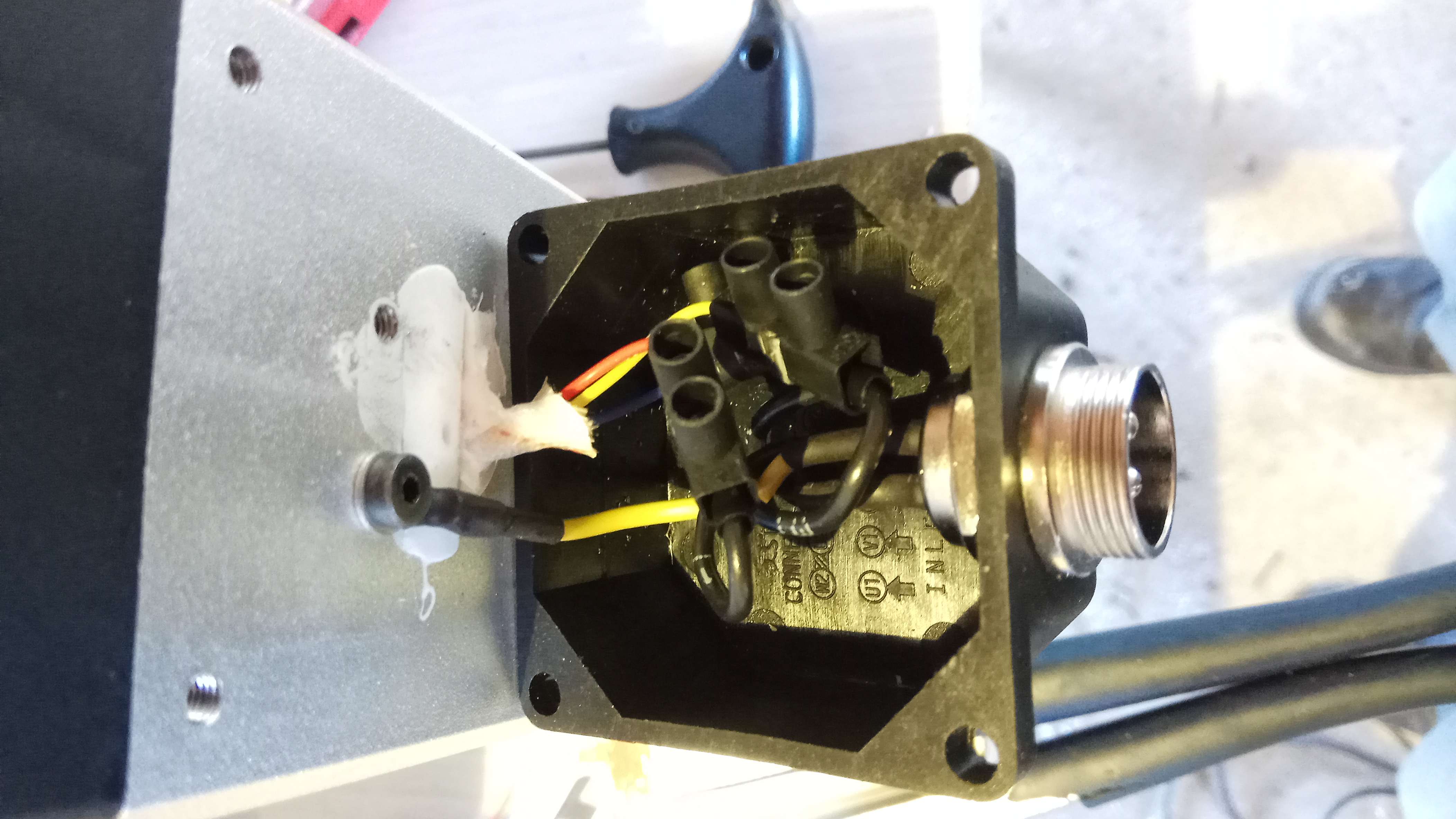

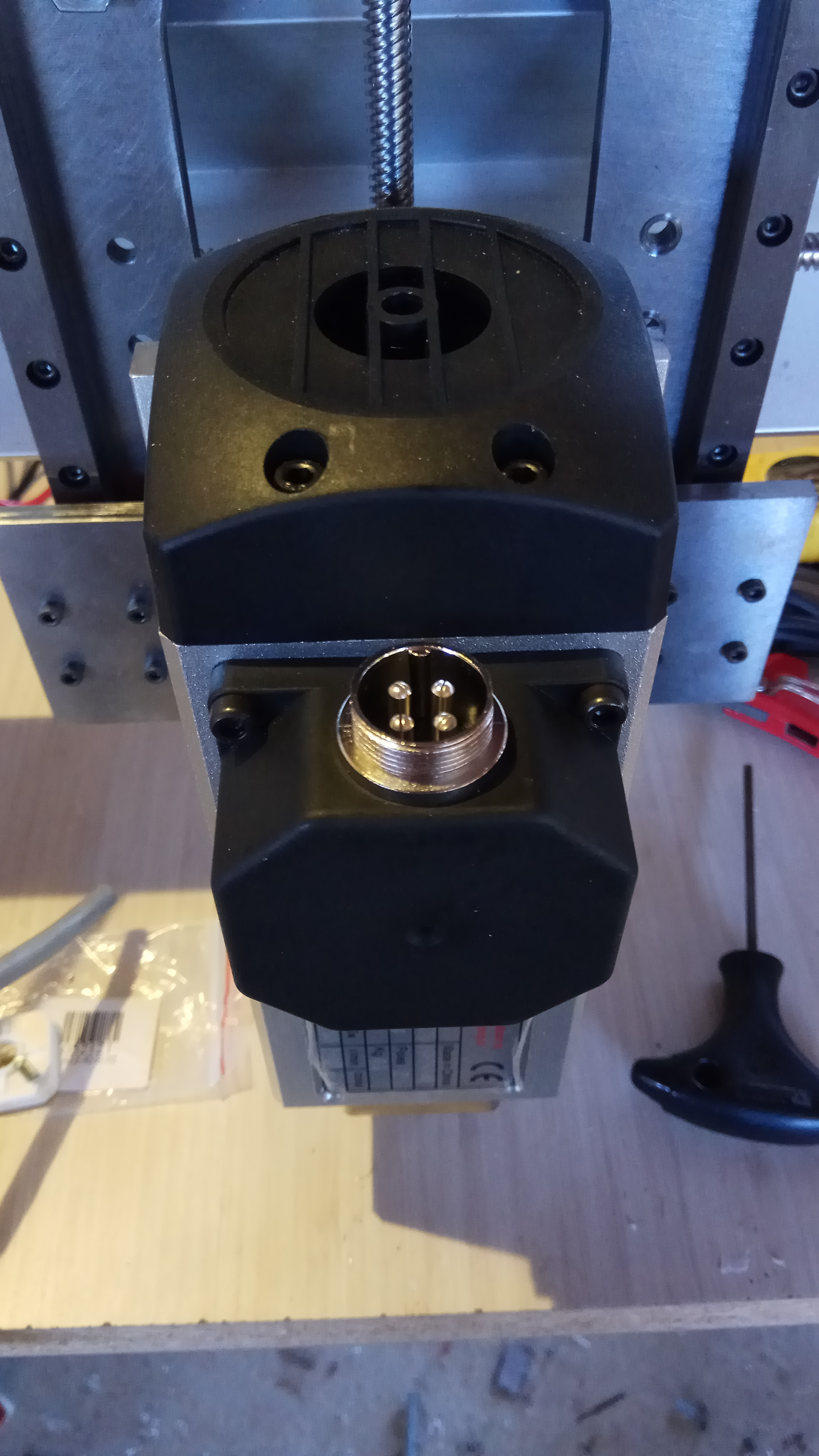

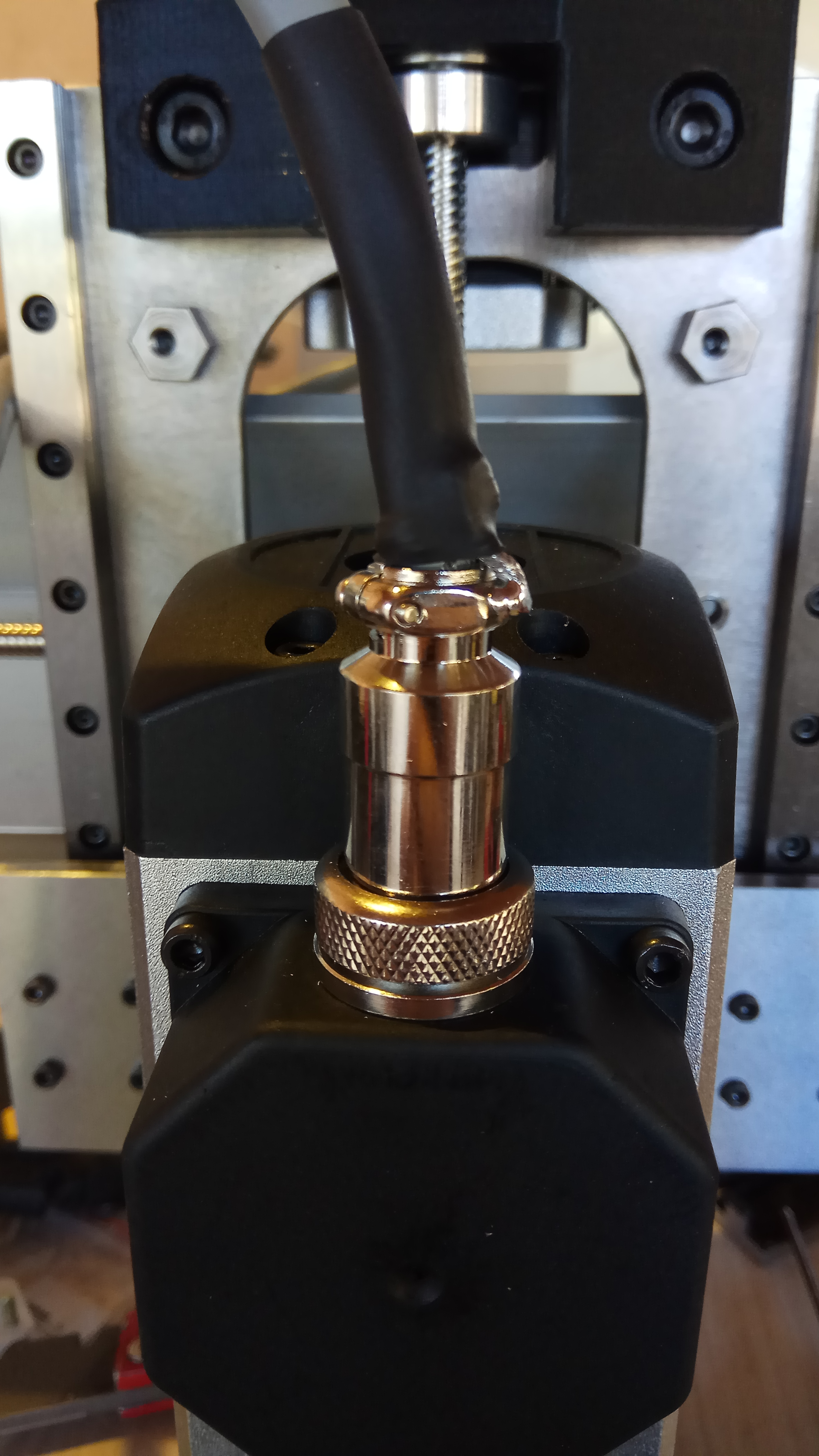

![IMG_20200506_170219](https://forum.sienci.com/uploads/default/original/1X/c6818cd1ca9cf520828cf59552bf9fb029c9f38a.jpeg)
Actually really nice plugs, and unbelievably DIRT CHEAP!
I’m familiar with Amphenol from industry, which these obviously aren’t, but well worth their couple bucks.
I should have ordered 5 pin, like I did on the steppers…I forgot about the shield, and brought it out to the plug housing.

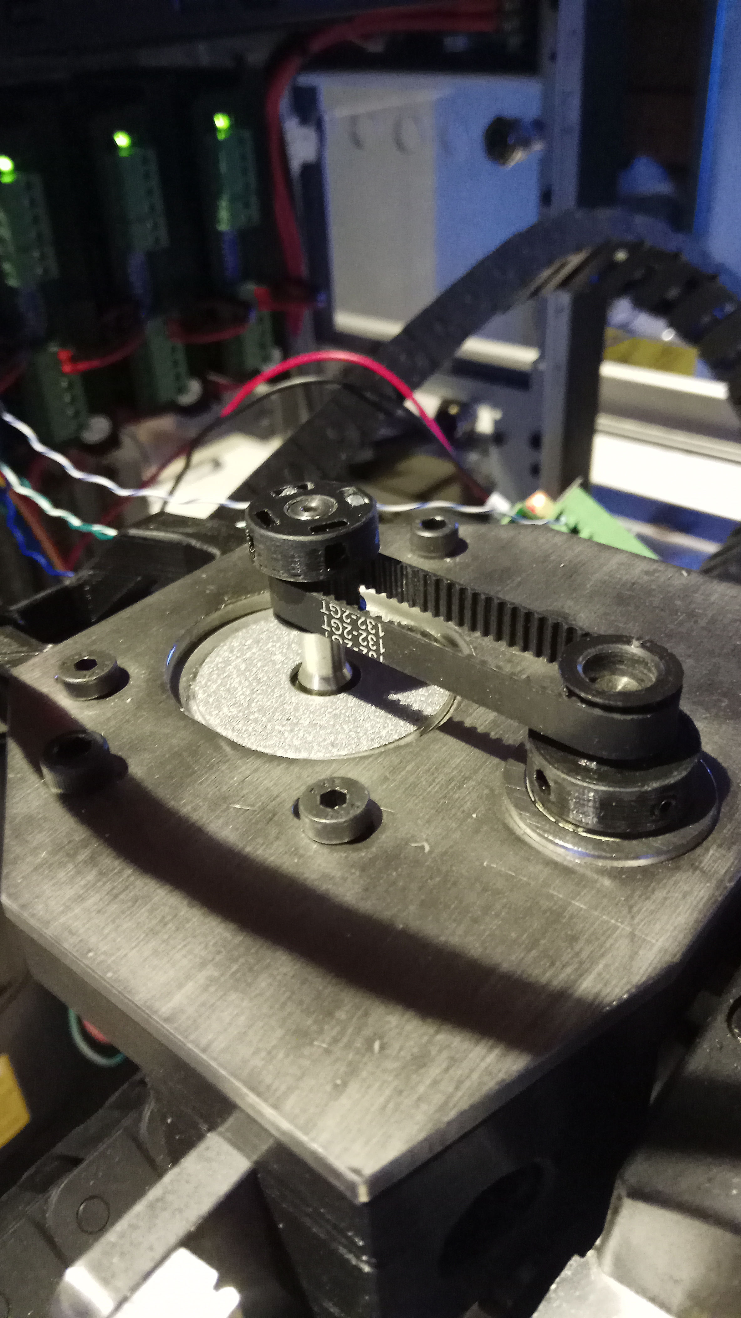

![IMG_20200508_192411](https://forum.sienci.com/uploads/default/original/1X/73e9768c3cb34b0ece9d26ae70001deab71ac1ca.jpeg)
I turned to thingiverse for some temporary GT2 pulleys, since what I ordered from AliExpress hasn’t arrived yet.
I printed several different designs, but this one definitely has the best gear/belt mate, out of those that I tried.
Recommended,

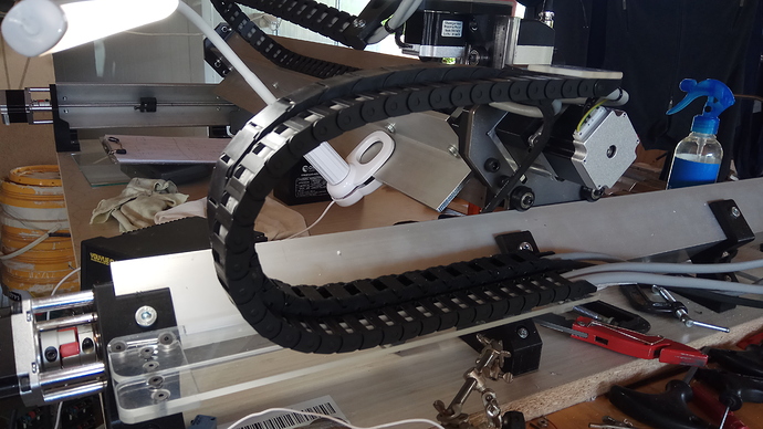

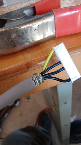

![IMG_20200511_083312](https://forum.sienci.com/uploads/default/original/1X/c1b0c9d63f3a469bbc7dbfc08c5fcc4ca3bc9d70.jpeg)
I didn’t like those small gauge motor wires that came with the JST plugs, so I extracted the crimps and soldered on directly with my 20 AWG.

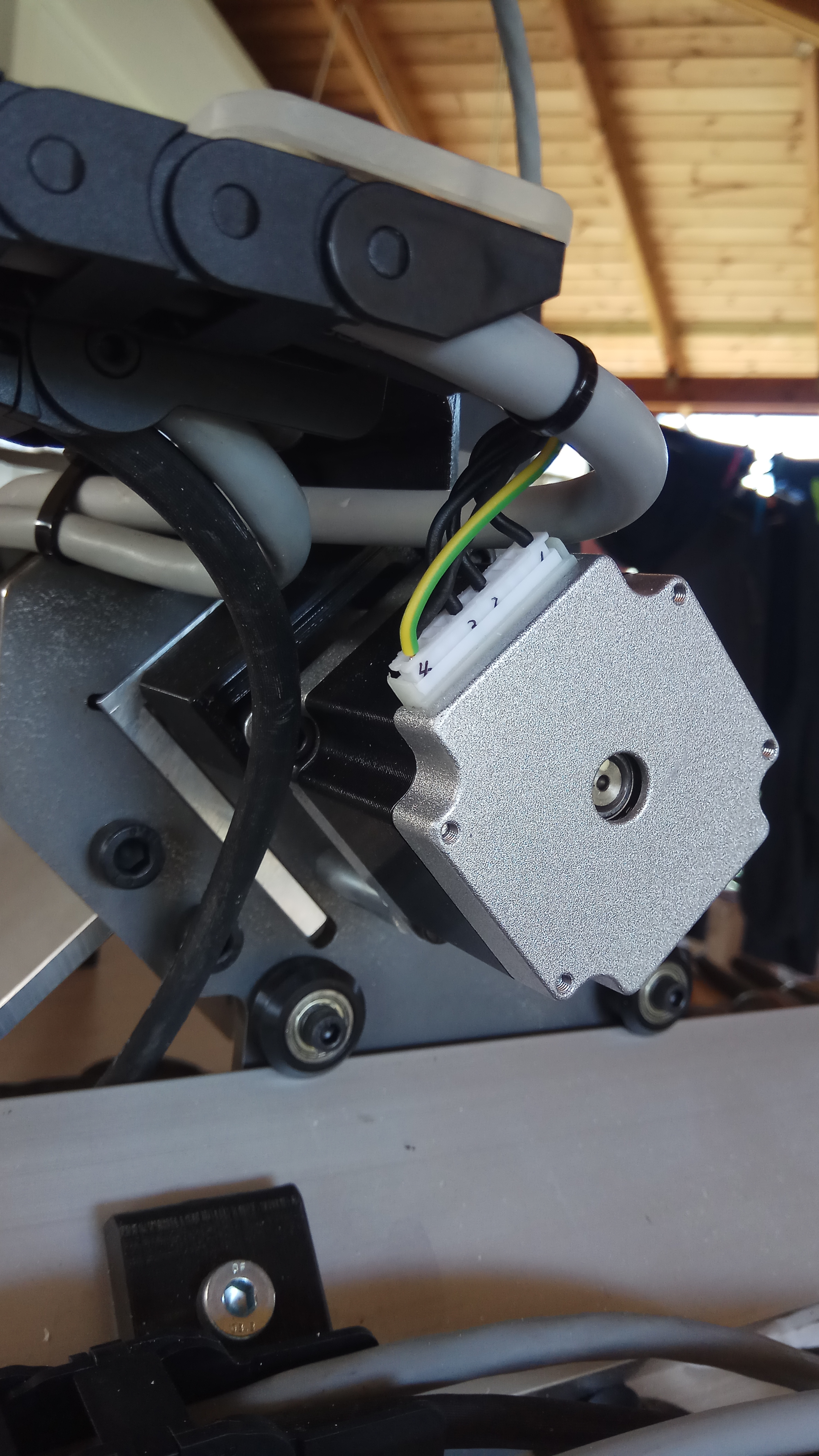

![IMG_20200511_083802](https://forum.sienci.com/uploads/default/original/1X/8ac1f8ace8442b23d7d95c90b6a1d0294403058c.jpeg) ![IMG_20200511_084001](https://forum.sienci.com/uploads/default/original/1X/77d375bef62e8e9c9518b25c343463c412b82bd2.jpeg) ![IMG_20200511_105305](https://forum.sienci.com/uploads/default/original/1X/7300fcebc6e5211933ae48f724380b406f267d4f.jpeg)

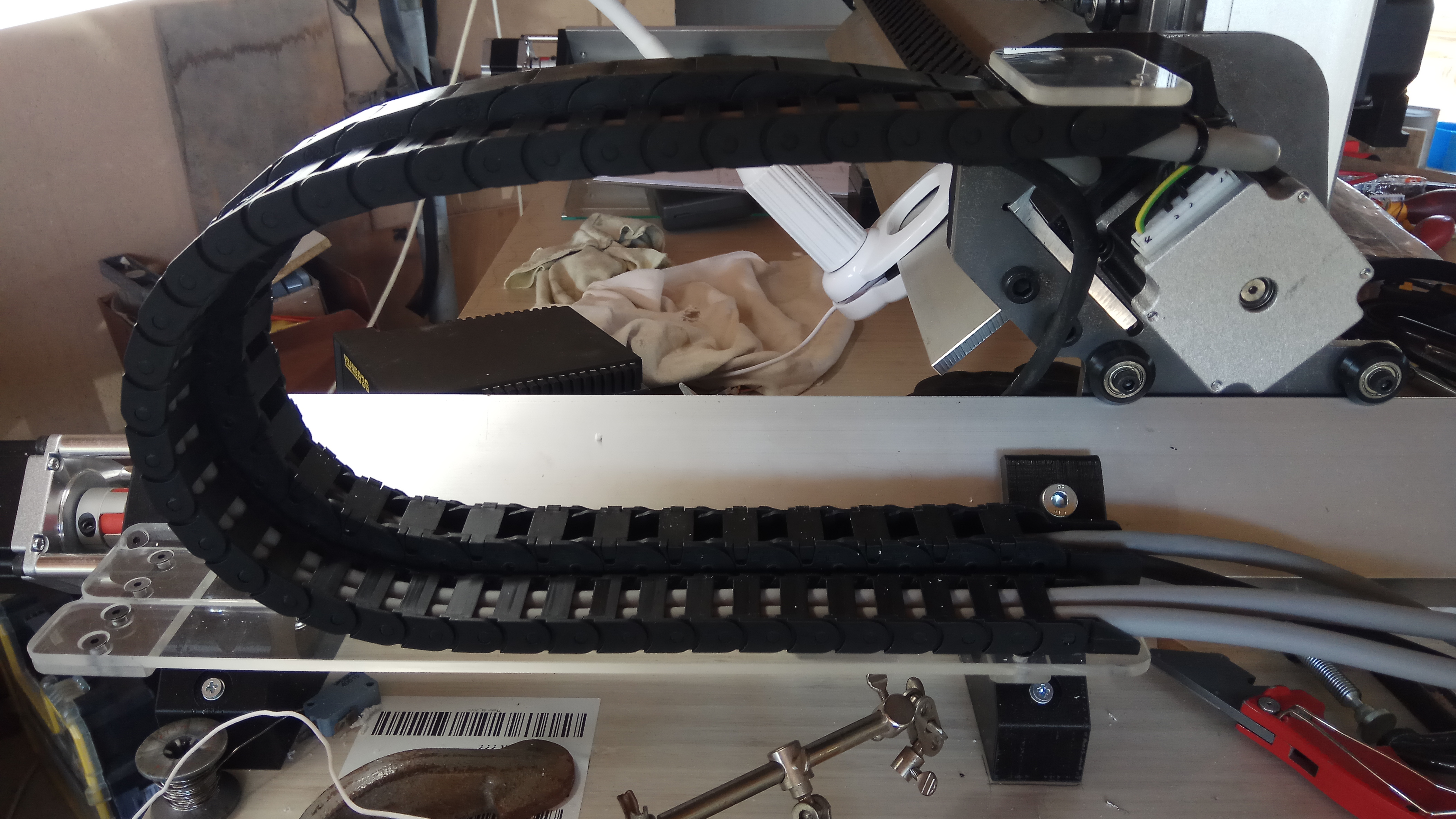

![IMG_20200511_105319](https://forum.sienci.com/uploads/default/original/1X/3d80fceffa0f7922cd32f3c0bca7d7e7803fa388.jpeg) ![IMG_20200511_105328](https://forum.sienci.com/uploads/default/original/1X/b5d9cec00fb186b3e31f64146f12056d8b550ad1.jpeg)
I had to add a second cable chain along the Y-axis because the motor cable that was available to me, was thicker than planned. Some of that energy chain cable has extra layers for higher flex rating.

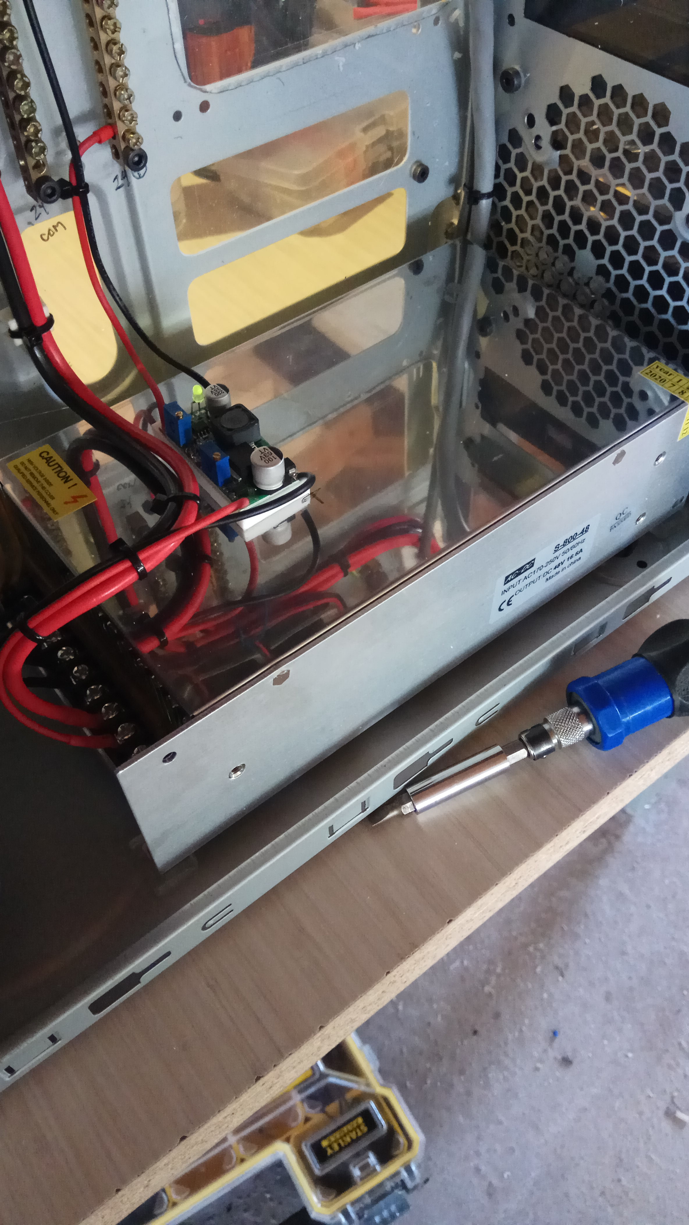

![IMG-20200507-WA0028](https://forum.sienci.com/uploads/default/original/1X/3415411b32916bcdfa35143583a6dadea565ccc6.jpeg)
My 48v supply with a DC/DC buck on top for 24v controller supply.

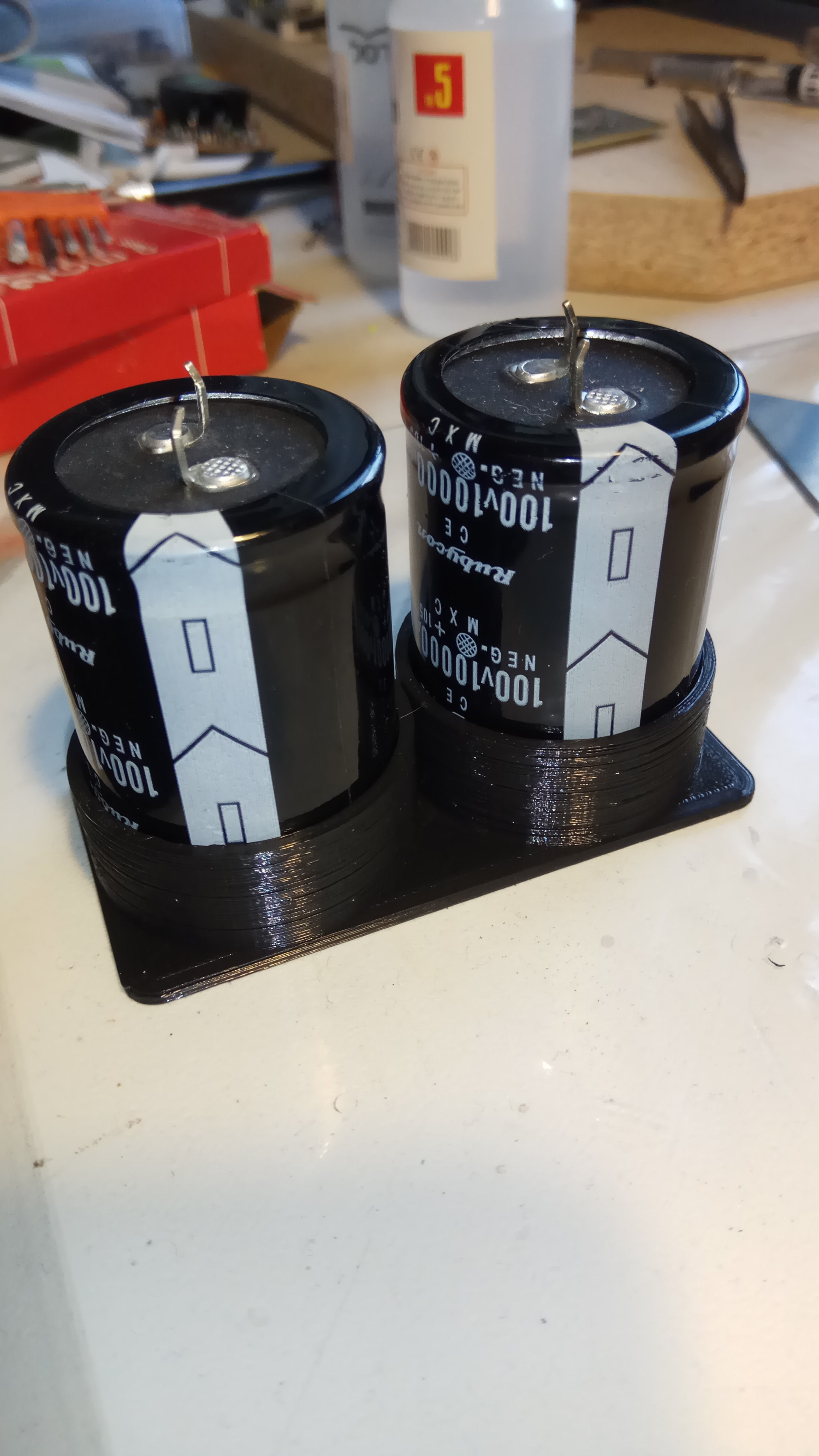

![IMG-20200514-WA0014](https://forum.sienci.com/uploads/default/original/1X/7996ace8b332795de028c294bfa6f0430cc22b28.jpeg)
Want to add these to the 48v, to absorb deceleration EMF.
