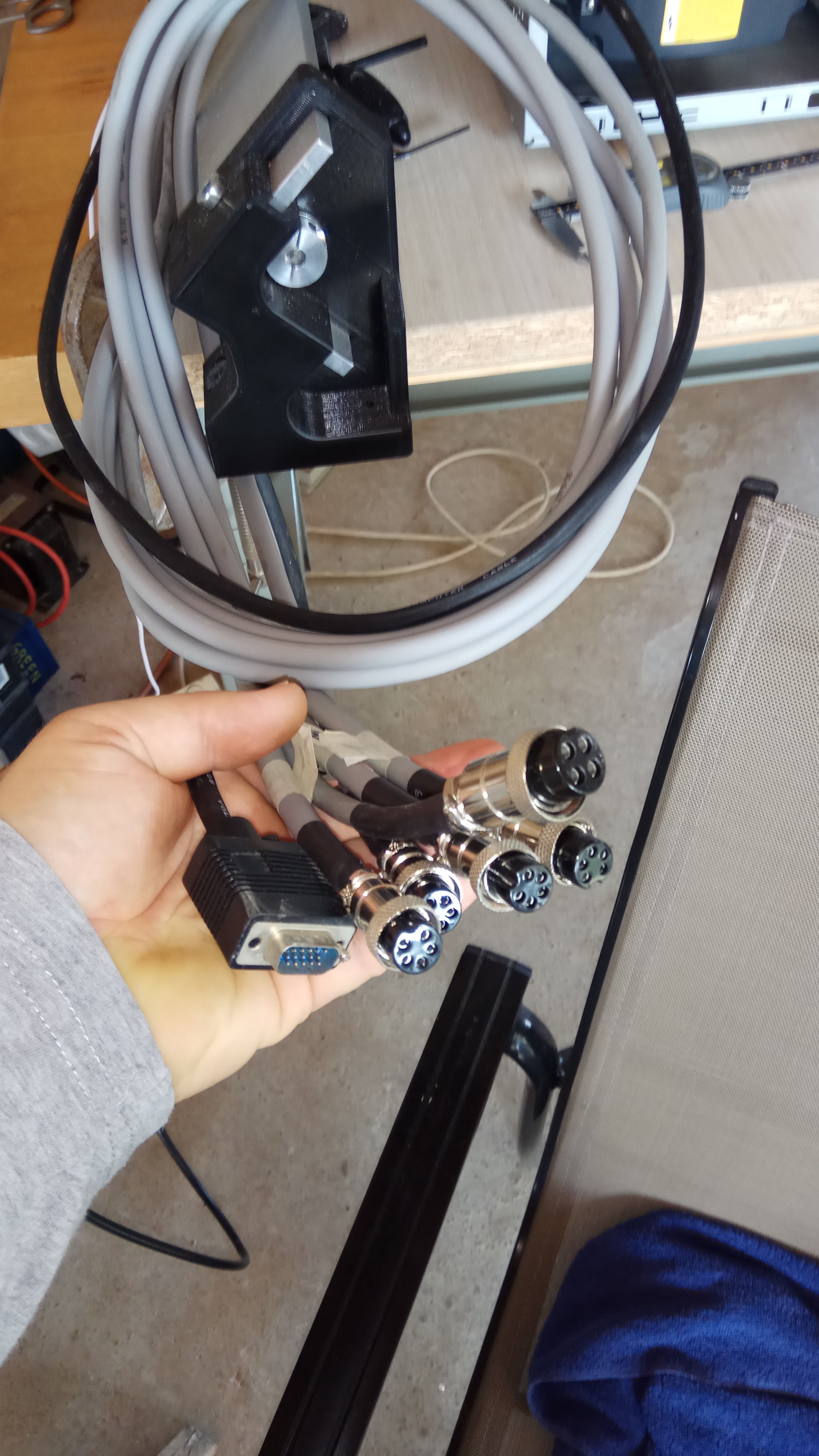

**Author:** ![Hansi](https://forum.sienci.com/user_avatar/forum.sienci.com/hansi/32/216_2.png) [@Hansi](https://forum.sienci.com/u/Hansi)\
**Post date:** [May 21, 2020, 6:12pm UTC](https://forum.sienci.com/t/opensource-longmill-scratch-build/191/123 "2020-05-21T18:12:44Z")
![IMG-20200514-WA0003](https://forum.sienci.com/uploads/default/original/1X/6b570d20f503d051fb8ca1e043ef4877ddebcdd3.jpeg)
Cable harnesses

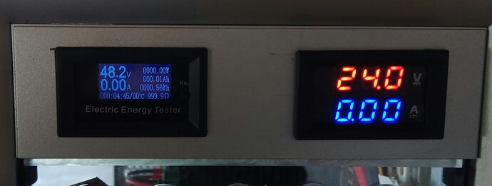

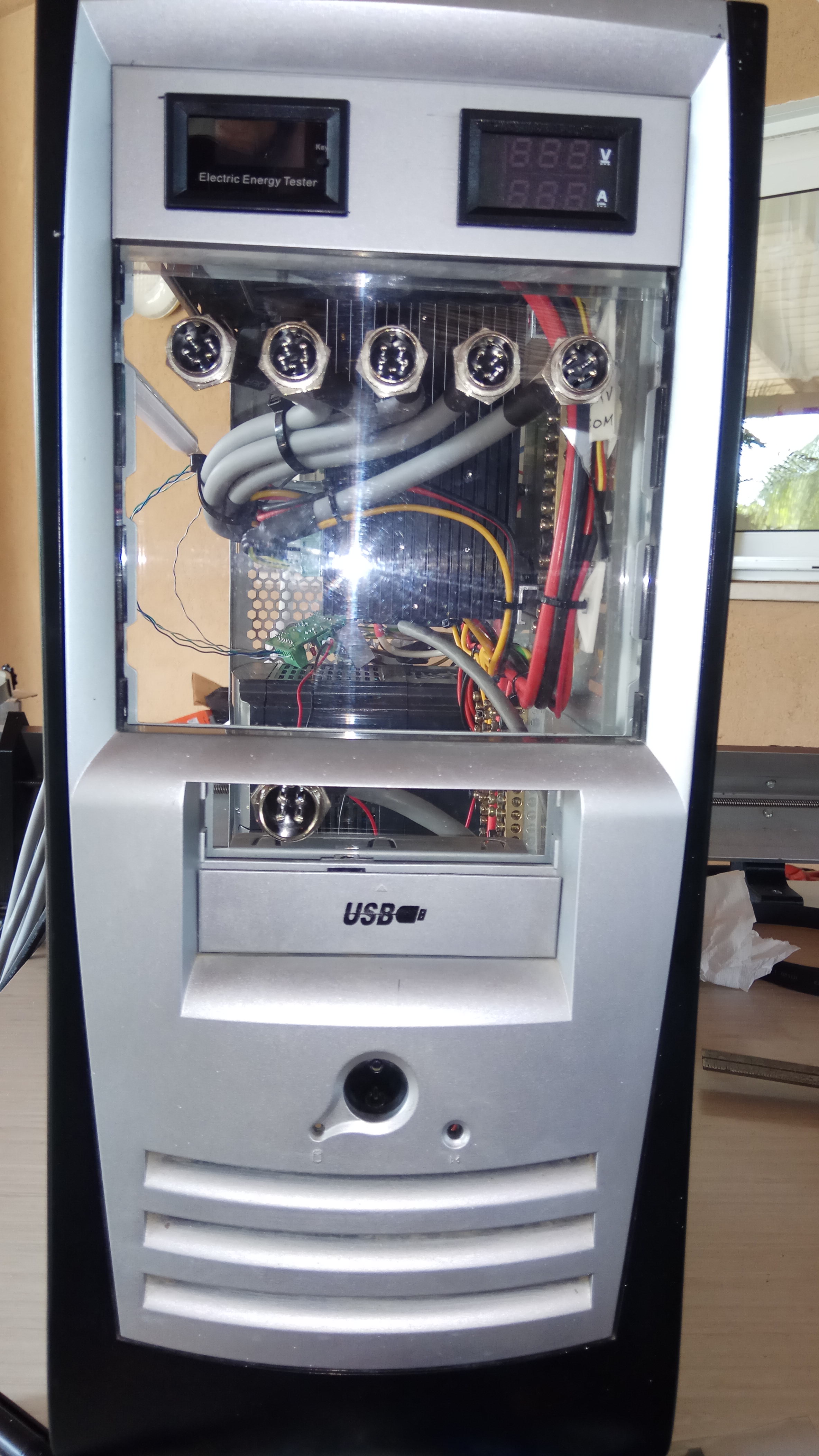

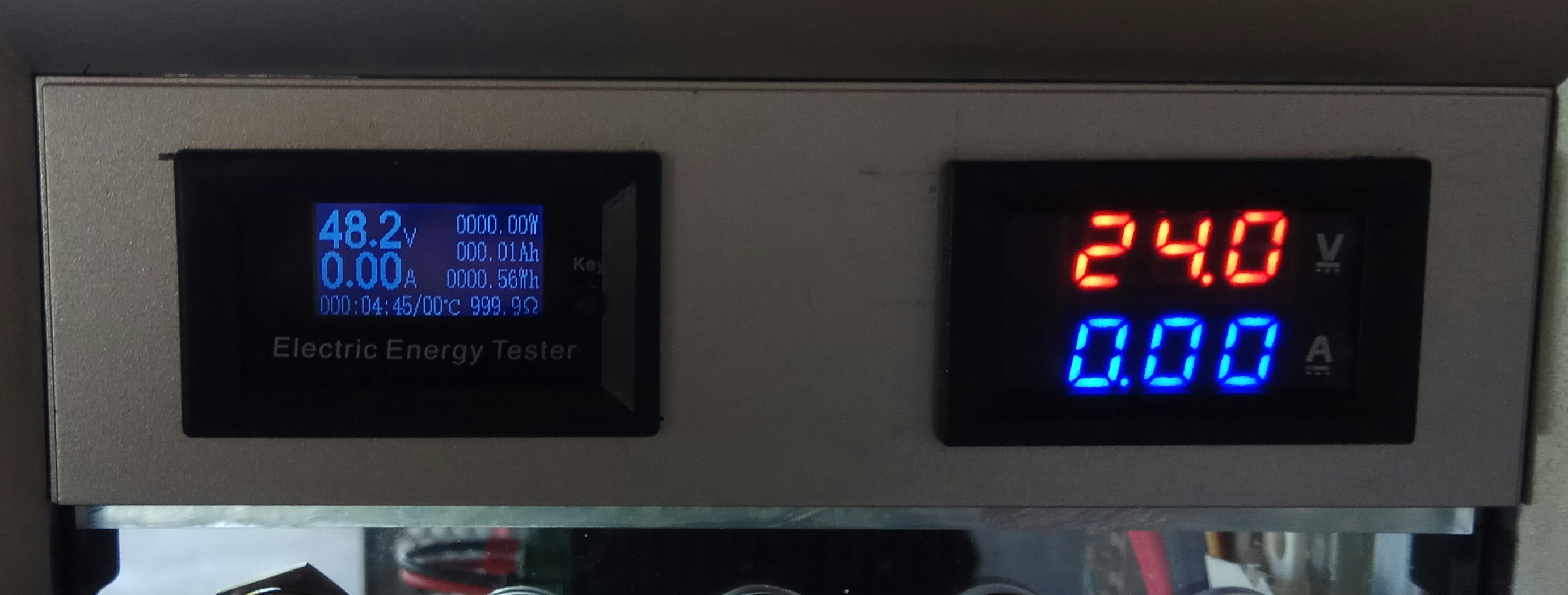

**Post date:** [May 21, 2020, 6:18pm UTC](https://forum.sienci.com/t/opensource-longmill-scratch-build/191/125 "2020-05-21T18:18:24Z")
![IMG_20200521_211443](https://forum.sienci.com/uploads/default/original/1X/935fc190a35266a48e8724df27fe76b119e4bcc4.jpeg)
Power meters… The 48v meter is REALLY small, but it has a lot of features. I tried that one, because it has real screw terminals to handle 20amps.
The 24v meter is good for 10amps and has only JST plugs.

**Author:** ![jwoody18](https://forum.sienci.com/letter_avatar_proxy/v4/letter/j/4bbf92/32.png) [@jwoody18](https://forum.sienci.com/u/jwoody18)\
**Post date:** [June 15, 2020, 5:07pm UTC](https://forum.sienci.com/t/opensource-longmill-scratch-build/191/128 "2020-06-15T17:07:51Z")
I really like the ATX case idea to house the various electronics. Now that I’ve added the sensors and related wiring and the relay board in between, I’m wondering how to wrangle it all in to a safe and manageable place. This is a great solution. Did you just drill holes where required or did you adapt to standard mounting formats found inside a PC?
**Post date:** [June 16, 2020, 7:31pm UTC](https://forum.sienci.com/t/opensource-longmill-scratch-build/191/129 "2020-06-16T19:31:26Z")
In place of the motherboard, I put in a piece of lexan, Plexi glass, acrylic or whatever you have available. This way you can drill and tap mounting holes whenever you like… Actually very convenient. Just like panel building.
**Post date:** [June 16, 2020, 10:39pm UTC](https://forum.sienci.com/t/opensource-longmill-scratch-build/191/130 "2020-06-16T22:39:12Z")
Great idea. I need to pick some up.
**Post date:** [June 17, 2020, 1:11pm UTC](https://forum.sienci.com/t/opensource-longmill-scratch-build/191/131 "2020-06-17T13:11:44Z")
You can use anything you find… Some guys have used this plywood too.

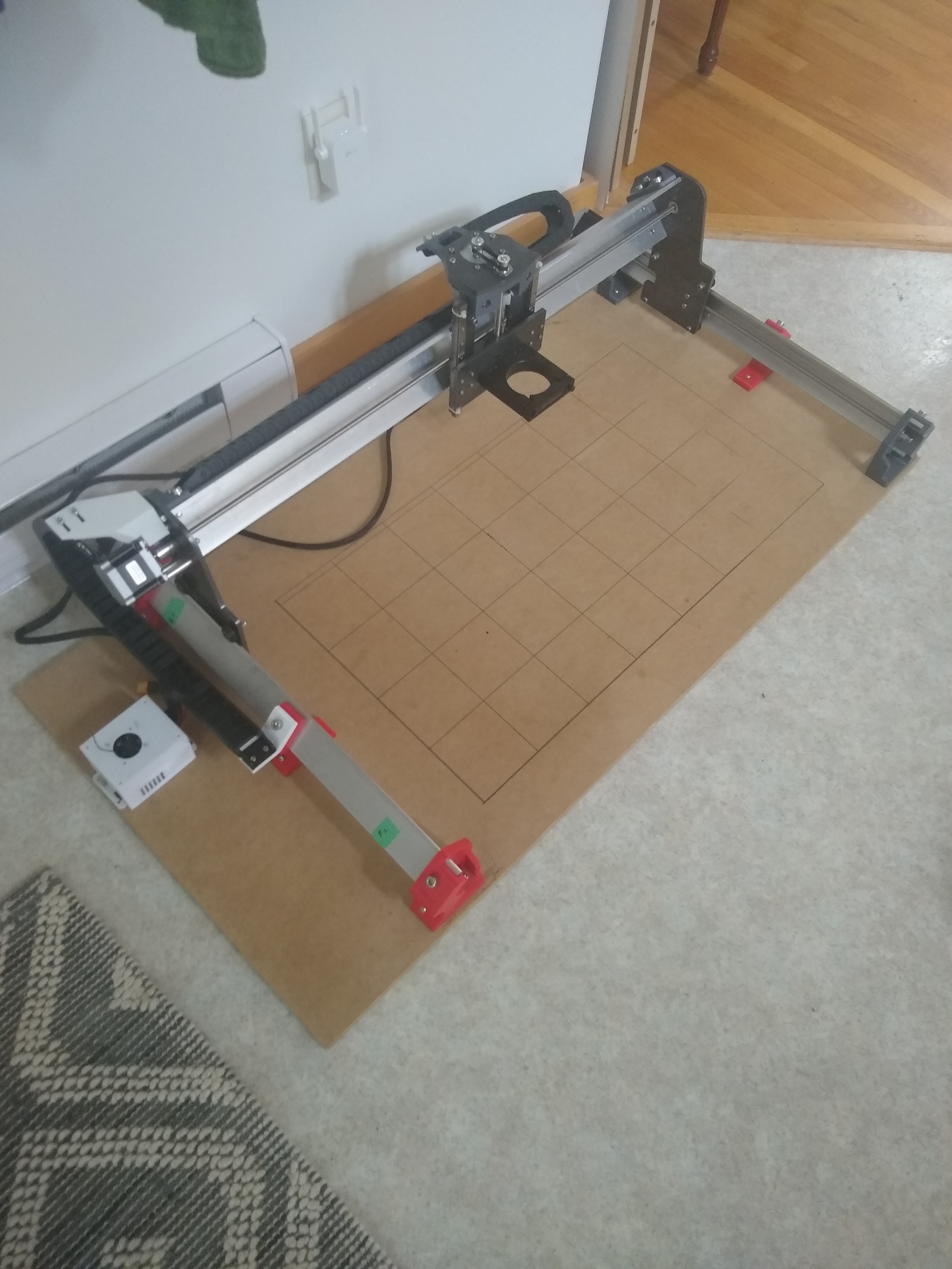

**Author:** ![frankchannel](https://forum.sienci.com/user_avatar/forum.sienci.com/frankchannel/32/364_2.png) [@frankchannel](https://forum.sienci.com/u/frankchannel)\
**Post date:** [July 26, 2020, 5:23pm UTC](https://forum.sienci.com/t/opensource-longmill-scratch-build/191/132 "2020-07-26T17:23:58Z")
There’s my scratch build, 30"x16" cutting area:
 ![IMG_20200726_145222189](https://forum.sienci.com/uploads/default/original/1X/c5068ab4bf38ce2ce71d350952b1f963df03eb4d.jpeg)
**Post date:** [July 26, 2020, 8:39pm UTC](https://forum.sienci.com/t/opensource-longmill-scratch-build/191/133 "2020-07-26T20:39:04Z")
Oh yes! Very nice!
Glad to see somebody else hit the scratch build road, 👍👍👏
