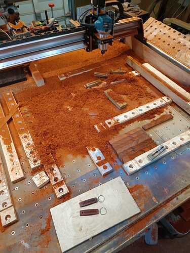

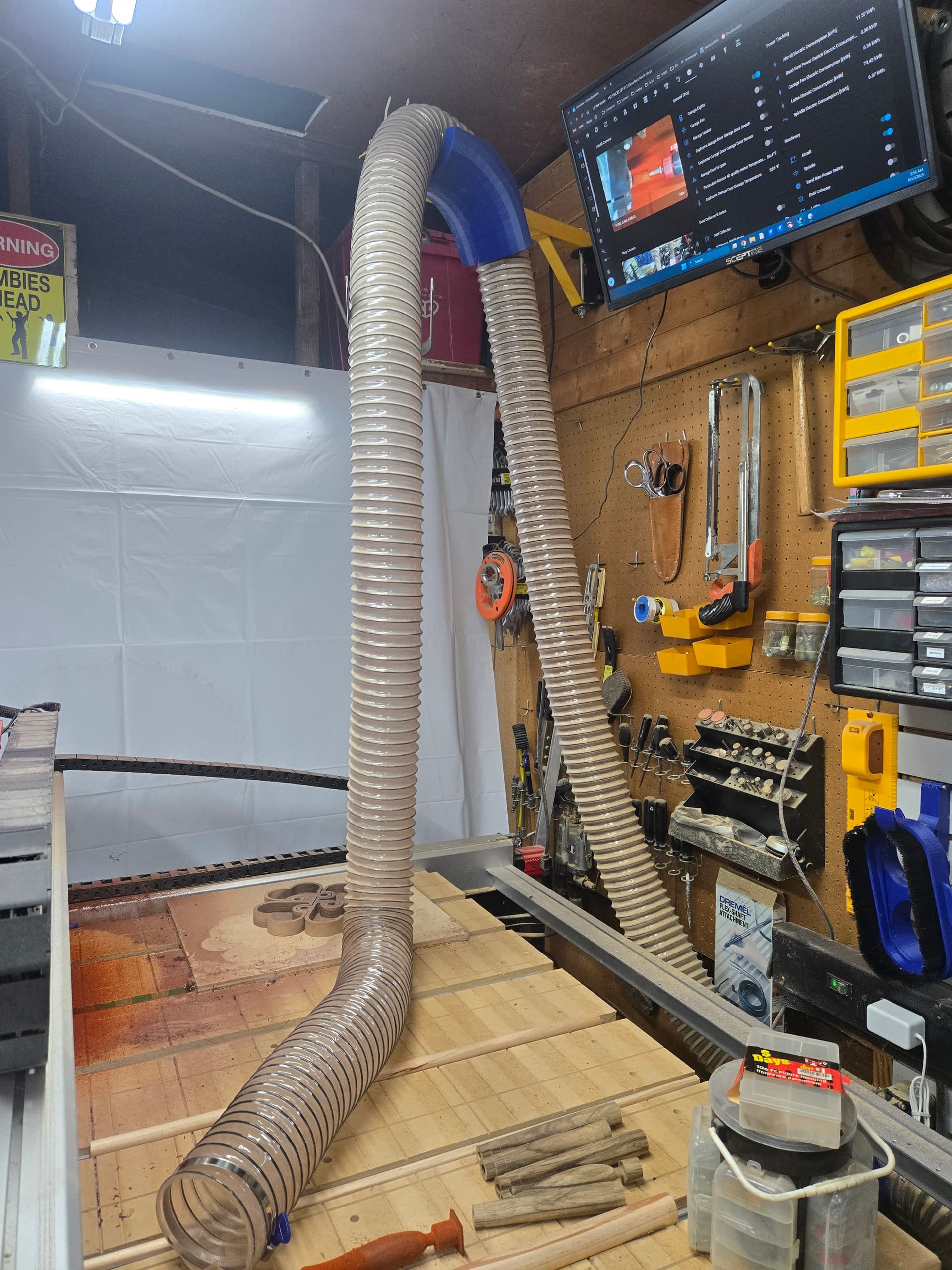

Oke, let me start of by showing the largest en most expensive dust collection you will find on this entire forum. It’s mostly made out of a wonderfull red colored African Padouk mixed with a wee light brownish Azobé for contrast. The dust collection has been building for several projects, so please don’t think it is the product of those two lovely key chains at the bottom of the machine bed. They’re mere proto types made out of waste padouk from a larger sign that sourced my jalous making dust collection.
 ![Afbeelding van WhatsApp op 2025-08-12 om 14.53.48_e9e325c5](https://forum.sienci.com/uploads/default/original/2X/e/e494850e61b91b67c4d34ed7a7509a3128547c66.jpeg)
Not easy to top that out, ey?

lol…that’s nice. I’m looking for something less expensive though!

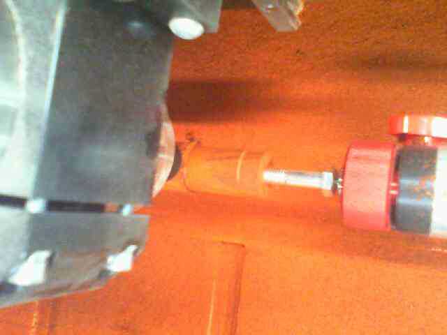

More Padouk - I don’t have my dust collection system configured for when I am using the Vortex
 ![snapshot_camera_wwe_cam_altmill_8_12_2025, 9_53_16 AM](https://forum.sienci.com/uploads/default/original/2X/b/b97b0f790c183f9b1b5dccd99430eb93a0044a5c.jpeg)

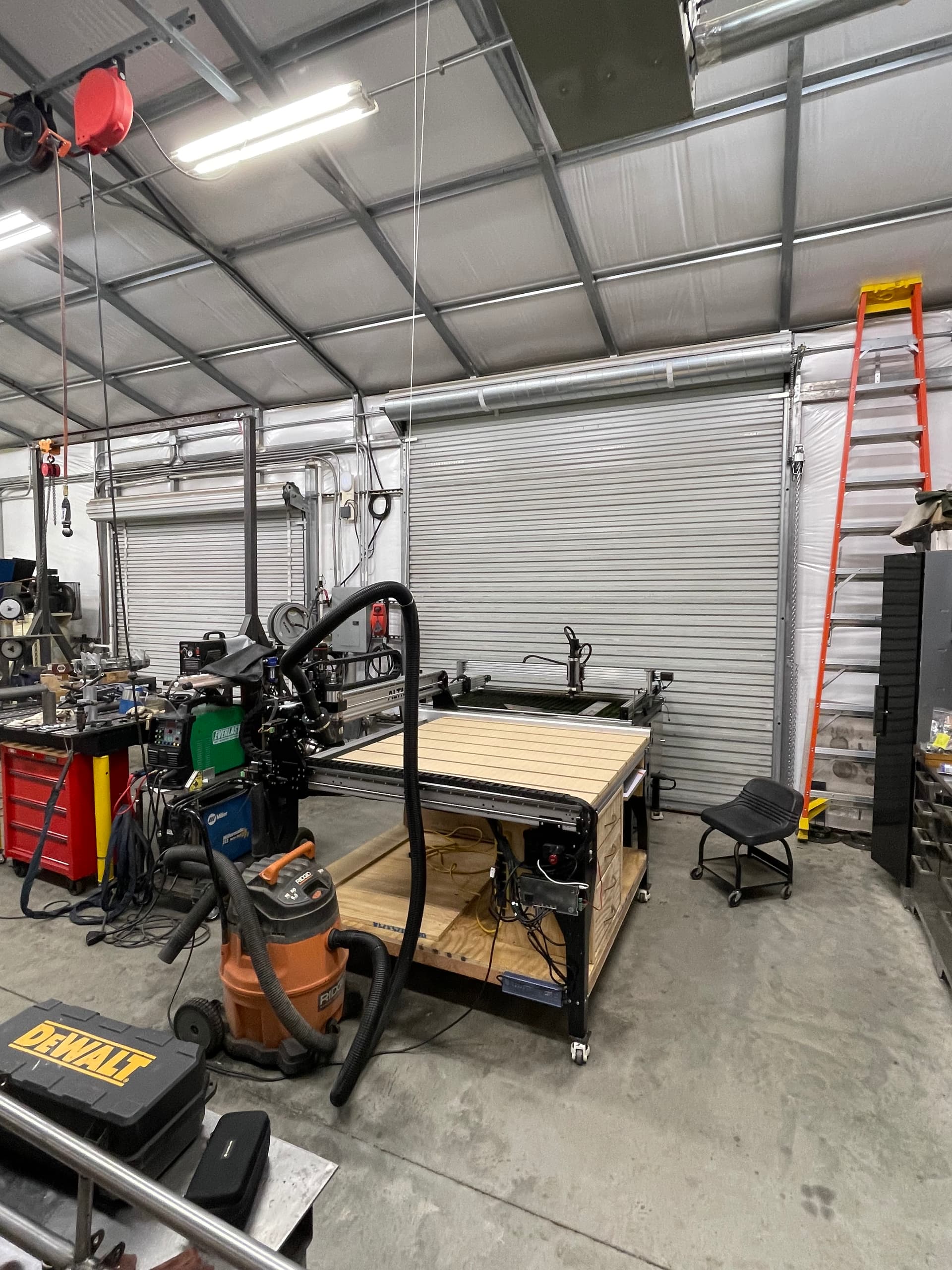

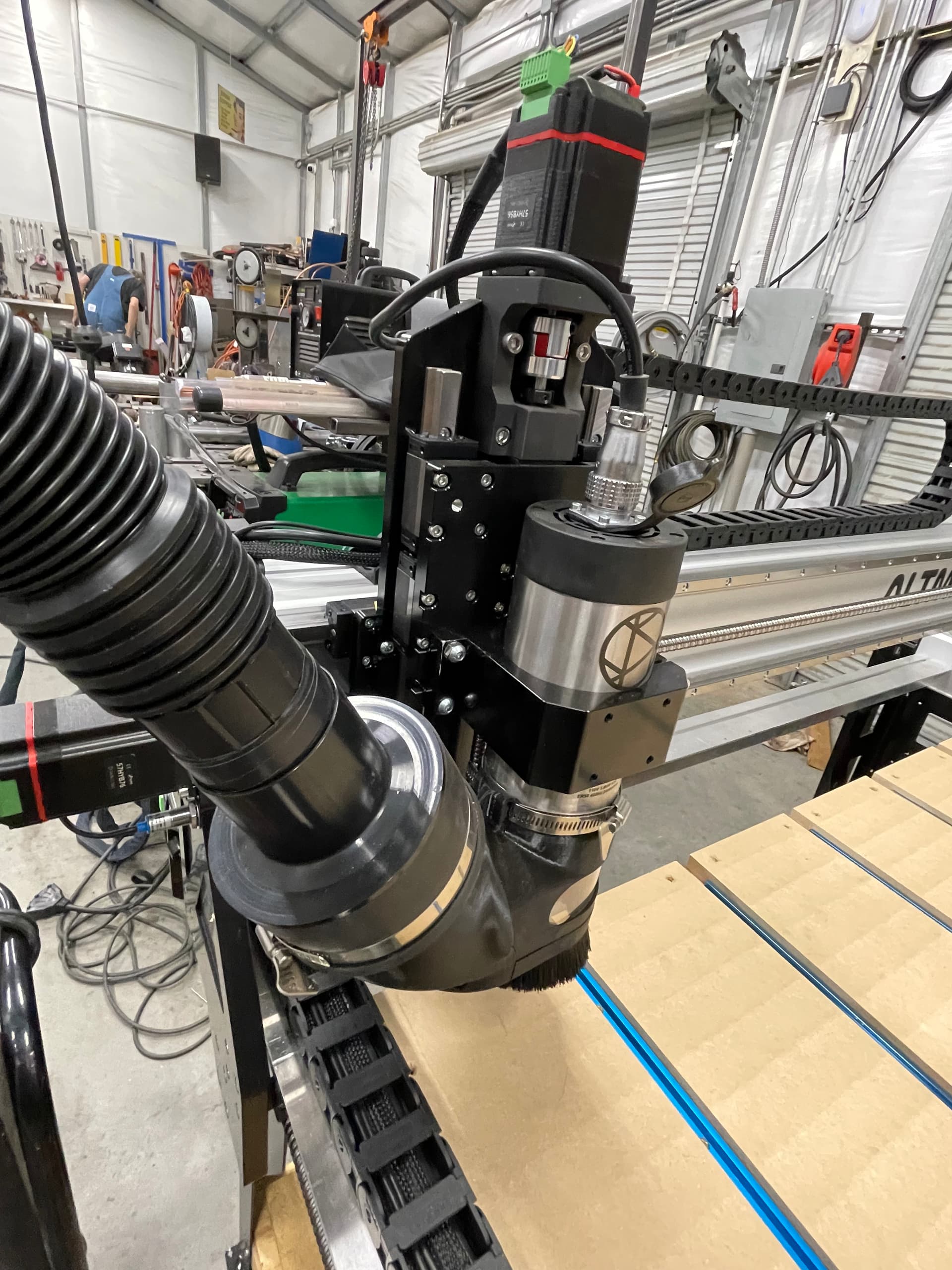

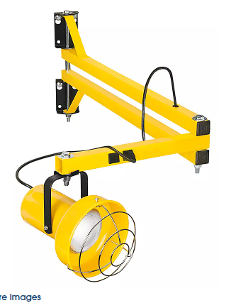

I am running 4” flex from my Jet Dust Collector… I have motorized ball-valves at each piece of machinery.
For the AltMill in particular, I used an old warehouse dock-door light fixture that swivels on the wall and can be moved into various positions. I added a 3D-printed curve to maintain better air-flow.
But it swivels on the wall to follow the spindle.
Can’t see it well but it’s the yellow thing up high
 ![20250812_095631](https://forum.sienci.com/uploads/default/original/2X/8/869945b8b0719032e4453df995a69ed5a2ae96b2.jpeg)
 ![image](https://forum.sienci.com/uploads/default/original/2X/6/6abc85825a93231ebac470279709181cd53c22c3.png)

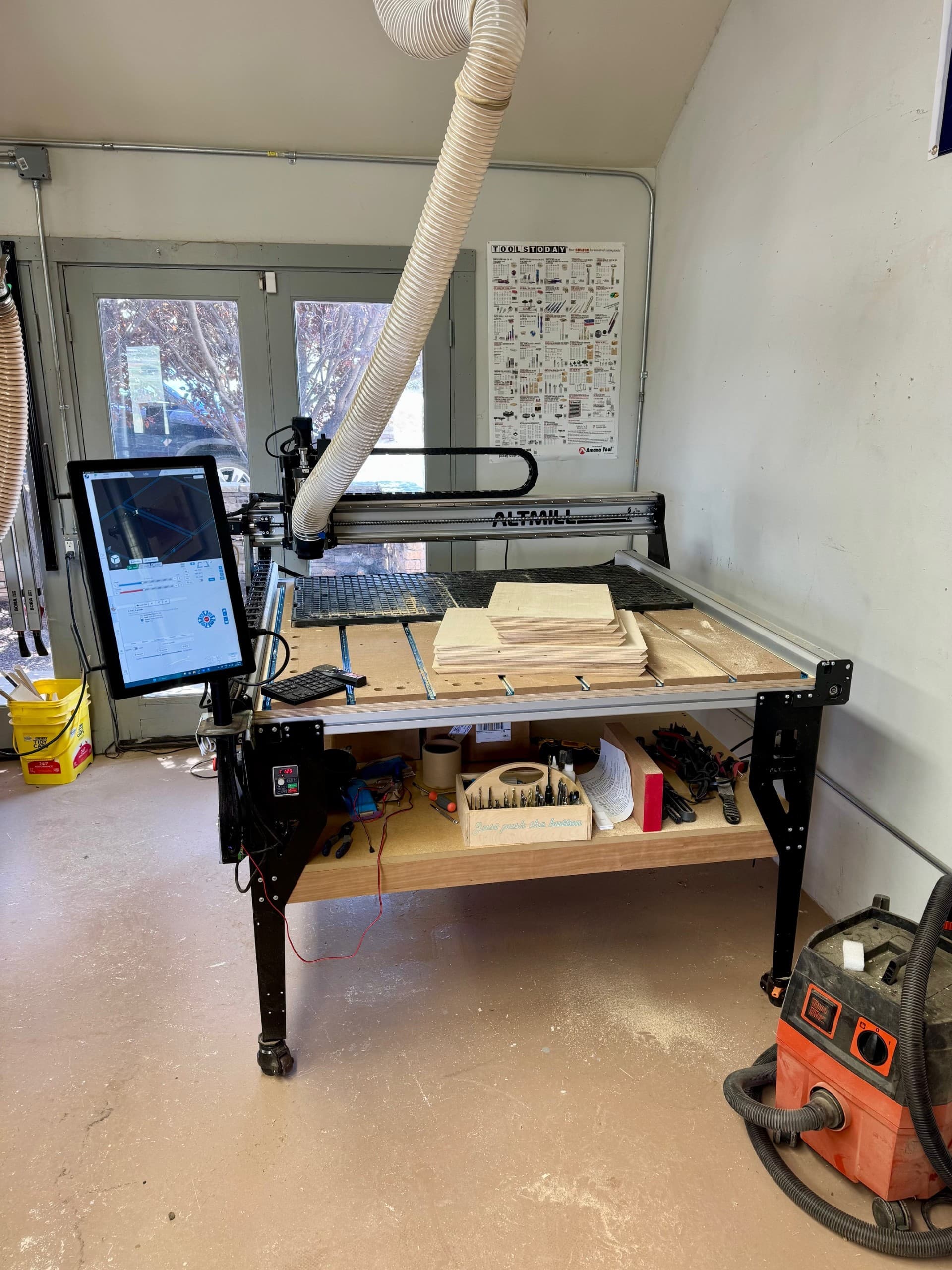

On a square table like a 4 x 4 it isn’t necessary to have a swing arm if you can locate the port near the center of the work area. A little slack can be built in using a simple bungee cord that allows it to reach the corners without sagging.
 ![DC](https://forum.sienci.com/uploads/default/original/2X/f/f5f5df2e55211d0d8f9af24d655024c86ea021dc.jpeg)
With a 4 x 8 or larger work area, then yes, a swing arm comes into play.

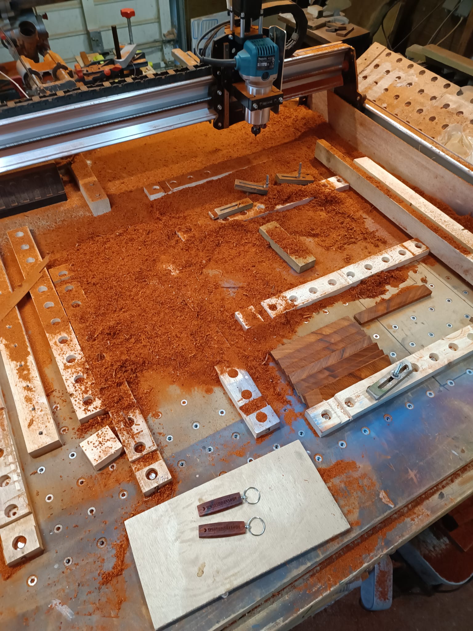

Is this any better?
Doing a couple of small miter fold cabinets.

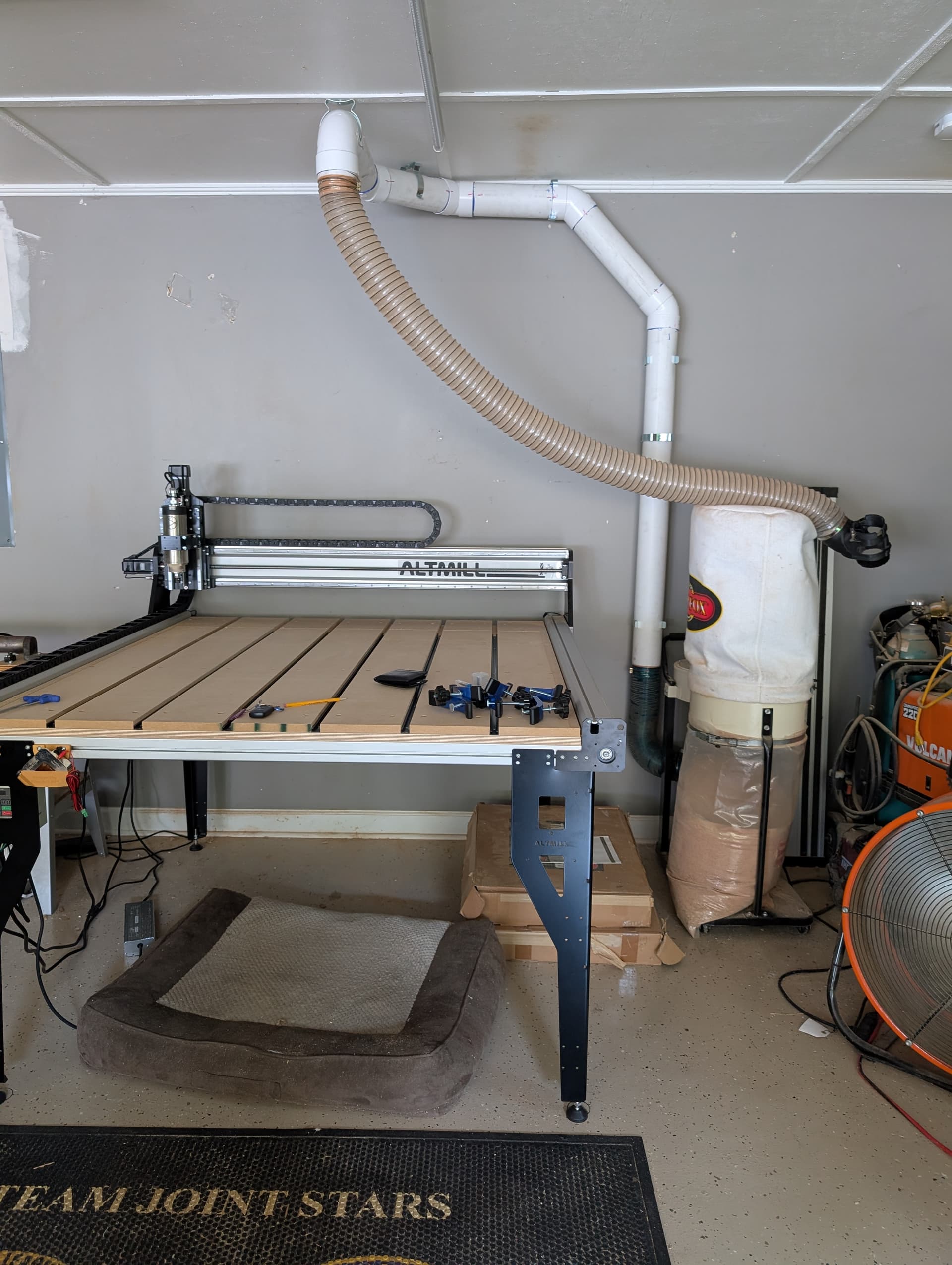

Just Just did a standard old system. I decided not to go overboard with it.
 ![PXL_20250814_192101208.MP](https://forum.sienci.com/uploads/default/original/2X/a/a04eefe8664c3a94c31a279bbe1083db1400e1e2.jpeg)
**Author:** ![beerbarrel](https://forum.sienci.com/user_avatar/forum.sienci.com/beerbarrel/32/10354_2.png) [@beerbarrel](https://forum.sienci.com/u/beerbarrel)\
**Post date:** [August 14, 2025, 7:31pm UTC](https://forum.sienci.com/t/post-your-dust-collection-pics/21499/15 "2025-08-14T19:31:04Z")
We dont usually have much issue with static electricity but I will bond that plastic pipe too.

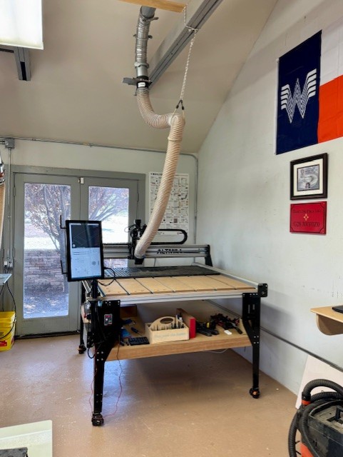

String and a shop vac works great!
