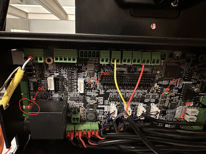

today I went to check my alt mill and my controller seams to have a problem. The led inside the controller seams to be dim and flashing. Is it a power problem or a controller problem
**Post date:** [August 10, 2026, 7:51pm UTC](https://forum.sienci.com/t/problem-with-my-alt-mill-controller/26882/2 "2026-08-10T19:51:03Z")
@AAGC Have you seen this article: [SLB or SLB-EXT - No Power on the Control Board – Sienci Labs](https://sienci.zendesk.com/hc/en-us/articles/43720373247124-SLB-or-SLB-EXT-No-Power-on-the-Control-Board)
You don’t describe the problems you are having, other than the dim light. What’s not working?
**Author:** ![AAGC](https://forum.sienci.com/letter_avatar_proxy/v4/letter/a/ce7236/32.png) [@AAGC](https://forum.sienci.com/u/AAGC)\
**Post date:** [August 10, 2026, 7:57pm UTC](https://forum.sienci.com/t/problem-with-my-alt-mill-controller/26882/3 "2026-08-10T19:57:09Z")
nothing is working anymore. I did check the article and did unplug everything. I don’t have a tester to test the output of the power supply.
**Post date:** [August 10, 2026, 8:08pm UTC](https://forum.sienci.com/t/problem-with-my-alt-mill-controller/26882/4 "2026-08-10T20:08:23Z")
![IMG_1427](https://forum.sienci.com/uploads/default/original/2X/2/2b519881e52a1425008c0bb30e7cf4a8a8cdc445.jpeg)
Is there anyone did have a problem with the power supply
**Post date:** [August 10, 2026, 8:14pm UTC](https://forum.sienci.com/t/problem-with-my-alt-mill-controller/26882/5 "2026-08-10T20:14:37Z")
@AAGC Your picture shows a circle around the “Halt” light to indicate it’s on. Did you short the e-stop pins as indicated in the document to see what happens?
**Post date:** [August 10, 2026, 8:16pm UTC](https://forum.sienci.com/t/problem-with-my-alt-mill-controller/26882/6 "2026-08-10T20:16:44Z")
yes I did and the state is the same
**Post date:** [August 10, 2026, 8:22pm UTC](https://forum.sienci.com/t/problem-with-my-alt-mill-controller/26882/7 "2026-08-10T20:22:26Z")
@AAGC I guess it’s time to contact Sienci : [Support Form | Sienci Labs](https://sienci.com/support-form/)
**Post date:** [August 10, 2026, 8:35pm UTC](https://forum.sienci.com/t/problem-with-my-alt-mill-controller/26882/8 "2026-08-10T20:35:05Z")
thank for the help I will contact them
**Post date:** [August 12, 2026, 10:16pm UTC](https://forum.sienci.com/t/problem-with-my-alt-mill-controller/26882/9 "2026-08-12T22:16:17Z")
ok following about my controller. I read the documentation and it appear that went you connect the usb the led come on and that without the power supply. So my controller is dead because there no led is on on the board. The good news is Steph from Sienci sent me a new controller . I can said that I did have a real good service from Sienci top level.
