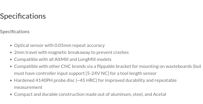

According to the specifications in the store it’s an optical sensor and the magnet mount is the fail safe not the spring.
 ![Screenshot 2026-09-12 at 21-55-00 Tool Length Sensor Kit Sienci Labs](https://forum.sienci.com/uploads/default/original/2X/1/1c1c26451157c1287526664e681dc571140711ac.png)
Maybe all that is covered in the video but I didn’t watch it.
