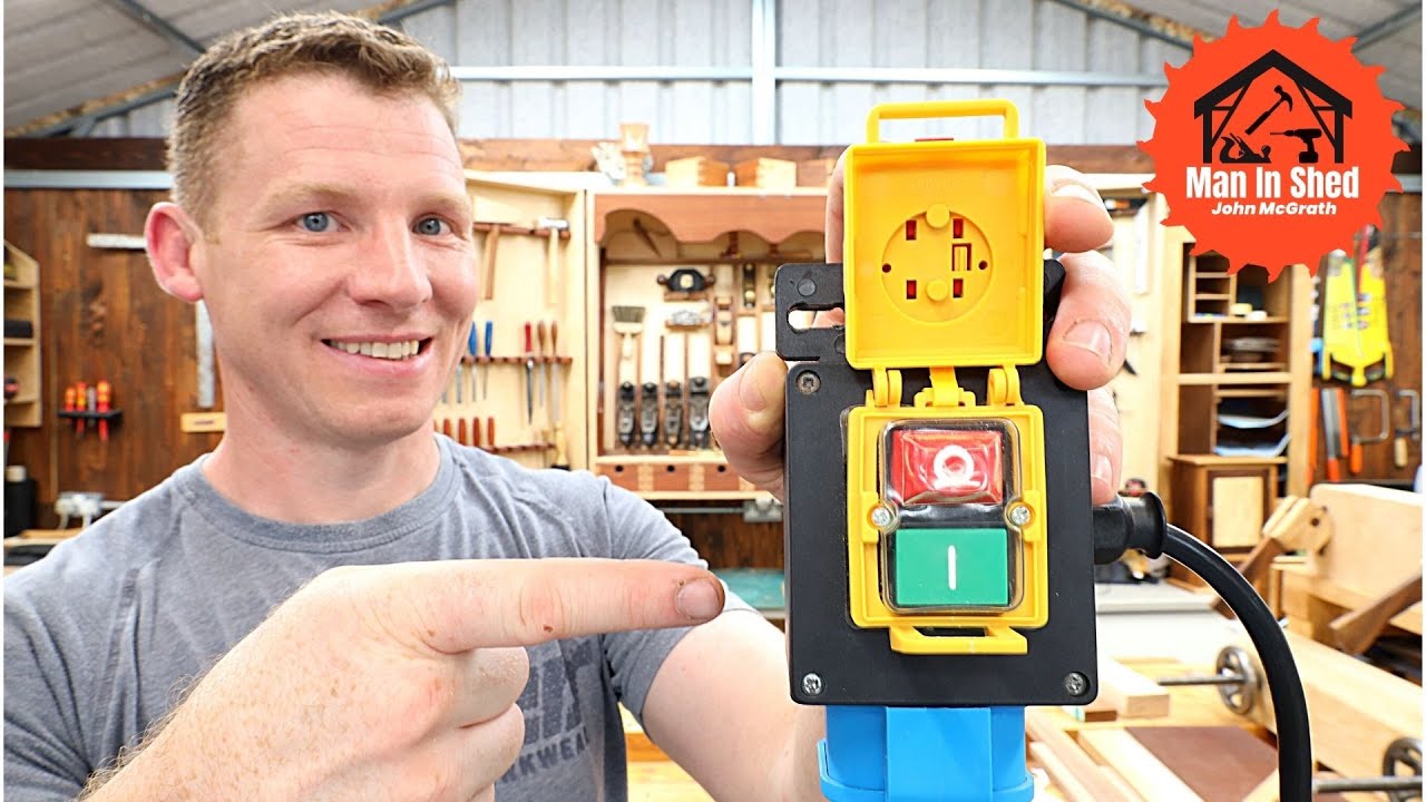

Not sure if this will help but it might if you have and NVR switch on the dust collector. I tried to see what type of switch Grizzly uses but did not have much luck. Let us know how it turns out what ever you do.
[![](https://img.youtube.com/vi/BqIUVWKrjvQ/maxresdefault.jpg "Remote Dust Extraction Control When You Have a NVR Switch! How To!") ](https://www.youtube.com/watch?v=BqIUVWKrjvQ)
