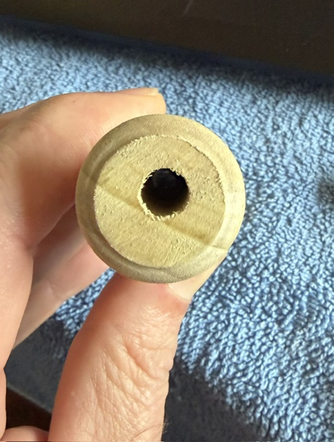

Hello all,
I have recently added the vortex rotary to my Altmill 4x4. While it seems to work relatively well, I cannot seem to get it to turn a piece with a center through hole exactly centered.
I have checked that the X and Z axis are exactly zeroed and aligned using a fine tipped carving bit.
I have noticed that the chuck seems to have a bit of runout and the tail stock seems to tilt up and back when tightening it up to secure it.
Has anyone else had this issue and could provide me some advice on how to remedy this issue?

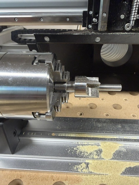

Just for clarification, I predrilled the through hole so that I could then center that hole on the rotary.
Hopefully that makes sense.
Seems to me that even if the hole I drilled was not exactly in the center of the stock that as long as the carve is inside of the stock diameter (which it is - stock is 1.25" model is 1’) then the hole should be exactly centered after the carve.
Am I wrong in my thinking here?

Using a bolt in the chuck end and the hole is the same as the tail stock pin so it fits in there perfectly.

@cncConfusion As long as the bolt is running true, your setup should work. You’ve said that X and Z are set. Does this mean that your Vortex runs parallel to the Y rail?
The chuck should not have any visible runout. Make sure that, when the jaws are fully closed, that the meet in the exact centre. The can be off quite easily.
I’ve done many pieces on the Vortex and some pens, which require a fair degree of precision. I’ve never had an off-centre issue.

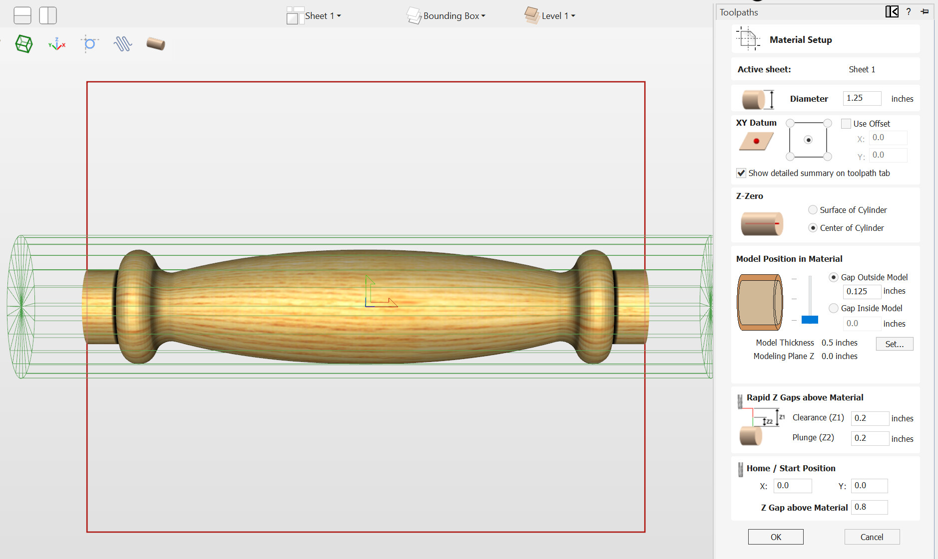

ps. I forgot to ask how you are designing your piece and if it is a 3D model, how you are centering it in the material.

The piece is setup in Vcarve Pro and yes it is centered in the stock but I will double check that as well and post a picture.

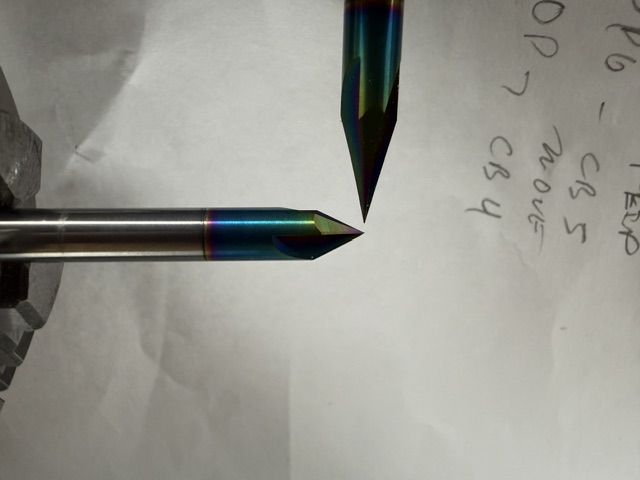

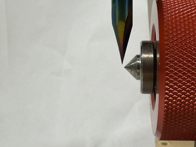

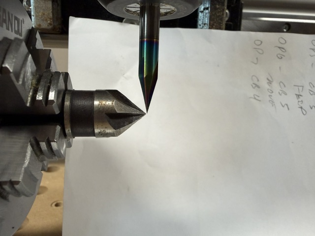

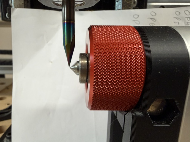

@gwilki Ok so are some pics and videos of the run out. Hopefully these make sense of some sort.
It kinda looks like the Z height is off just a bit, used a feeler gauge and there was about .045 between the tips. So maybe this is the culprit?? 🧐
I’ll have to figure out how to add a video on here to show the runout on the chuck.
Let me know if you want any other pictures.

**Post date:** [June 7, 2026, 11:20am UTC](https://forum.sienci.com/t/rotary-carves-not-centered/26530/13 "2026-06-07T11:20:59Z")
@cncConfusion Before going any further, please keep in mind that I am not Sienci tech support. I’ll do all I can, but you may need to open a support ticket in the end.
1. It looks like Z0 is off equally at both the headstock and tailstock ends, correct? So, that would rule out that the Vortex is slanted. No real help. Just an observation.
2. I assume that you are setting Z0 using the probing function in gSender. Correct?
3. You are using the stock chuck from Sienci?
4. What bit are you using to set Z0?
I would try setting Z0 manually and rounding a scrap piece of material around a drilled hole to confirm that the issue is Z0 being off using the probe.

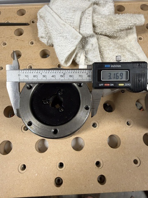

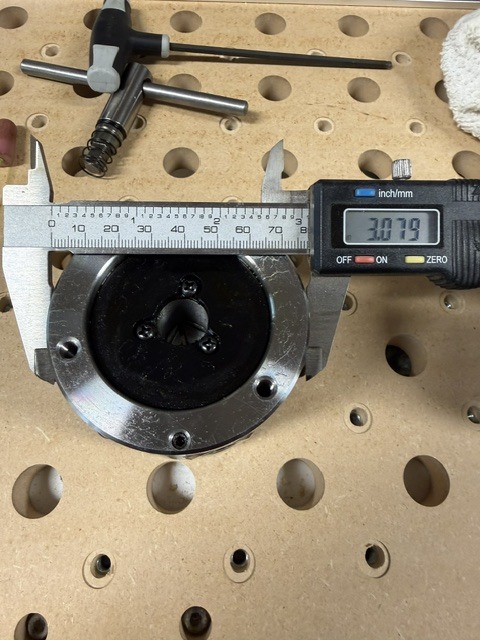

No I was not using the stock chuck, I had switched it to a 3 jaw self centering one for ease of centering materials. I did not think about the specs being slightly different on the OD of the chuck.
So yes, there is a difference .09 so half that is .045 which basically exactly how much it seems to be off!!
For the purpose of the test that I attached pictures of, I used that same bit to set the Y and Z zero.
Still seems weird though that if the program is auto detecting the zero that it would matter, yes I use the X and Y rotary zero functions in the rotary tab.
Here are the pictures of the chucks, bigger one is the stock 4 jaw.

@cncConfusion You’re welcome. I’m sure that is the issue. gSender computes where the Z centre point is based on the height of the stock chuck from that centre. It uses a hard coded distance. If you change the distance by using a chuck of a different diameter, gSender does not accommodate that difference.
Unlike the touchplate module in gSender, I don’t believe that there is a setting that you can change to reflect a different chuck size. I can’t tell which chuck is smaller. If it is your new chuck, you could always shim it up with metal foil tape of something. If your new chuck is larger - never mind. 😀

@gwilki The stock 4 jaw is bigger than the replacement 3 jaw I put on.
I put the 4 jaw back on and reran the zero macros and this is the result.
 ![IMG_9395](https://forum.sienci.com/uploads/default/original/2X/a/a19c7e32a5f21df747ef8bfc859d4ed3141ce98c.jpeg)
 ![IMG_9396](https://forum.sienci.com/uploads/default/original/2X/a/a073432b0f7c25d2fef3502bd3030122186bd5aa.jpeg)
Looks pretty much dead on.
So now if I wanted to use the 3 jaw chuck I guess I could just zero it with the built in macro, then manually adjust it for the difference…🤔 🤔 🤔 🧐

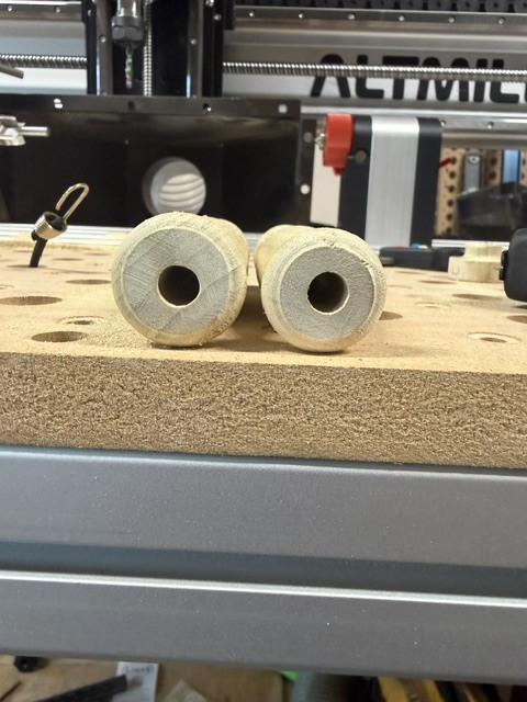

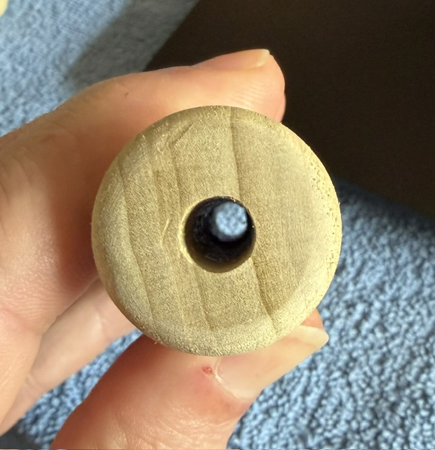

**Post date:** [June 7, 2026, 10:48pm UTC](https://forum.sienci.com/t/rotary-carves-not-centered/26530/21 "2026-06-07T22:48:03Z")
@gwilki Well while our theory about the different chuck size seemed very plausible, it seems to have not panned out.
I ran 2 more samples running the exact same tool path gcodes:
One with the Sienci 4 jaw chuck (jaws are perfectly centered) using a counter sink bit as a mounting device (like you see in the above pictures)
One with the Sienci 4 jaw chuck and the new 4 prong center drive with the 8mm smooth shaft.
Both came out pretty much the identical, and off centered still.🤦 🤦 🤦
I’m open to any more suggestions, otherwise I’ll put in a support ticket and see what they have to say.
From what I can measure they are about .04 of still to one side.
 ![IMG_9397](https://forum.sienci.com/uploads/default/original/2X/7/75ef58ce735d9993b5aa48c160466280d308989e.jpeg)
 ![IMG_9398](https://forum.sienci.com/uploads/default/original/2X/f/f6f02a19ad35a18489e946a99f06206676e0c051.jpeg)
