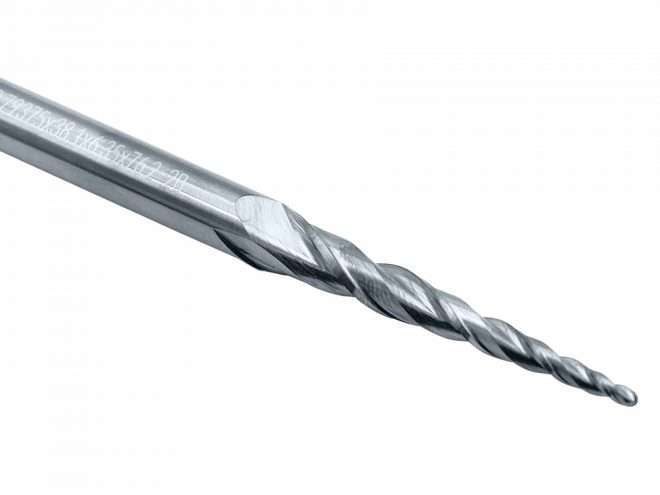

The letters were carved with a 45 degree slope on the sides, using a ¼ inch endmill for a rough pass, followed by a finish pass with:
> **[1/4″ D1/16″ Tapered Ball Nose End Mill | Sienci Labs](https://sienci.com/product/1-32-radius-tapered-ball-end-mill/)**
> This 1/16" Diameter (1/32" Radius) Ball Nose Tapered End Mill, with a 1/4" shank has a tapered round end profile which is perfect for carving curves, contours, and reliefs in soft to medium hardness materials like wood, plastic and foam. This item...
