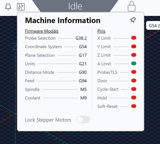

With the SLB and gSender 1.4.7, I was wondering if the newer Trinamic-specific homing rates ($180-$193) were active?
On my MilkCr8 (Linear rails, lead screws and NEMA 17 motors) I occasionally have stalls when homing Z. Problem seems to go away after some movement – almost as if “warming up” helped ease the issue. Today I disconnected the lead-not and once again confirmed that the movement up and down the rails was smooth – but it reminded me that my Z assembly (aluminum plates and RoutER11) is pretty dang heavy.
Reading through the enhanced grblHAL configuration – I was jazzed to see axis-specific homing seek rates. I set my Z-axis rate ($192) particularly low (300mm/min), but when homing Z, it seemed the rate of movement wasn’t any slower than the rate listed in $25 (2000 mm/min)
Curious if I’m missing some other flag to activate those settings or if I’m missing something else.
I’ve also uploaded current settings.
[gSender-firmware-settings-5\_29\_2024-9 00 37 PM.json](https://forum.sienci.com/uploads/short-url/oHJmHGULvl0zFUKjdLGlLgiDok1.json) (2.8 KB)
Thanks for any guidance!
John
 ![Screenshot 2024-05-29 at 7.48.24 PM](https://forum.sienci.com/uploads/default/original/2X/5/5f17d12097ec878c1fd05147e2a13bbc74fed308.png)

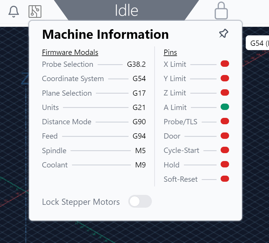

Hi @chrismakesstuff do you know if this ever got addressed? I’m seing the same behavior as @JohnOCFII - the axis-specific homing rates are not being respected as of firmware 5.0.5b.
Speaking of which, it would be great if gSender would display the current firmware version in the “machine information” fly-out:
 ![image](https://forum.sienci.com/uploads/default/original/2X/7/7d39d3496eed6cbc2e64b32659e86cd5e8d06f8c.jpeg)
