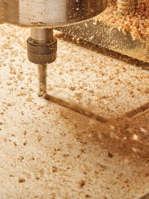

So this popped up in my inbow today and I thought it might be of interest to someone here:
> **[Feeds & Speeds for CNC Routers | Popular Woodworking](https://www.popularwoodworking.com/techniques/feeds-speeds-for-cnc-routers/?utm_campaign=PWW%20-%20NL%20-%20Sunday%20Newsletter&utm_medium=email&_hsmi=208798334&_hsenc=p2ANqtz--U3rll3SkguwI0XlqdjECQbq4E2UyMkJzt3vssOAzjyobFOU-yK5YAEOfAFPcyT0OQuuYpCMCrrlnoGkQQx3EjAp9_hg&utm_content=208797235&utm_source=hs_email)**
> If you have spent time using handheld routers then you have developed an intuitive sense for what is the ideal feed rate and speed for the cutter. The feedback is immediate and tactile.
I hope this helps someone 😉😉
