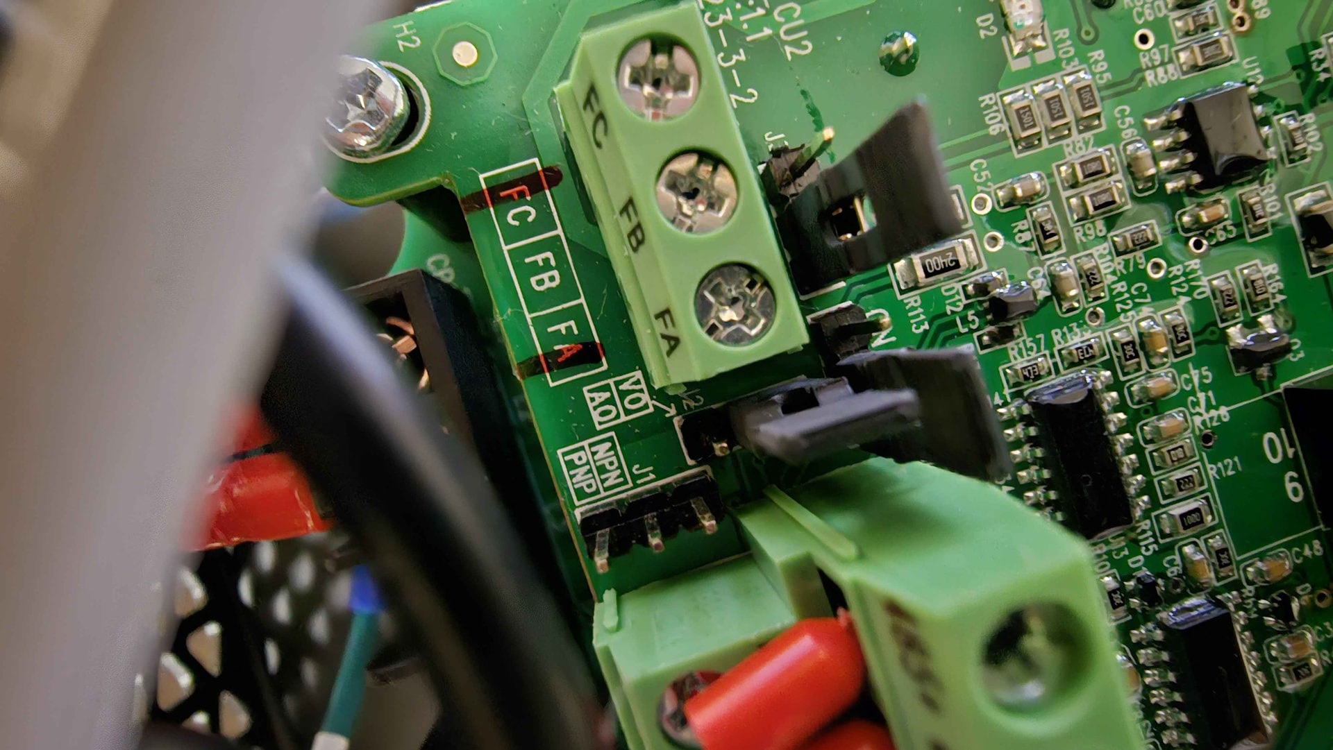

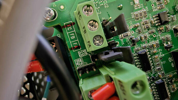

I think I found the issue there was a rattle in the vfd and a jumper fell out after shaking and routating it a bit. does anyone have a photo of the inside of one of these (control terminal area) or a schematic showing exactly where each jumper goes? I know there are at least a few in that area
**Author:** ![SlimeTime](https://forum.sienci.com/letter_avatar_proxy/v4/letter/s/278dde/32.png) [@SlimeTime](https://forum.sienci.com/u/SlimeTime)\
**Post date:** [August 22, 2026, 11:16pm UTC](https://forum.sienci.com/t/spindel-stuck-at-7500-manual-and-automatic/26883/11 "2026-08-22T23:16:47Z")
Found the jumper issue the NPN / PNP jumper fell off. I assume NPN is the correct jump for a longboard. but I will test it tomorrow and post. Support said not to open it but with a jumper falling out figured I would just send it.

This worked the 0900 flashing numbers are now flashing 0000 even cleared from the VFD. Ran the Spindle Brake in just fine, it had no issues.
