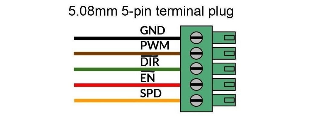

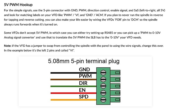

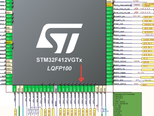

Hi team-
I’m attempting to retrofit a Shapeoko 5 Pro with the SLB, and am running into issues getting the C3D spindle (VFD) to work.
I have configured the SLB firmware per the Technical Manual [5V PWM Hookup](https://resources.sienci.com/view/slb-manual/#5v-pwm-hookup) instructions and I believe set up the firmware correctly. However, regardless of what I set the invert flags to, I can’t get the DIR or EN pins to do much of anything. I do see a signal on the PWM pin when I run an M3 command, so I believe I have the correct spindle selected.
Am I missing something here? Are the DIR and EN pins implemented or is this in the future work category similar to Y2 limit switches?
Also FWIW while looking for +5VDC to steal for debugging, the [Technical Manual](https://resources.sienci.com/view/slb-manual/#tls) claims the TLS power pin is 5VDC, but when I measure it out here I see 24VDC. Not sure if the docs are wrong or my board is wrong, but the two don’t match in any case.

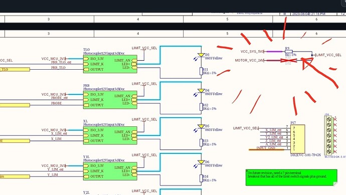

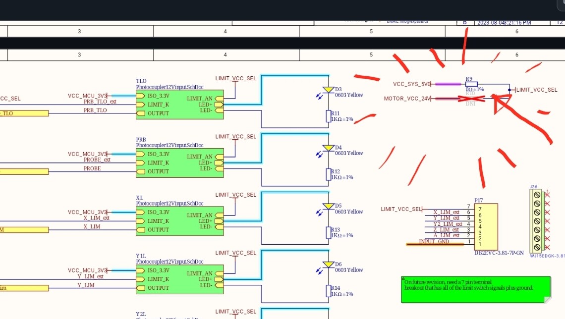

**Post date:** [March 25, 2025, 6:34am UTC](https://forum.sienci.com/t/spindle-enable-direction-pins-not-active/16624/2 "2025-03-25T06:34:09Z")
Hi DV,
I have no SLB, so cannot be of much help being a reference to anything. I have looked into the schematics to find the Voltage thing you mentioned and found a selector section on the tls voltage.
 ![Screenshot_20250325-071126_Chrome](https://forum.sienci.com/uploads/default/original/2X/c/ccee59d48b523ed59747668d2ffdc66069649997.jpeg)
I however am not able to locate R9/R10 in the board diagram for it is heavely labeled up and not the highest resolution. But, at least there is a why for the weird voltage swap. The question is, is this a fault on the board or a fault on the tech manual.
Anyhoo, here’s the link to the schematics on the SLB. You might be able to find another spot to steal your 5v (rs485?)
> **[Longboard\_32bit\_Schematic\_B4\_FULL\_PLACE.PDF](https://github.com/Sienci-Labs/SuperLongBoard/blob/master/Project%20Outputs%20for%20Longboard_32bit/Longboard_32bit_Schematic_B4_FULL_PLACE.PDF)**
Sorry I cannot help with all your question.
**Author:** ![drilling-vagueness](https://forum.sienci.com/letter_avatar_proxy/v4/letter/d/258eb7/32.png) [@drilling-vagueness](https://forum.sienci.com/u/drilling-vagueness)\
**Post date:** [March 25, 2025, 3:42pm UTC](https://forum.sienci.com/t/spindle-enable-direction-pins-not-active/16624/3 "2025-03-25T15:42:07Z")
Oh interesting, thanks SE! I swapped R9 to R10 to change the output voltage for the limit switches, and I guess it changes the tool length sensor voltage as well, that makes sense.
Sienci devs, can you refer to this voltage in the docs as “accessory\_Vcc” or something instead of magic numbering the text to “5V”? Clearly “limit\_vcc” applies to more things than just limit switches.
Thanks!

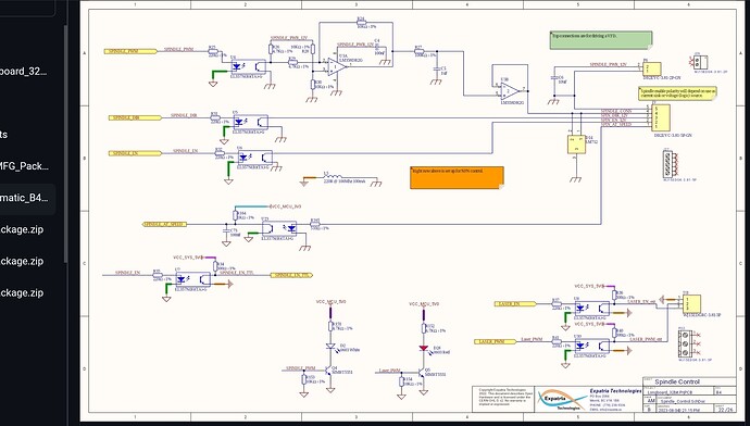

**Post date:** [March 27, 2025, 6:48am UTC](https://forum.sienci.com/t/spindle-enable-direction-pins-not-active/16624/9 "2025-03-27T06:48:50Z")
Hey DV,
Again, I don’t have an SLB nor have a spindle, so I cannot be of much help. I do have somewhat 2 decades of experiance in electronics repair so can point towards a few points of interest and known problems of certain components. Other than that, diagnosing a board without having it on the workbench is.. meh..
So, I went back into the schematics, spindle ctrl. If I look at the enable line, it’s pretty much a opto coupler switching an open line towards ground. Just what your measurements show. Prolly the pulling up has to happen on the spindle side of things.
The pwm line is a bit less clear to me for it has a multitude of fail points but since you are measuring random static, while the indicator led seem to work you might want to concentrate on looking at loose pins on U4, U3, and the connectors.
Especialy these kind of opto couplers are known to not always solder as nice as they should due to bent or dirty pins, leaving them just hanging above the joint or embedded in flux residue. In either case you should be able to spot it fairly easy, but a small push on each pin of the component wont hurt.
Another point to look at are the gnd pins of the connectors. They are connected to a bit more copper inside the print and can have the tendency to not solder if the solder proces is a bit off (preflux or solder contamination etc)
When you are at it, check the pins of U3.

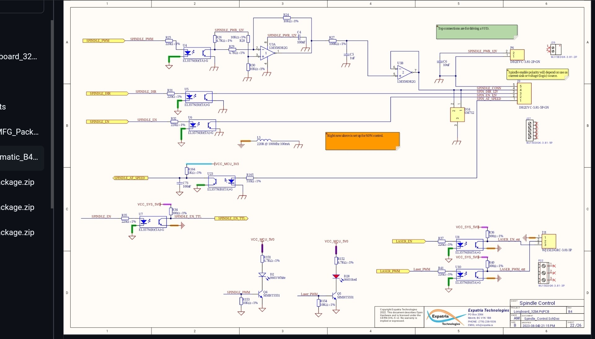

Here’s the schematic for the spindle section for some in depth trouble shooting.
 ![Screenshot_20250327-070451_Chrome](https://forum.sienci.com/uploads/default/original/2X/6/614ce4f5047f1c3f9dc1419ecf21ad59d103d213.jpeg)
I don’t think the processor side of things are at fault here but if all else fails you could check the pins on u17 for solder bridges or loose pins.
 ![Screenshot_20250327-064139_Chrome](https://forum.sienci.com/uploads/default/original/2X/b/bd2e5b35a75a408fc626f614e459bb98ee72063f.jpeg)
Please note that the orientation in this schematic deviates from the actual orientation on the board.
Hope you find something.
**Post date:** [March 27, 2025, 7:27am UTC](https://forum.sienci.com/t/spindle-enable-direction-pins-not-active/16624/10 "2025-03-27T07:27:28Z")
Thanks so much @Spamming_Eddie! I appreciate all of the help even though you don’t have an SLB or spindle.
Issue 1- When I went to look at the schematic on github, I didn’t realize that github does it’s own pagination of PDFs and I was only seeing 3 of 26 pages. Now I realize there are a lot more 🤦
Issue 2- I did not specify that I’m working with the phoenix connector, as those seem to be the primary/preferred connectors on the SLB. From the schematic, I agree with you that it looks like `SPIN_EN_12V` is in fact a current sink. The `SPINDLE_EN_TTL` in the lower left of that page is a voltage source, but that’s only brought out on the AUX connector documented on p10 of the schematic.
There’s are a few related notes in the schematic:
- Top connections are for driving a VFD.
- Spindle enable polarity will depend on use as current sink or voltage (logic) source.
- Right now above is set up for NPN control.
I’ll have to do some digging on how this all works. I had assumed that the phoenix connector spindle enable signal was a logic level voltage, not a pulldown. I don’t know if that’s typically how controllers communicate to VFDs; it doesn’t appear as though this is how the VFD I’ve got communicates.
In any case … I would say this is tremendously under-documented in the Technical Manual section on [5V PWM Hookup](https://resources.sienci.com/view/slb-manual/#5v-pwm-hookup)? Or at least in my read of it.
 ![image](https://forum.sienci.com/uploads/default/original/2X/9/92e0ae96d1fe7b8a7b007c44ebd88298f81479c3.jpeg)
The wording of this (“from left-to-right, **all 5V** ”) makes me think that DIR and EN are also 5V logic level signals, not a pull-down. There’s no mention that the signal brought out on the AUX connector is not the same signal on a different physical form factor, but in fact a different logic format also.
@chrismakesstuff your commentary on the above documentation would be much appreciated. If the phoenix connector should be able to be configured as “all 5V”, can you please advise how to make such a configuration? From the schematic this doesn’t seem possible. If this is not possible, please update the documentation to match the as-built.
**Post date:** [March 31, 2025, 11:57pm UTC](https://forum.sienci.com/t/spindle-enable-direction-pins-not-active/16624/12 "2025-03-31T23:57:45Z")
Hi @Spamming_Eddie, could use your analysis if you have a moment:
I dove into the board with a(n unfamiliar) scope, and after getting screwed up with the 1x/10x probe multiplier stuff finally managed to track down a PWM signal all the way to the buffer `U3` (a TI [SN74LVC2G17](https://www.ti.com/lit/ds/symlink/sn74lvc2g17.pdf)), where I see it on pin 3, but not pin 4. Ground and power looks ok on pins 2+5.
I assume this means I cooked the buffer somehow - it took me a while to realize that the spindle VFD wrapper/converter I’ve got expects a ground-switched / current-sinked source (not sure terminology, but more like the `SPIN_EN_12V` output of the SLB). I believe the signal converter is providing 5VDC on that line - would that be enough to kill the buffer output? Going forward I expect to have to bypass this board and just connect directly to the VFD.
It looks like the laser output on buffer pins 1+6 are still behaving ok. If it is possible to just re-program the spindle output to happen on the laser port that’d be fine for now, but this doesn’t seem straightforward in the firmware configuration.
In any case, I guess I need to get this buffer replaced. I don’t think this is a soldering job I’m able to do myself unfortunately, that package is tiny and I can barely do something with two leads let alone 6. Jeez, the SOT23 used here is the _biggest_ package this device comes in 🫠
I do still wish _all_ of this stuff was better documented outside of the schematic ☹
**Post date:** [April 1, 2025, 4:40am UTC](https://forum.sienci.com/t/spindle-enable-direction-pins-not-active/16624/13 "2025-04-01T04:40:28Z")
Hi @drilling-vagueness,
I’m on my mob dev at the moment and it is a hassle to go back and forth between datasheets, schematics and posts so I cut right to it. Assuming you refering at U3, your datasheet does not match the schematic nor footprint of the package used on the board. It might be wise to look at this datasheet instead before concluding things based on measurements taken.
> **[LM358DR2G datasheet(1/14 Pages) ONSEMI](https://www.alldatasheet.com/html-pdf/198782/ONSEMI/LM358DR2G/218/1/LM358DR2G.html)**
> © Semiconductor Components Industries, LLC, 2004July, 2004 − Rev. 181Publication Order Number:LM358/DLM358, LM258, LM2904,LM2904A, LM2904V,NCV2904Single Supply DualOperational Amplifiers Datasheet search, datasheets, Datasheet search site for...
To be fair, the whole schematic part on the spindle has me holding back on stating with confident about the workings of that part of the board without the ability to comfirm suspicions into hard measurements. Things happen on the spindle side that are unknowns and with that, the knowns on the schematic side turn into black boxes aswell.
Looking at the datasheet for the lm358, I suspect it to be a sturdy fella, capable of handling a wee misvoltage at the ios (your 2G17 would likely not.) But then again, having a black box in those ios there is no telling.
Looking at the position of u3 on the board and assuming you have a station based solder iron capable of temp selection. (anything but a fixed temp iron) and a somewhat pointy tip. Replacing U3 should not be much more difficult that replacing a 402 or 603 resistor like R9/R10.
Removing U3: short the pins on both sides of U3 with solder. Use a tweezer to excert a !!small!! upwards pull on the IC. Melt the solder on the shorted pins untill the side pops up a bit. Remove the heat and wait for the solder to solidify. Move to the other side of the package and do the same handlings. Do this moving from one side to the other untill U3 is gone. Remove excess solder from the pads untill they are no longer shorted (doesnt have to be ultra clean.) Resolder the pins until nicely filled.
Replacing: Hold the new U3 on the pads and melt one pin on its pad. Push on U3 and visit the other pins with your iron. If needed apply a wee flux and revisit the now soldered pins one last time.
**Post date:** [April 2, 2025, 11:12pm UTC](https://forum.sienci.com/t/spindle-enable-direction-pins-not-active/16624/14 "2025-04-02T23:12:48Z")
Seems like most of the misunderstanding is coming from what 5V signals are impacted with the jumper is changed to 24V? If that’s the case, maybe I could write up a new section in the docs to specify what happens if you change the jumper and the IO it impacts, is that along the lines of what you’re looking for @drilling-vagueness?
Sorry if you’re getting caught up on this stuff, I think you’re the first to use the 24V option on the SLB and I’d certainly agree the docs all lean more toward 5V since it’s the most commonly used - the jumper I put in as an option to hopefully provide more support across machines but up till now it didn’t seem like anyone was keen to take up that option
