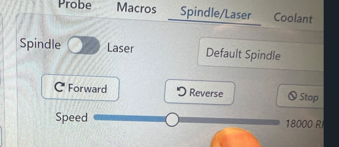

I am using the latest gSender and the modvfd plugin for spindle.
It seems to be working at controlling the spindle properly from the console, and the slider also controls the spindle at (I believe) the correct speed.
The issue is that the slider shows a range of 10k - ~40k?, although my spindle is configured for 3k-16k. I can’t drag the slider beyond my configured max, but that max is less than half way along the slider.

@marcoose I’d check that you’re actually on the latest version which is 1.5.4, since otherwise the spindle dropdown shouldn’t say “Default Spindle” it should say “MODVFD”. If you change the toggle to the correct one, then the range should become correct too

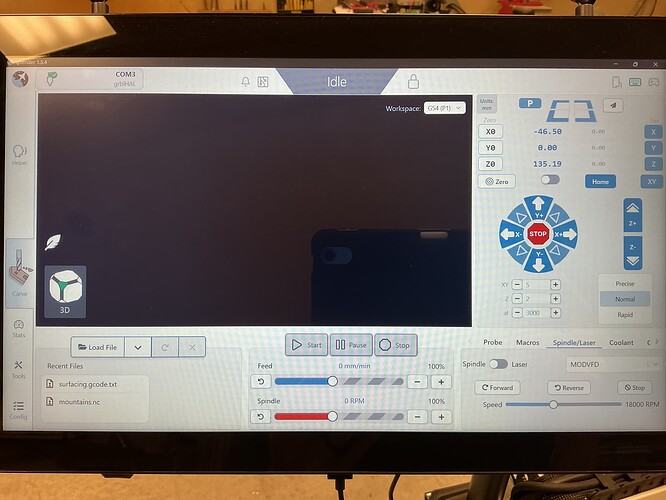

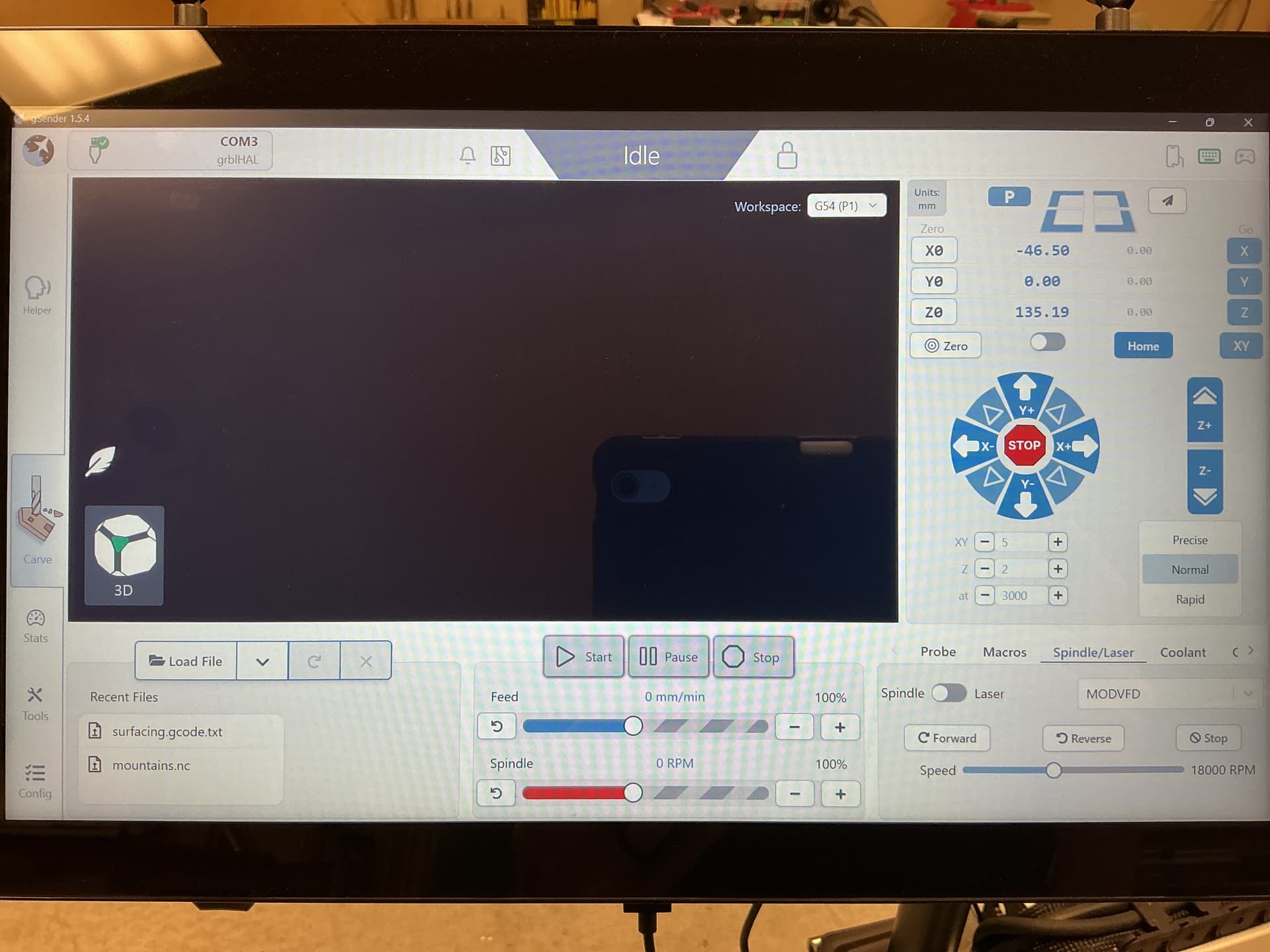

Well shoot… I would have sworn I was on the latest, but it was 1.5.2. I’ve since updated to 1.5.4, and now the ‘Default Spindle’ does say ‘MODVFD’.
Outside of that, though, I seem to have the same issue with the slider. It goes from 10,000 at the lowest, to 18,000 at the highest, which is less than 1/2 way along the slider.

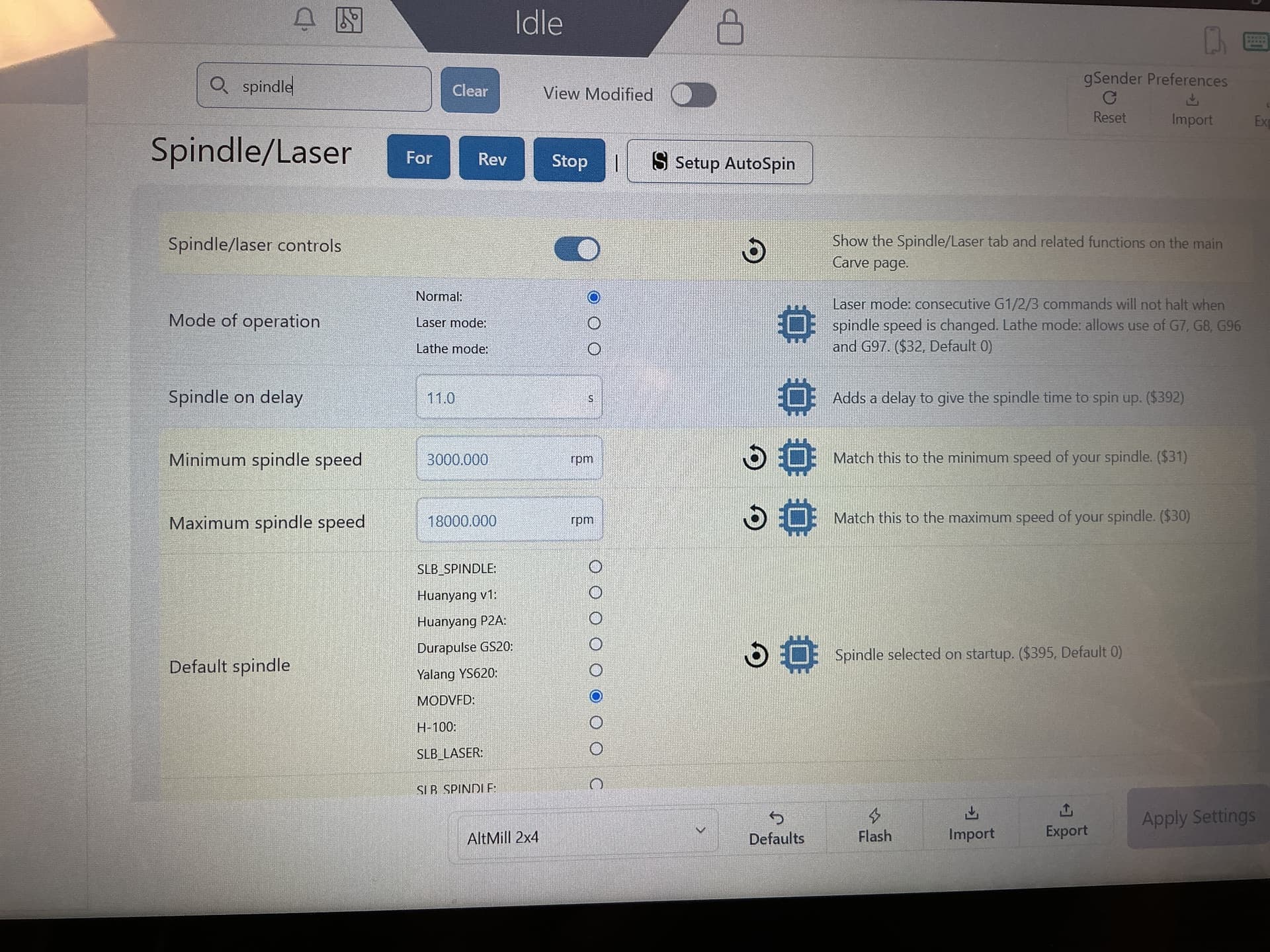

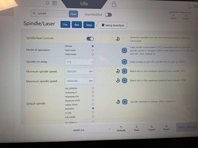

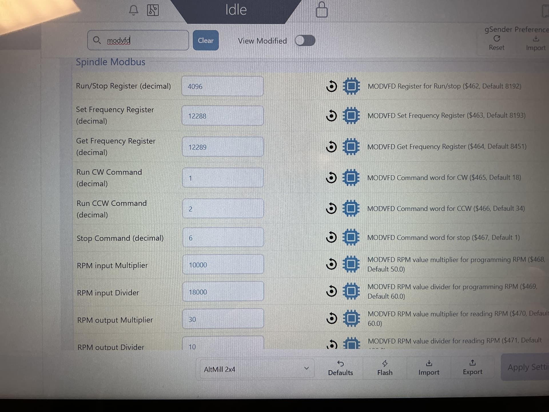

I was too new to post more than one picture before, but here are my settings;
 ![image](https://forum.sienci.com/uploads/default/original/2X/0/03ffefe999e2b534b09b667932c17f313e20d127.jpeg)
 ![image](https://forum.sienci.com/uploads/default/original/2X/2/2bf888f140149d34cdb3af3220218490a021ac4d.jpeg)
 ![image](https://forum.sienci.com/uploads/default/original/2X/c/cc9fac009135fc85506e5a862645e7ff5a043ec1.jpeg)
It’s just a minor display issue right now, as setting the speed from the console or a gcode program works fine. I don’t really expect to use the slider for any “real” purpose beyond rare manual tinkering/testing.
