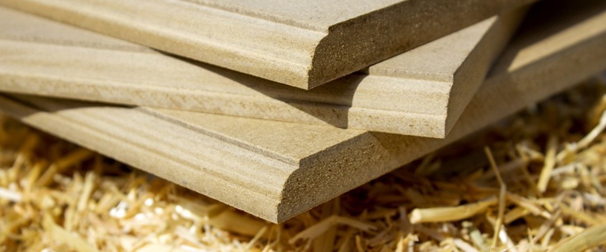

I was fascinated by the links the Greg posted to rice straw based MDF, so I made some calls this morning. Unfortunately, what I learned was not positive. Columbia Forest Products, which is a major manufacturer of MDF in North America, is the company named in the online article as being a Canadian supplier of the rice-based product. I called the head office of Columbia, and I was told that, unfortunately, the deal never came about. The man that I spoke to said that he believes that there is a small amount of the product being manufactured, but the financials never resulted in large production and exporting to Canada.
I am not posting this to contradict anything in this thread so far, merely to point out that it would seem that the industry in North America is a long way from producing a true formaldehyde free MDF, so we need to “be careful out there.”
