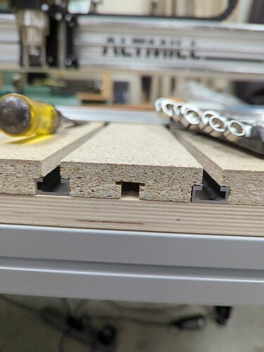

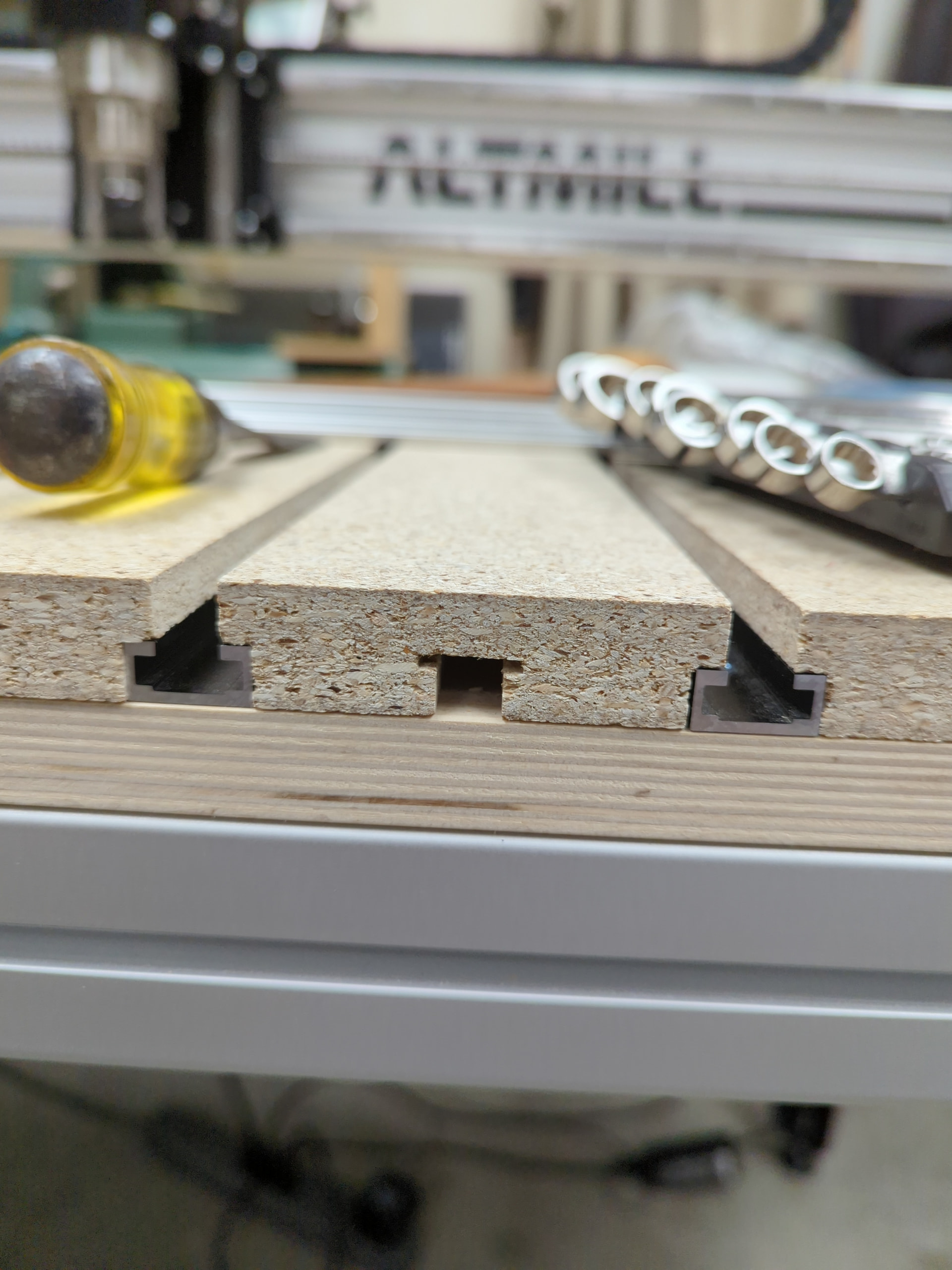

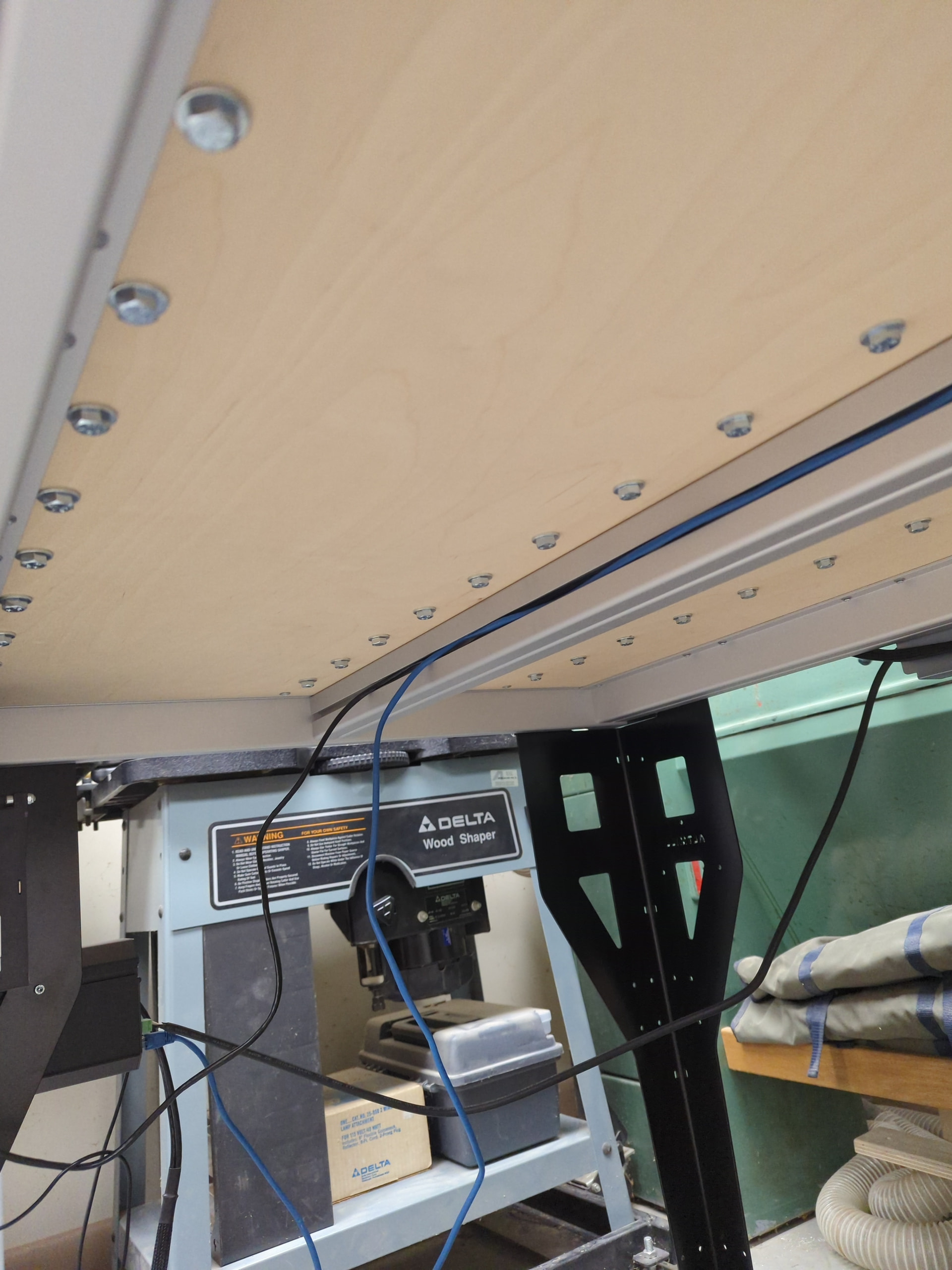

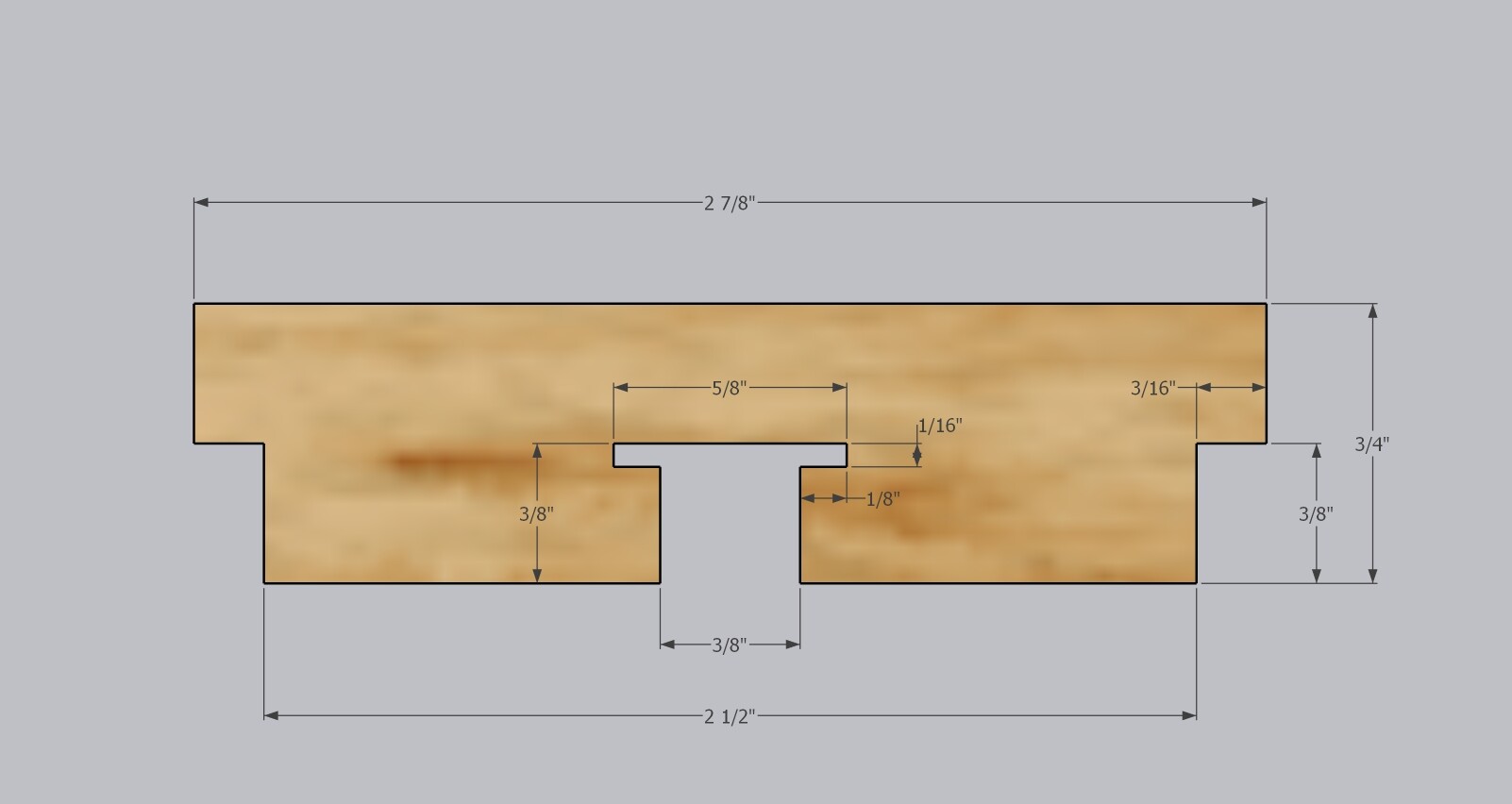

After reading through the comments thought it might be helpful to share with you what I ended up with for a support and waste board solution. I wanted to be able to remove the waste boards quickly and be able to insert vises and other methods for hold downs as well. There are 4 bolts with washers from the bottom up and into a 5/16" T nut. The spacing between the T tracks is around 3". This allows for a greater number of clamping options. Note that the waste board is milled so that it is over the sides of the T slots to give greater support, and close the gaps. To create the slot in the waste board slats I used a Dremel slot cutter after using a end mill to create the edge and the center clearance slot.

I guess I misunderstood what you were using the inserts for in your original message. I use t-nuts on a four-inch pattern for work holding devices. I never considered them to hold the spoil board to the table base. I used the holes in the cross beams to screw into the table base board as described in the assembly instructions and joined the spoil board to the base board with two columns of four (8 total) countersunk screws per spoil board slat.
**Author:** ![mjeanson](https://forum.sienci.com/letter_avatar_proxy/v4/letter/m/f05b48/32.png) [@mjeanson](https://forum.sienci.com/u/mjeanson)\
**Post date:** [July 9, 2026, 2:40am UTC](https://forum.sienci.com/t/spoilboard-mounting/26645/14 "2026-07-09T02:40:16Z")
I find that countersunk holes from the top down limit the amount of top surface that you can mill down to create a flat spoil board over time. The T nuts from below create almost 3/8" if material that can be machined. Also note that all of the forces are parallel to the Z axis thus allowing for a flatter surface when all of the hold downs have been torqued down. This allows for the force of the slats to pull down the T-track sides to aid in maintaining the flatness when applying the clamps and fixtures to the top of the spoil board.

I countersink the holes holding the spoil board holes deep enough so that the top of the screws are at the same level as the top of the t-track. Can’t surface below that anyway. A drill press makes short work of that. Your method works! I hope you enjoy your alt-mill.
