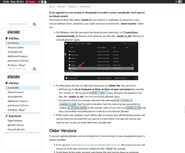

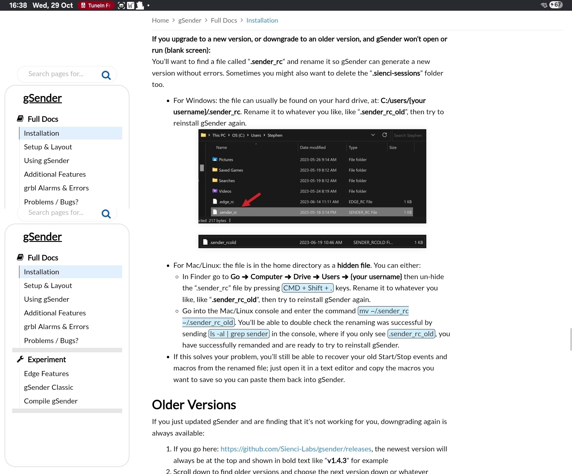

**Post date:** [October 29, 2025, 3:41pm UTC](https://forum.sienci.com/t/start-job-wont-start-job-gsender-1-5-4/21811/5 "2025-10-29T15:41:52Z")
Hey Dmaden,
I have no joypad or update my gsender anymore so have no direct hand on knowledge but I’ve read a lot of problems with updating being solved deleting/renaming this file talked about here, and reinstall.
 ![Screenshot_20251029_163844_Chrome](https://forum.sienci.com/uploads/default/original/2X/2/2a088977e867d2ff99b38530e44f10adf280324c.jpeg)
Found here:
> **[Installation - gSender Docs](https://resources.sienci.com/view/gs-installation/#gsender-updates)**
> Read about where to download gSender and how to install it onto Windows, Mac, Linux, or other PCs, as well as how to check for updates.
Maybe try this going foreward to the latest version or downgrade to the version that worked for you?
