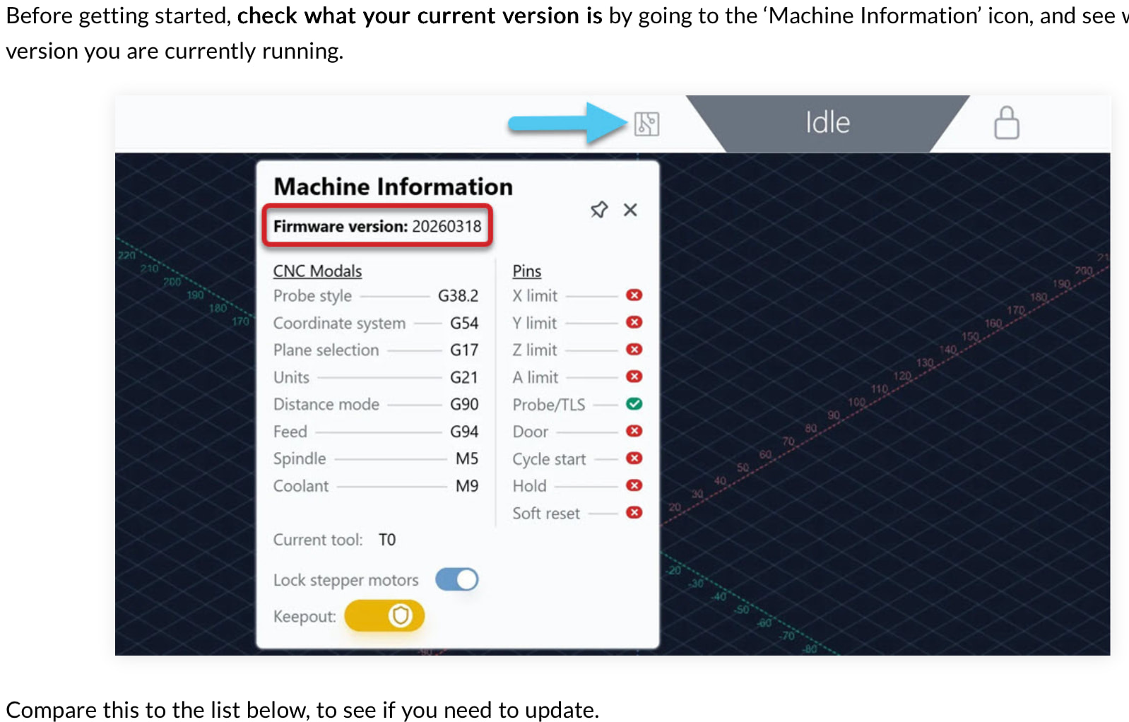

**Where the confusion came from**
On the flashing guide, there’s a screenshot of the **Machine Information** popup that shows:
> Firmware version: **20260318**

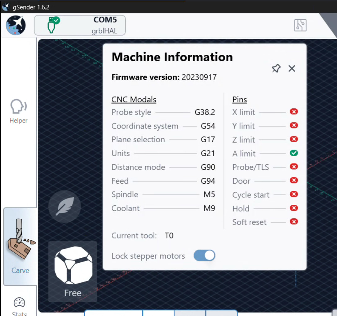

In gSender, the same Machine Information popup on my SLB shows:
> Firmware version: **20230917**
Side‑by‑side, that really looks like “my brand‑new SLB is still running ancient 2023 firmware while the doc shows a 2026 build,” which is what led me to assume I _must_ be out of date and start reflashing.
After a lot of investigation (including DFU/Zadig driver work and reflashing), it became clear that:
- The **“Firmware version: 20230917/20260318” value in Machine Information is actually the GRBL/grblHAL core version/date** (the `VER:` line from `$I`),
- While the **true SLB firmware identity is the `BOARD:SuperLongBoard_B5.0.5b` string and related driver/plugins** , which did _not_ obviously tie back to that numeric date.
In other words, the SLB firmware package (e.g. 5.0.5b) can sit “on top of” a GRBL core build that still reports `20230917`, so seeing an older date there does not necessarily mean the SLB firmware itself is out of date. But the UI and docs currently present that date as _the_ “Firmware version”, which makes it very natural to think “mine is old; the screenshot is new.”

I’m attaching two screenshots:
- The one from the flashing guide showing “Firmware version: 20260318”.
- My Machine Information popup showing “Firmware version: 20230917” + `$I` showing `BOARD:SuperLongBoard_B5.0.5b`.

I don’t think that’s correct with how we’re doing things internally now/into the future when it comes to firmware/hardware releases but that’s changed since sienciHAL was originally released quite some time ago.
The [BOARD:…] report is now purely an indicator of the hardware itself, the semver is the indicator of the grblHAL firmware version, and we’ll be keeping these as 2 distinctive indicators of both your hardware and what’s running on it.
So on the latest firmware release for the EXT (publicly available), BOARD has no indication of version, it’s just the hardware indicator.
![image](https://forum.sienci.com/uploads/default/original/2X/c/c07828843e3e477272d1c8b23b28b29b2fb6f79a.png)
And same with the (yet unreleased) internal SLB firmware image that’s more recent - no versioning, just “what board is this”
![image](https://forum.sienci.com/uploads/default/original/2X/9/9e9e79b39c04282ff052209bf184ac53c89f208d.png)
This makes a bit more sense than the original strings which included board and version - we can use BOARD to determine specifically which hardware you’re running on in cases there might be EEPROM profile differences between board types and lets us
change behaviour. Useful now and into the future since we’ll be supporting multiple board types, like the SLB, SLB-EXT, and soon SLB-Lite and SLB-EXT2 (plus any future board developments).
Semver is the correct grbl version, both now and for the 5.0.5B firmware. This is used internally for handling changes that have occurred since SienciHAL was released (for example, the $spindles command on the 2023 firmware version is now $spindlesh in modern grblHAL with a different reporting structure, so we can gracefully handle that on the backend without the user having to be aware of the distinctions). It’s also the most useful thing for support to be able to see at a glance to help diagnose issues - not the board string.
It’s also more useful for compatibility for non-Sienci boards running grblHAL - where they could have any version of grblHAL running on their board so tying behaviours to our specific strings is not useful, but grblHAL core version is.
The flashing resources does link to the latest firmware version for each regardless of what the image shows, and all board ships with the latest firmware release. While having a different version shown in the screenshot I can agree is a bit confusing, these docs are shared between the SLB and SLB-ext sections so it’d always be wrong for one of them.
We could maybe consider including BOARD in the machine status info as well, but that’s also maybe a bit redundant, since your hardware will theoretically not change, but firmware updates have a higher chance of occuring, especially now that we’ve re-merged with core grblHAL with the latest EXT firmware releases.
