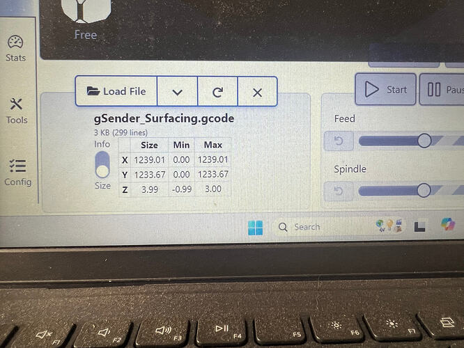

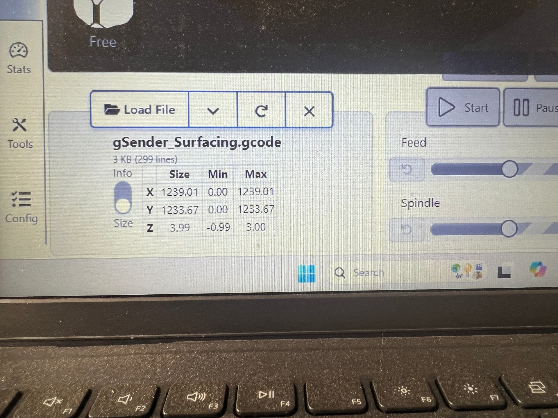

I am having problems with surfacing my spoil board using gsender 1.5.6. I have both the hard and soft stops disabled and the dimensions set up IAW both the directions and the video. When I start the program instead of coming to the front left of the machine it goes to the back left and starts cutting it cuts a few inches and then I get an error 10 E stop enabled. I have reset this several times and the last time it buried the bit all the way until it hit the collet nut. After I got the bit out of my spoil board I looked in the description of the file and it lists 3 for max cut depth even though surfacing tool has the max depth at .09. Every time I have tried to generate the g code t still doesn’t send the correct max depth.
Why am I getting the E stop alarms and why won’t the correct max depth be generated in the g code?
@LarryLSimmons Post a screenshot of the surfacing tab from gSender. I’ll look at it after dinner…

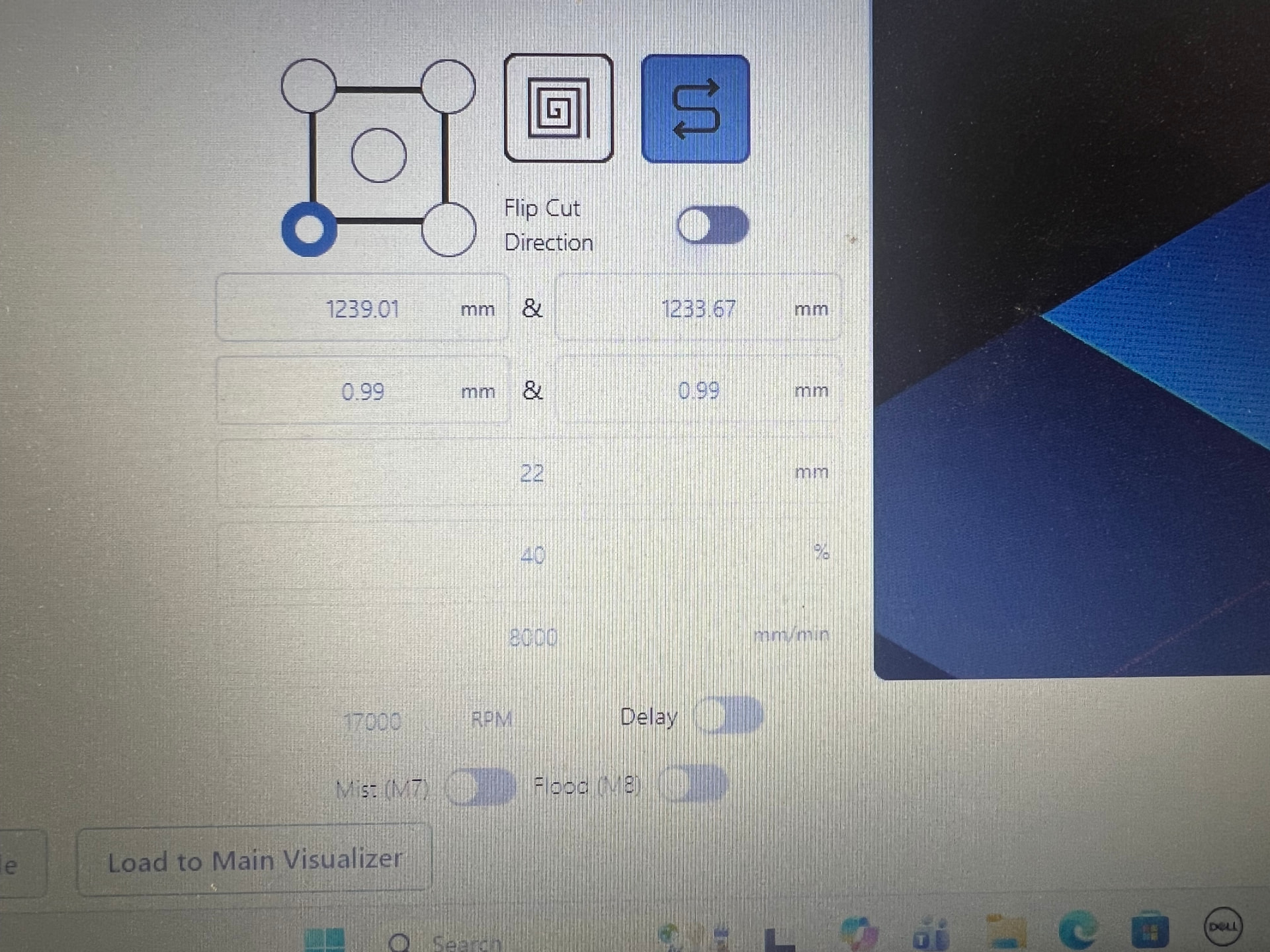

Here is a screenshot of the surfacing tab and the carve details.

@LarryLSimmons Oh, and your x/y max might be too large
From the manual:
X & Y: This is the max dimensions you wish to surface. These sizes will be determined by the size of your bit, and should only be used as a starting guide. If using a large surfacing bit, you may need to decrease the dimensions.
  • For 4×4 — 1245mm (49″) & 1220mm (48″)
Thanks for all the help. I do not know how I got those dimensions but they were really out to lunch. I also think I was setting X0 and Y0 incorrectly. I did notice that when I set Z up using the auto zero plate at .099mm it was still above the surface so I set it to 1 and it still was still not surfacing so I ended up setting Z using the paper method and it worked just fine. So, lessons learned LOL.
