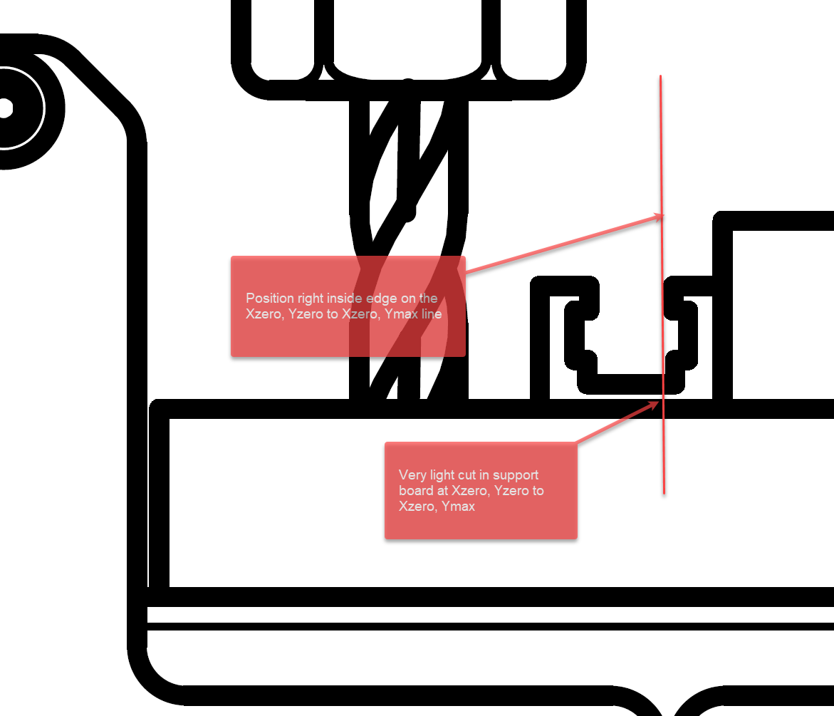

I think the first track will be the left most track. In that I will be using the EDGEHUGGER clamps, see [EdgeHugger™ Clamp Kit - Ultra-Low Profile CNC T-Track Workholding Syst – IDC Woodcraft](https://idcwoodcraft.com/products/edgehugger-four-clamp-kit-for-t-track-with-hex-screwdriver-toolquest-brand?_pos=5&_sid=187b58143&_ss=r#:~:text=A%20Gift%20Card-,EDGEHUGGER%E2%84%A2%20CLAMP%20KIT%20-%20ULTRA-LOW%20PROFILE%20CNC%20T-TRACK%20WORKHOLDING%20SYSTEM,-4.7%20based%20on) the right inside of the t-track will be placed on the left-most center position of the spindle.
 ![image](https://forum.sienci.com/uploads/default/original/2X/f/f5522a4509f02104689f74f19642511c561989c7.png)
This will be determined by installing a 15 degree V bit and making a very light vertical cut from Xzero, Yzero to Xzero, Ymax. I’ll follow up with pictures as I move forward.

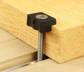

Note in the following image how close the bolt of the EDGEHUGGER is to the board being clamped down. This is why I wanted the right inside edge of the t-track to be on the left-most cutting edge of my spindle.
 ![image](https://forum.sienci.com/uploads/default/original/2X/6/6508e5ec71e7753d6f28542d312aea3a82ebef36.jpeg)

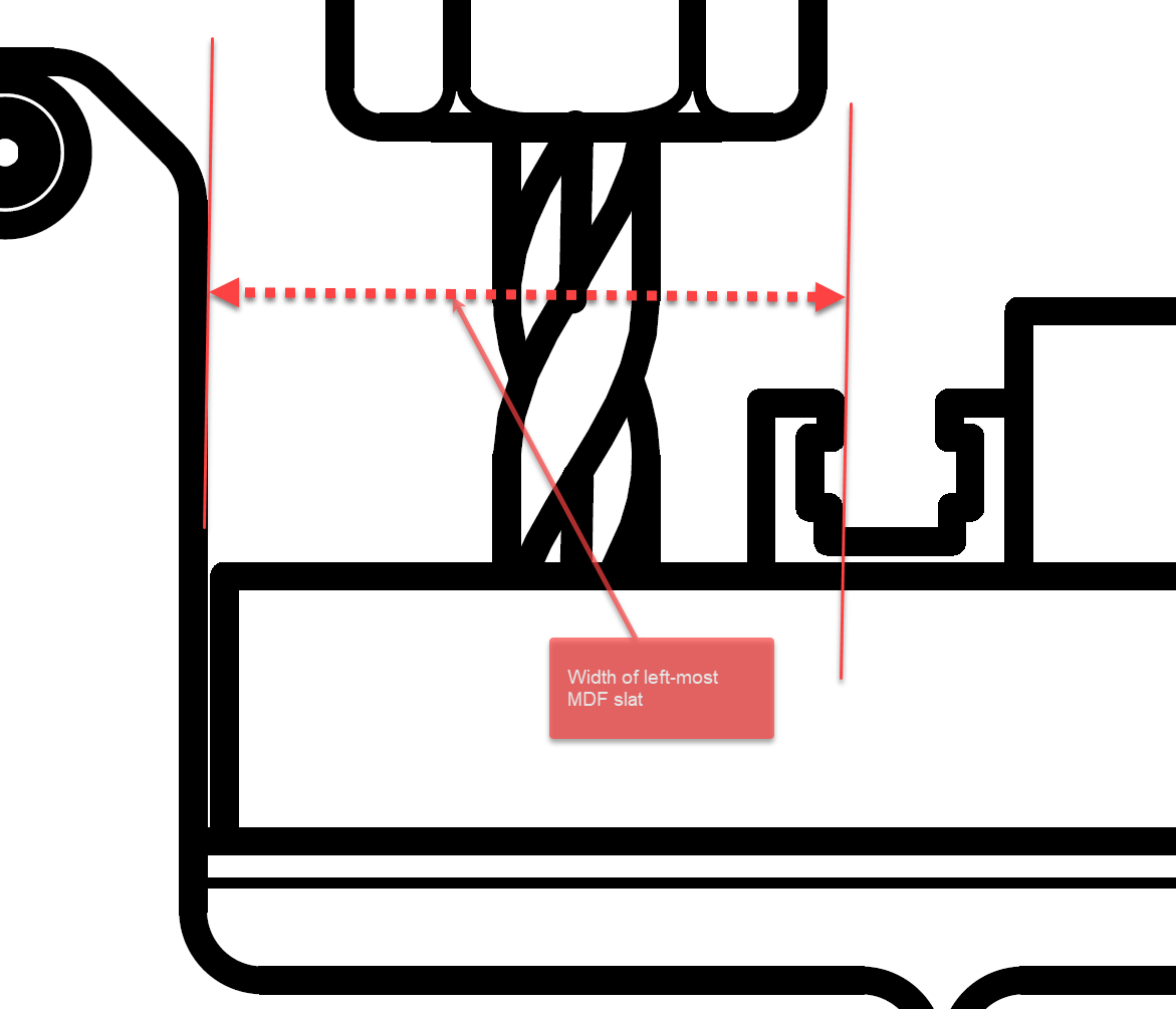

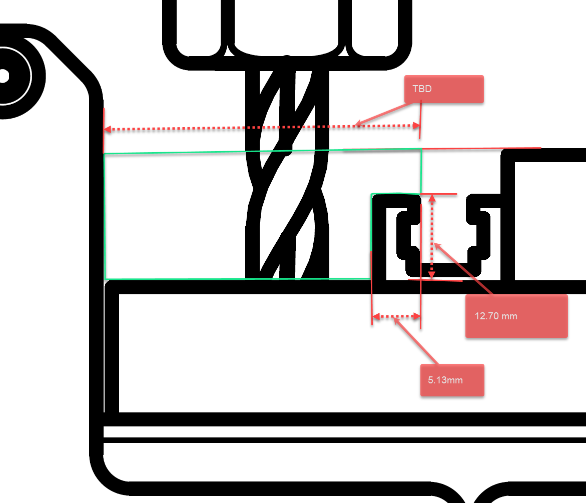

I’m now in the planning stage. After the first left-most t-track is installed, I will measure the distance between the inside of the left Altmill support to the left inside edge of the first t-track, as in the following image.
 ![image](https://forum.sienci.com/uploads/default/original/2X/c/c621f01f90ca7b3cd673e55d26d5e3e30c814b4f.png)

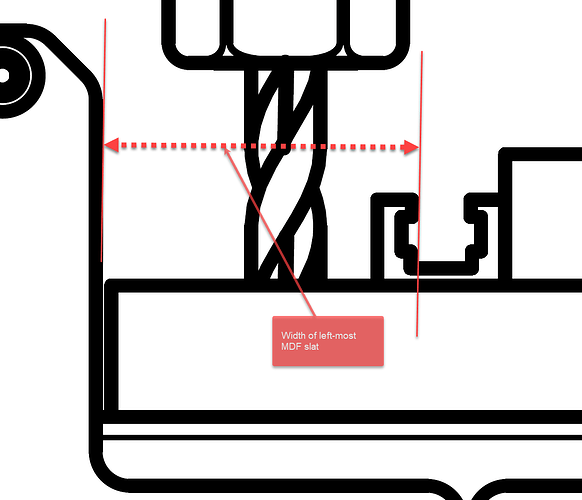

Shape of the left-most slat. Note your t-track may be different. I ordered my t-track from IDC Woodcraft , see [24", 36", and 48" Universal T-Track for Woodworking & CNC Router Clamp – IDC Woodcraft](https://idcwoodcraft.com/products/24-36-48-universal-t-track-for-woodworking-cnc-router-clamping?variant=51434876731679) I ordered from them because it is designed to fit both 1/4" and 5/16" bolts.
 ![image](https://forum.sienci.com/uploads/default/original/2X/8/832a3069da03f14669008002a6d996c647d31359.png)
