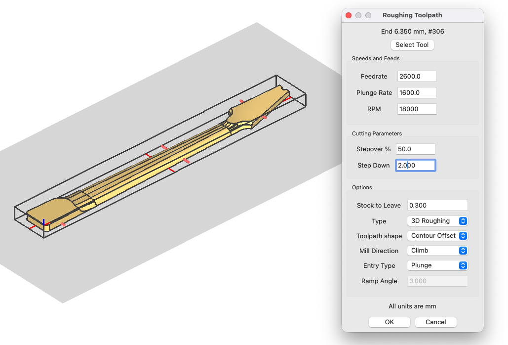

So I had a really tough carve on my AltMill 2x4 this weekend that totally went south probably due to bad feeds/speeds management on my part.
So here’s my question to the Community: What is your approach for carving super hard woods like hard maple and walnut when it comes to feeds/speeds and depth per pass?
I think I got greedy and set my depth per pass too high. I was using a 1/4 inch (6.35 mm) “Hog” bit from IDC Woodcraft for the rough carve, and was taking 2 mm per pass at about 2600 mmpm.
My stepover was only 50%, but like any carve there are moments where my CAM software had it doing its initial plunge with the full bit engaged and then making really long runs.
The wood was absolutely screaming and the chatter was ruinous in the end.
So in general when carving really hard wood, is it better to make shallow depth passes of like a millimeter or less, and if so can I still move the machine pretty briskly?
In other words, is it conventional wisdom that you opt for low depth/high speed for really dense materials?
Or should I just slow the hell down?
The carve was already over 2 hours with my settings (because I’m basically eating down through a 40 mm blank to end up with a neck that’s 20 mm at its thickest but has an angled headstock).

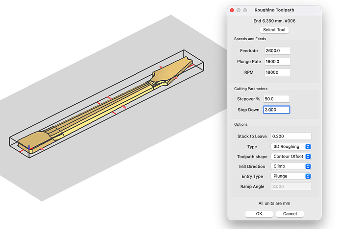

Thanks for the reply! To answer your questions:
1. Rhino 7 and MeshCAM v9.
2. Hard maple with a couple of strips of purple heart (10 mm thick). The blank was 915 mm x 115 mm x 40 mm
3. Feed at 2600 mmpm, plunge at 1600, and (probably where I went wrong), 2 mm depth.
4. Climb
5. The 3D Roughing toolpath in MeshCAM, with an estimated time to complete at about 2.5 hrs.
Thanks for the tip on the Hog vs. the Beast. I just broke my second Hog on the carve I mentioned (again, probably my fault). I’ll definitely check out the 1/4-inch Beast. I have the long 3/8-inch Slayer (Deep Slayer), which works great, but not always the best diameter for the workpiece I’m trying to carve.
From what you’re saying, it sounds like I was probably also running the spindle too high on my AltMill 2x4. I was running it at 18000. But I was only running at 2 mm depth per pass.
Here’s a screen shot….
 ![Screenshot 2026-04-19 at 7.14.43 PM](https://forum.sienci.com/uploads/default/original/2X/0/0513f5502f6e6da0dedcfeeb519975c8037f6374.png)

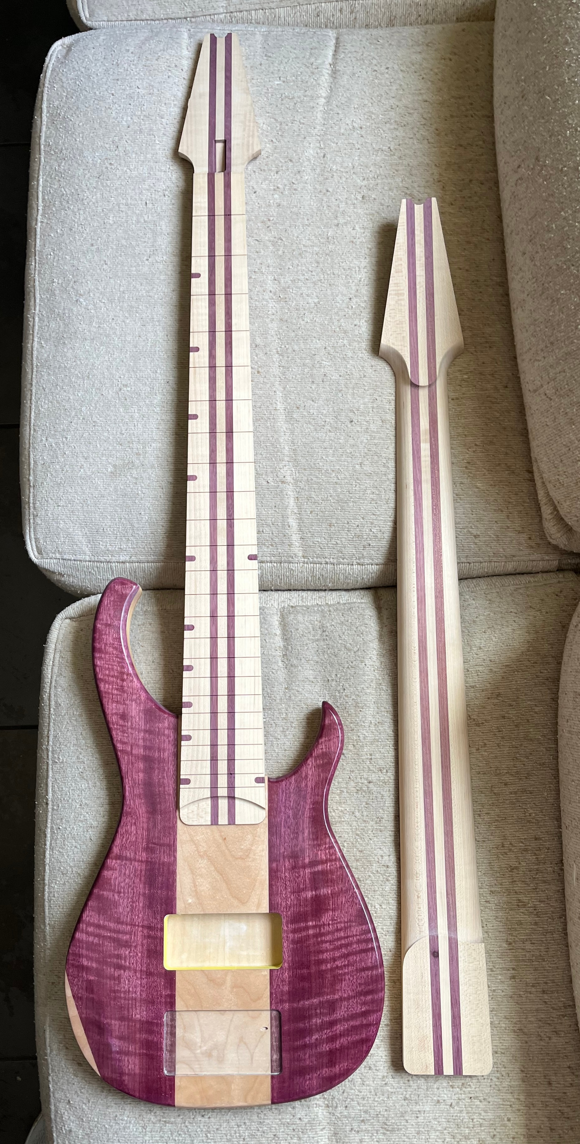

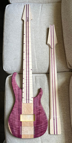

**Author:** ![The\_Unknown\_Bassist](https://forum.sienci.com/letter_avatar_proxy/v4/letter/t/977dab/32.png) [@The\_Unknown\_Bassist](https://forum.sienci.com/u/The_Unknown_Bassist)\
**Post date:** [April 22, 2026, 6:04pm UTC](https://forum.sienci.com/t/the-eternal-feeds-and-speeds-dilemma/26215/7 "2026-04-22T18:04:35Z")
Here’s a shot of the bass so far. Not really happy with how it’s turning out, to be honest. In particular, I’m a little disappointed in how brownish the purple heart on the body has turned due to the finish. I tried a product called Crystalac first, which made it really brown, then stripped all that off and tried a 2k poly.
The neck on the right is the one I’m discussing in this thread. I was able to salvage it and sand out all of the chatter marks, but in doing so I had to remove too much wood for the neck to fit snugly in the neck pocket. The neck sitting in the bass now was the first one I did, but I’m not happy with the how the glue seam between the neck shaft and fretboard turned out.
 ![IMG_6769](https://forum.sienci.com/uploads/default/original/2X/3/3d911ffaa9d27cf71b6a7ceb8cf34bc3d05a8f11.jpeg)

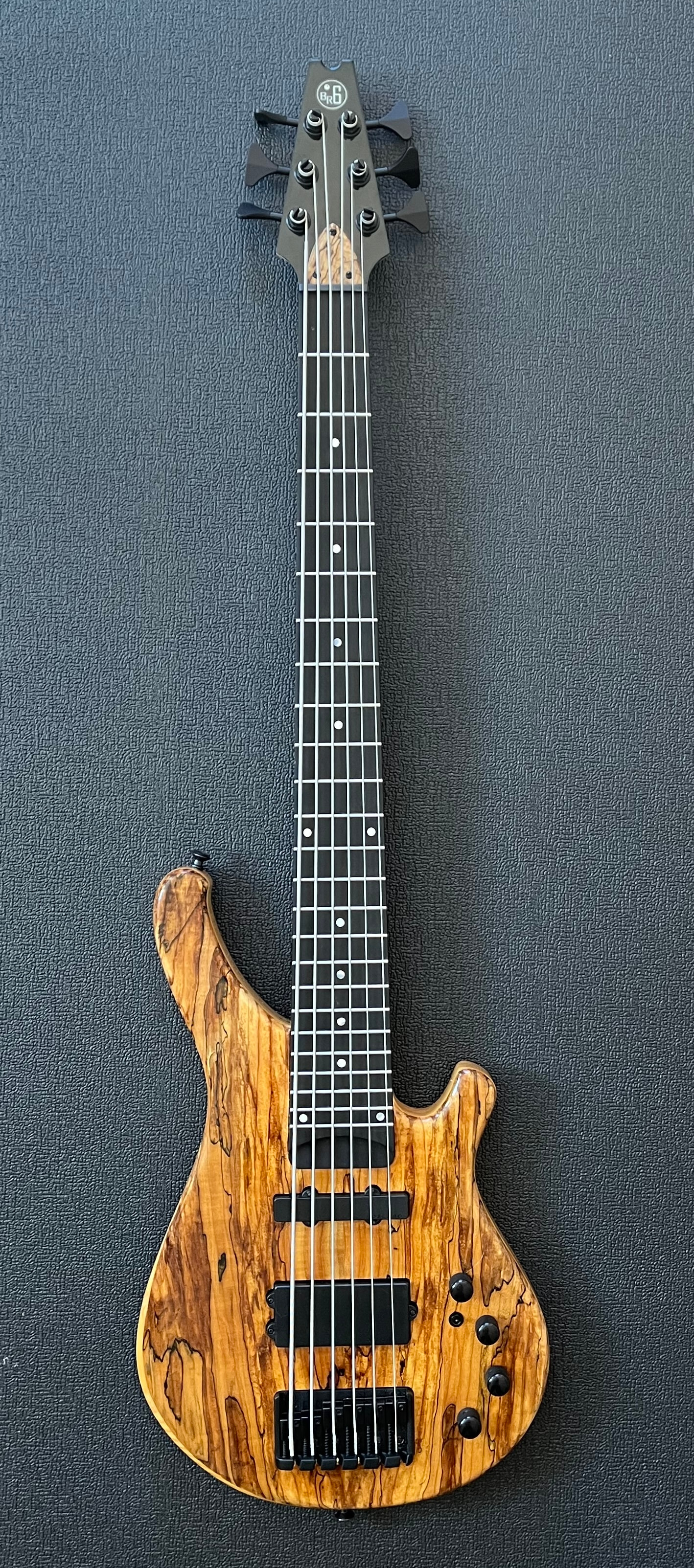

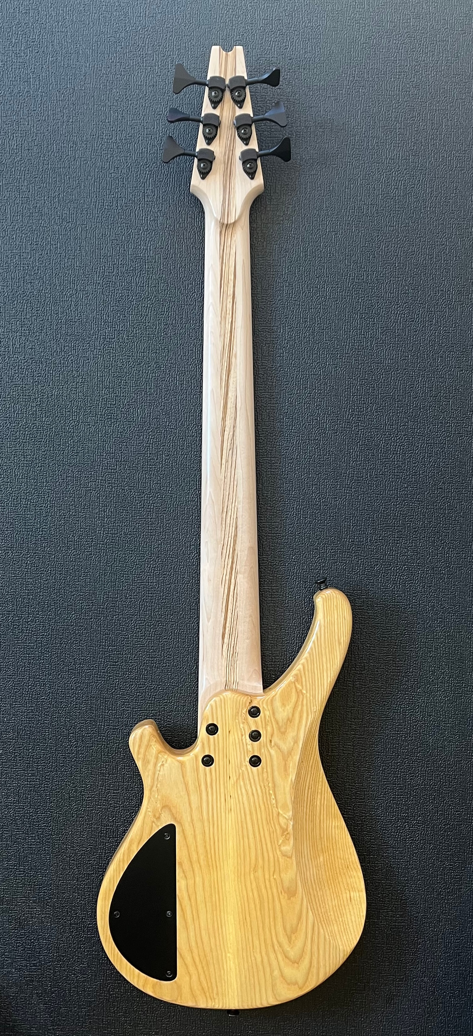

Here’s the first full instrument I’ve built so far. It’s a 6-string bass that I built for my nephew, who’s an excellent bassist. Frankly, it plays great. Maybe the best bass I’ve ever played. And the reason for that is not because I happened to build it; it’s because I was able to design it so that it’s optimized for the way I play, personally. Even something as simple as pickup placement makes a huge difference, but a lot of manufacturers have to design their instruments to accommodate a wide range of styles. The great thing – the best thing – about building your own is that you get to design it specifically for your own playing style, and how you use your hands and fingers, the kind of tone your style produces, etc.

**Author:** ![mick\_s](https://forum.sienci.com/user_avatar/forum.sienci.com/mick_s/32/9655_2.png) [@mick\_s](https://forum.sienci.com/u/mick_s)\
**Post date:** [April 23, 2026, 3:01pm UTC](https://forum.sienci.com/t/the-eternal-feeds-and-speeds-dilemma/26215/16 "2026-04-23T15:01:12Z")
In a nutshell, if you hear the tool squealing, either reduce the rpm or increase the feed rate. If you hear or see chatter, reduce the feed rate or increase the rpm.
Like I said above, the posted feeds and speeds are just a starting point. When I was training new users in industry, I gave them a new compression bit and asked them to increase the feed rate until they broke the bit or stalled the spindle, then note the feed rate and back off 10-20 % to get the proper chipload.
Most new users want to cut slow at high rpm. The opposite is a better approach.
**Post date:** [April 23, 2026, 4:08pm UTC](https://forum.sienci.com/t/the-eternal-feeds-and-speeds-dilemma/26215/17 "2026-04-23T16:08:46Z")
Beautiful instrument! Very nice job!
