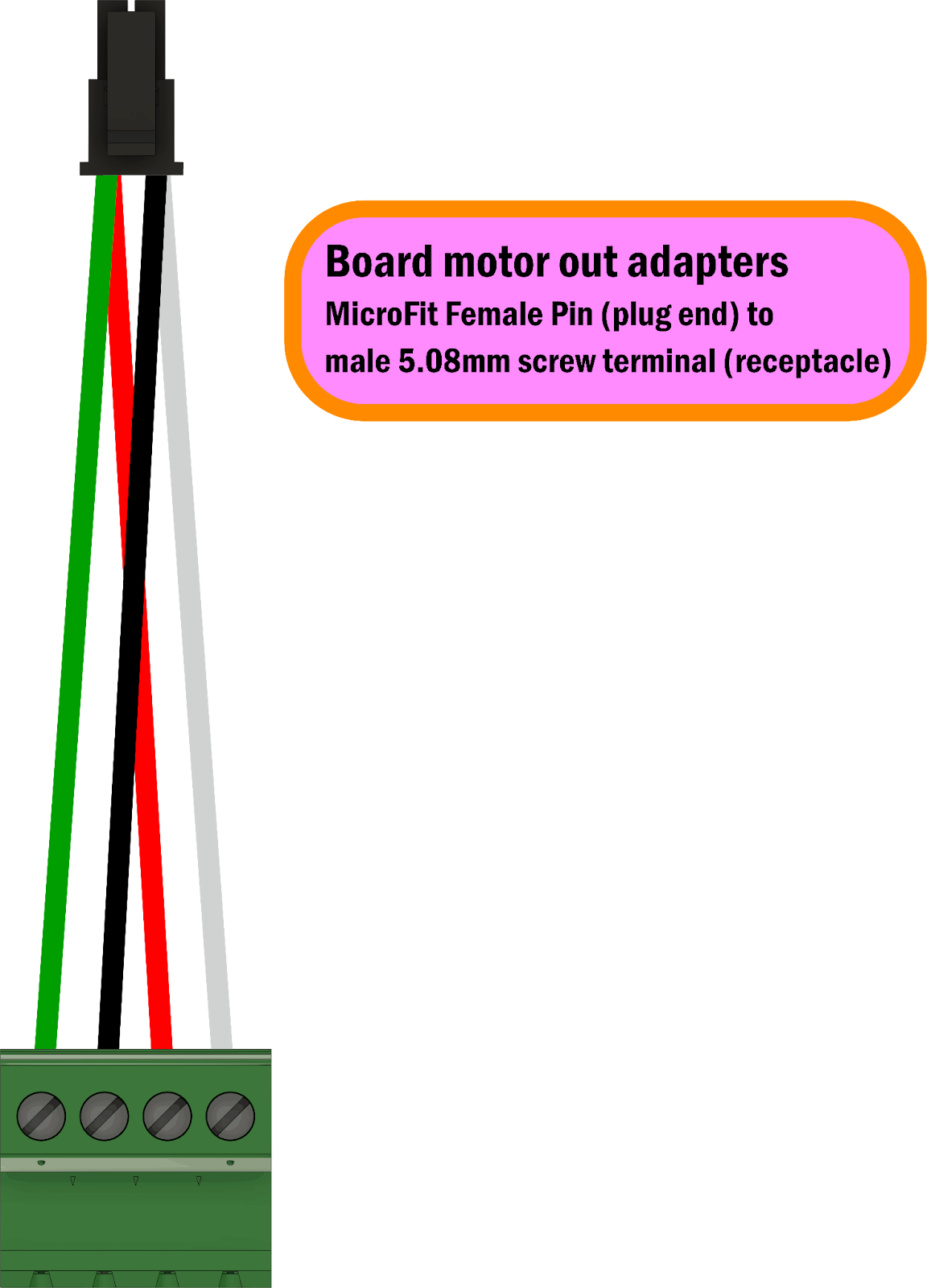

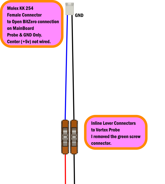

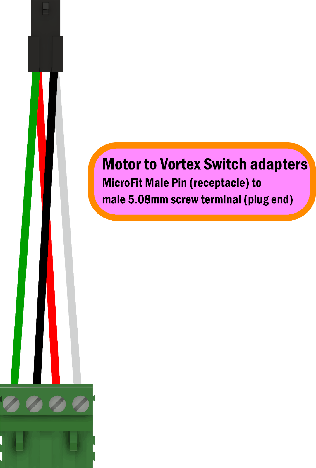

The vortex comes with a switch that allows switching from Y to A for rotary jobs, but it simply disconnects the Y motors and connects the rotary (A) motor to the controller. This should only be switched when power is off, by the way. I knew that would not be enough on the Shapeoko Pro (or 3 or 4 or probably HDM and 5) because of the belts. This just leaves the Y free to move. I thought about shorting the Y coils when the switch is flipped to A, but that holding resistance is too weak to do much. I next toyed with using multiple relays to connect the Y motors to a separate controller that would simply put the Y steppers into a hold state. I finally settled on just clamping the thing in place, guessing that I was overthinking the whole thing (I tend to do that sometimes)…more on this later.

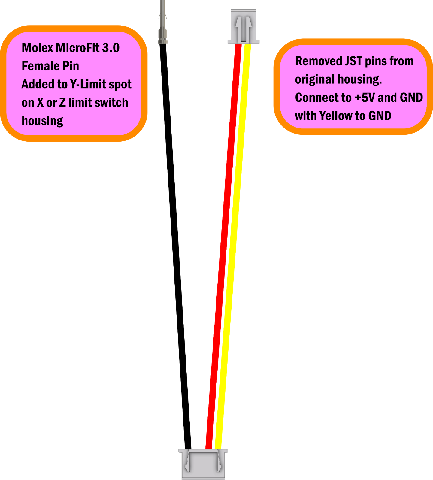

My next mission was to handle the wiring…ugh…the variety of connectors. Luckily, I teach electronics, so I had some connectors and tools on hand. After an Amazon and a DigiKey order I was able to make the necessary adapters.
![](https://lh7-us.googleusercontent.com/UJfMcDOiZaF5naQakaPwbeJa41kG4AfmaNYfd1SA1yYlXWdcxXPB4iqrDRJSUstModDfCGEI5wKggylOWsTqRTAP23eAzl-2m9h0lT9NNjz-e6VaiRXI3-uaAiboPTHVImssALZPYChqiZdRn-Qs5kw) ![](https://lh7-us.googleusercontent.com/1HnrqtLLDTkrlOcHjlgH-yBOzwv_vEayLHu2g1np5hWgKsVOekhsqhAFfRO3tJPdC6RHYYdluJfmdkvSPSwtmlc6xM5Hgo_srtqrNaQ9X8D_YeFJug7EAHwkLpomPGFGIV_eYQn1jELxgy8nYn1xuts) ![](https://lh7-us.googleusercontent.com/28AzMYaRcCAlpIuUKT553BcU4-U8WPLuqAMvRx-l1UYPd-T1caou_b005mmmfoLKgsigicV580Kag2LOyVFRkNXoBcWED8bf1j3-UY7cOsvChGKmUziTDaScyk00n6b-LJQ84XpSmLIJgCUqZ0QZgDo) ![](https://lh7-us.googleusercontent.com/h6fe6rD_JZM0imMYiK80dXiwQL3dwoe6JCjqEvXD1YRTWwldQaHfSWQNKWXSpWMIQG2XHxjIqFsTXqDTmkFvN4x9k3AYUFjnD3dY46CctywSoNURHIfq7kFCSoqVg6GEMgCQsvEb5MpTLSqX0OnQdCM)

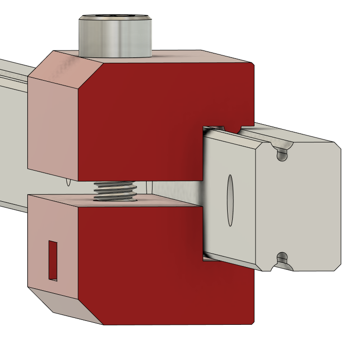

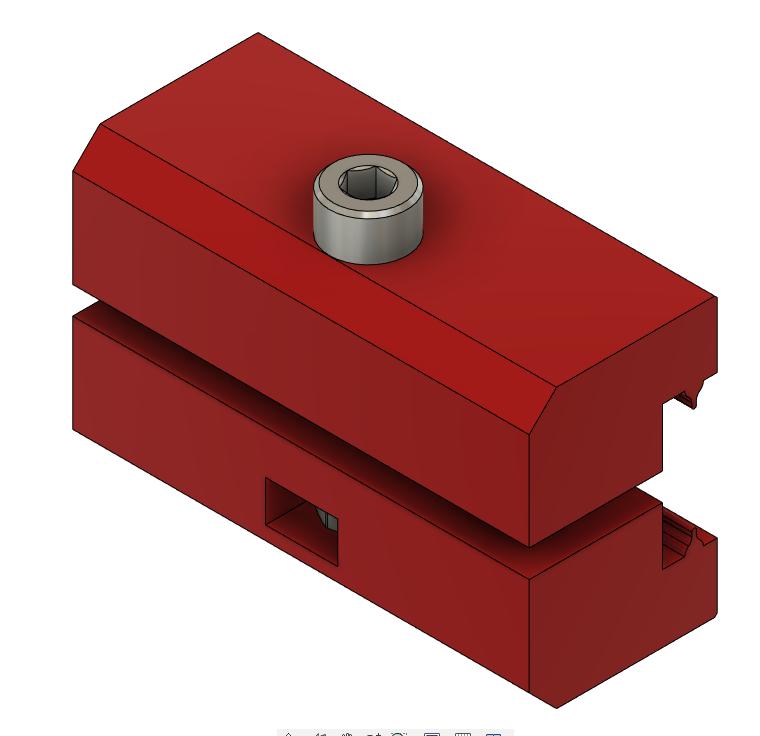

After I got these adapters made, I thought I’d just mount the thing, clamp the Y and go. But, how do I mount the thing? Well, gSender has a built-in gcode generator for mounting the Vortex (They use ¼-20 threaded inserts). There’s a problem though, because I don’t have a Longmill…I have a beast of a machine called the Shapeoko Pro. Not to worry, I used [their open source files](https://cad.onshape.com/documents/ae39a5fcc77f3d9fd98c1651/w/0565761952616ac0420258c4/e/45038dcaaaafbe48b1cc0005) to generate gcode for the mounting holes that would fit on the MDF slats on the Pro. I generated some counterbores and tapered bores to match the taper of the threaded inserts. I also set my Y-Zero in Fusion to be on the centerline between the two left holes. That way, I could decide where the Vortex fit the best, zero Y there, and hit the slats exactly as planned. gSender also generates gcode for hole pairs, but I’m comfortable with my Fusion workflow so I went with that.
![](https://lh7-us.googleusercontent.com/FQktC7NE5V2fPZ2APD_vd941hJTFS-9-2pBuixyzdr5T1HkjQ6pEWvrMZmK7paYRrsjt1a03XOg4lSEwBL5wO7utfkZQSKRn0G7Ai8qDYvjyph99-0UCQ8a8WTOyda-m-v55f9r_eBhraqsWx3yzBLw)
Great…easy. Now I just have to clamp it and go! I tried every which way to clamp the Y-axis on the SOPro, and I could not find a consistent method that prevented the Y from moving. After way too long, I finally came up with little 3D printed linear rail clamps. They clamp on the Y-rails in front and back of each Y-plate. I made a split clamp design, so I don’t have to slide them on from the front and rear of the machine. That’d be obnoxious on an XXL. Here’s what those look like:
![](https://lh7-us.googleusercontent.com/2ozzywOPjYDiyaoY8o413-YCZGbZyzBRl9rRihPHLqEKj5G9af1oe1N8JGRfQBU6BWcH-7YNVR62pz7n4FG-AtOXIOzcq9i1W3_j8y3OPQ34JMCr09hCg0QVV5fRUrtH_BLv9SZZFIlQVgcl_bo4as8) ![](https://lh7-us.googleusercontent.com/7qJZl4lVCwEFVhqswHIATqSvVdEKUgn9rMTkHCwEaGlC1Pzr_I6oOzU0po5GVgxB0gQB7VRWg-nnMWziZxtVKAJ0oSqCUcQ-YgqABFT2IVFnxMmBK3qeC2uOSRHY_mguZC_hyQTrv2ndGjWUjXlJMOk)
Once that problem was solved, I was ready to go.

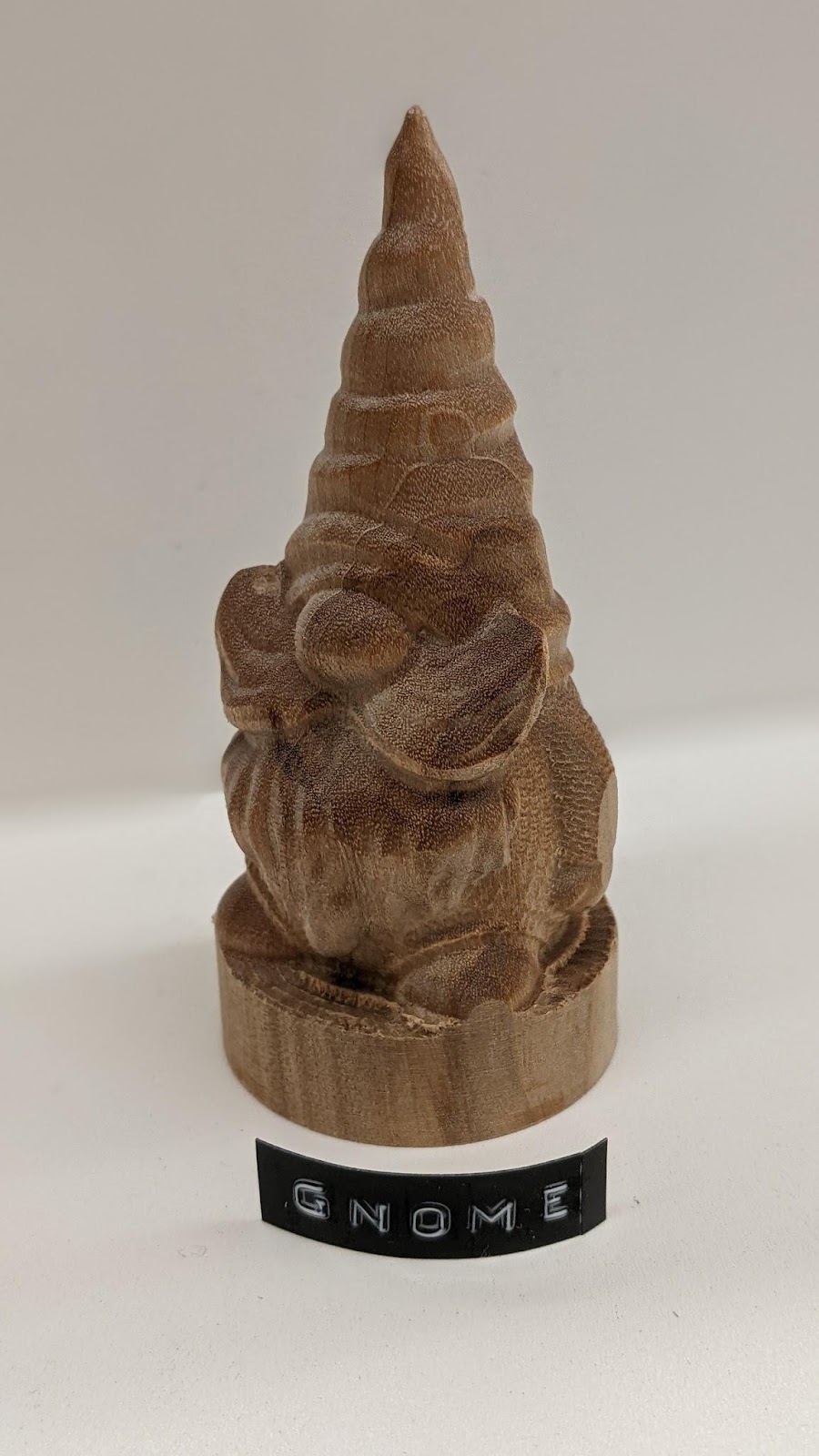

I downloaded a [gnome stl by Body3D on Printables](https://www.printables.com/model/342049-gnome-supportless). I used V-carve Pro (v 9.5) and a custom post processor to generate the gCode. I used a flat ⅛” tool for the roughing, and a tapered ball (0.5mm tip) for the finish. I rarely do 3D reliefs, so I was impressed with the results.
Sorry for the long post! This was a fun project to get working, and it’s so cool when things just work! Not sure of my next rotary project, though a custom tap handle sounds like an obvious one.

Here are the STLs for the MGN15 rail clamps.
[Y-Clamp\_B.stl](https://forum.sienci.com/uploads/short-url/jgxNEMELy4j1EvjsYU6Mx63TIUm.stl) (864.6 KB)
[Y-Clamp\_A.stl](https://forum.sienci.com/uploads/short-url/c3eC3FMbLX9Iv8dJPmeXOSI2rVc.stl) (854.9 KB)
You’ll need 4 of each.
You’ll also need M5 screws and nuts. I think I used 35mm SHCS, but anything over 30mm should work.
