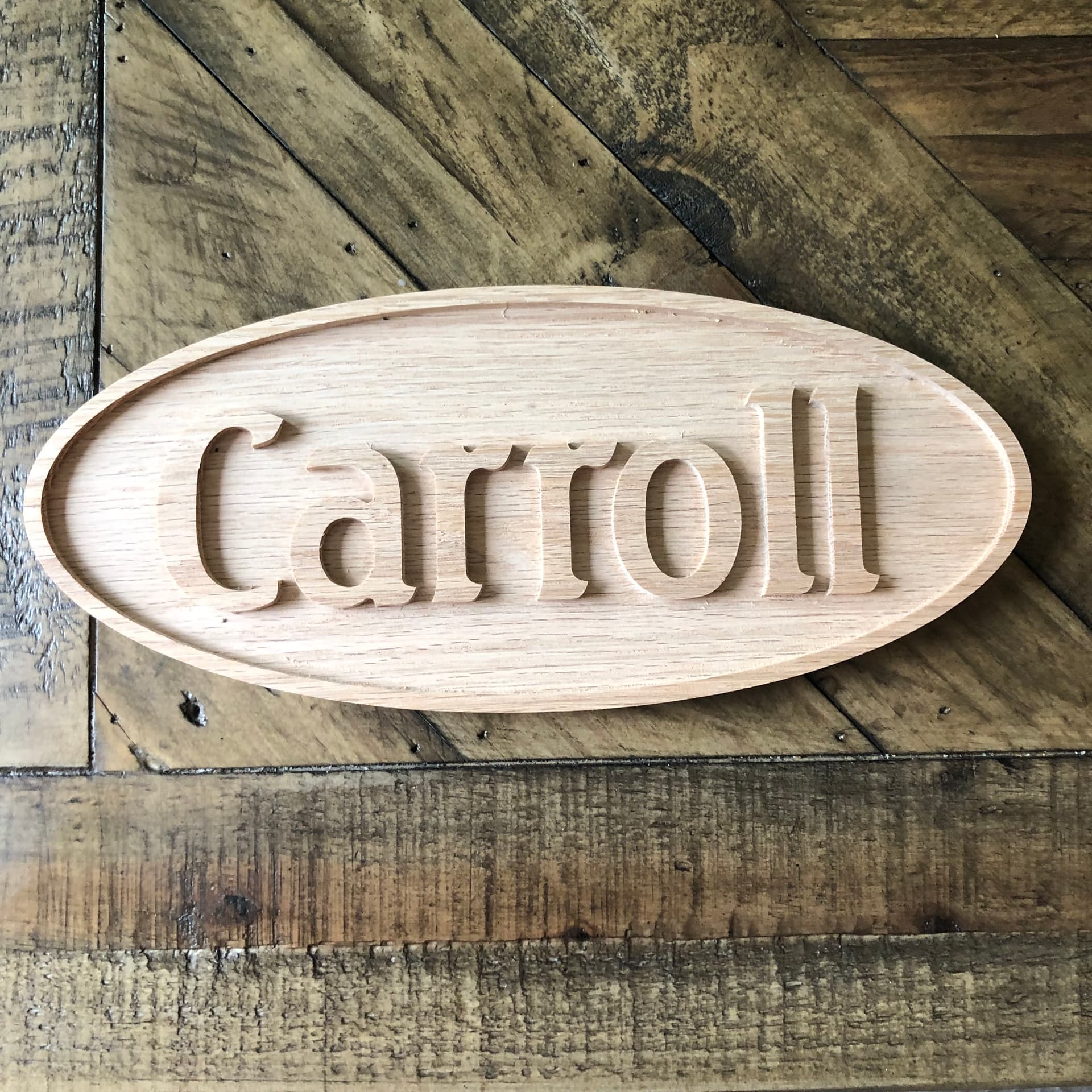

I use Carveco - the cheapest one and it creates the tool path for each size bit.
For instance starting out with a 1/4" bit to rough out then switching to a 1/8 and then a 1/16 etc. After the roughing pass is finished the machine goes to the safe Z and your set X0 Y0. You load your next bit, reset Z with the probe, load and run the next file (which is the next tool path). When the tool paths are created they are automatically
 ![IMG_0504](https://forum.sienci.com/uploads/default/original/2X/b/b379da5bb644eeecd186e36ac8053abefcf9703b.jpeg)
numbered eg. Oval cuttingboard1, Oval cuttingbard2. Ive been running this setup for about 6 months and love it.
