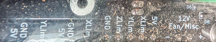

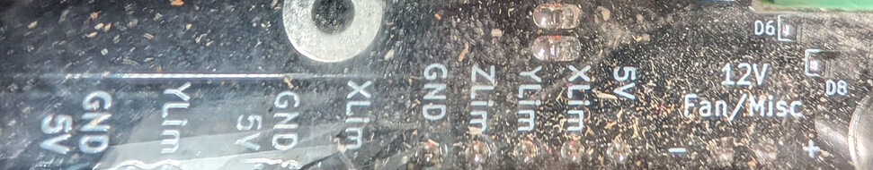

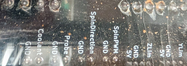

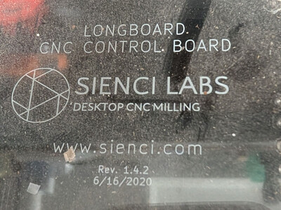

My longboard version and connectors list: (Sorry, not clean!)
 ![image](https://forum.sienci.com/uploads/default/original/2X/3/3050692c57d1189cc41168c327f71fe7f05b8f60.jpeg)
 ![image](https://forum.sienci.com/uploads/default/original/2X/7/750b9bae02cf14c0960ac5b124b4255dccc25dc0.jpeg)
 ![image](https://forum.sienci.com/uploads/default/original/2X/9/9e92735f81589f8222b1c03d4ac563e19efd1ee6.jpeg)
**Post date:** [June 19, 2026, 4:33am UTC](https://forum.sienci.com/t/tool-length-sensor-tls-position-on-longmill-mk1-12x30/26597/4 "2026-06-19T04:33:06Z")
Ok, I will take a guess at this but you really should send a quick email to Sienci …
The TLS will have 3 wires:
ground to your ground
probe wire to (drum roll) probe
and the last wire to 5V
Of course that doesn’t help when I can’t tell you which wires on the probe are which and Sienci can advise you.

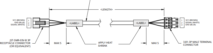

**Post date:** [June 19, 2026, 12:31pm UTC](https://forum.sienci.com/t/tool-length-sensor-tls-position-on-longmill-mk1-12x30/26597/5 "2026-06-19T12:31:32Z")
Double check with support, but the wires are labelled on the tech documents in resources:
 ![image](https://forum.sienci.com/uploads/default/original/2X/0/08ecfd4724b152ca04613a25cb5848cbf70ed69b.png)
> **[Tool Length Sensor - Add-ons](https://resources.sienci.com/view/addons-tls/#3rd-party-compatibility)**
> For video instructions on how to mount and set up your tool length sensor (TLS), see the video below. | Setting up and using the TLS.
It’d be ground + signal (2 + 3) to the board and the remaining to external power.
Support should have more in-depth instructions for the longboard, so do email them regardless.

Just got an answer from Sienci Support
They state: (verbatim)
> It has to have the SLB not the LB.
The website state it work with all Longmills even the MK1. What it does not say is that you will need a Super longboard.
I’m speechless…
